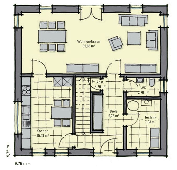

Why make it more complicated than necessary by not choosing a standard floor plan? There are usually plenty of variations available. With a smaller living area, you could even find a layout that includes a small office on the ground floor. As an example, I’m sharing a floor plan here...
The staircase is straight, just as requested

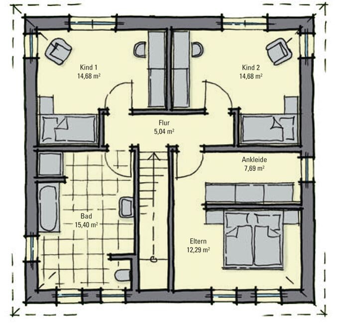

Floor plan of a house with kitchen, living/dining area, hallway, WC, storage room, and utility room.
Floor plan of a house: hallway leading to master bedroom, child 1, child 2, bathroom, and dressing room.
