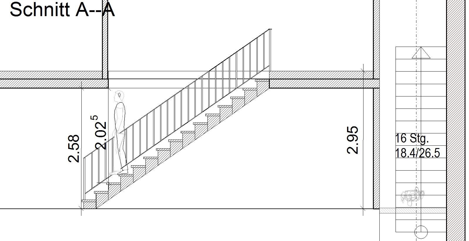

Also, you overlap three steps, meaning that at the third step you no longer have a ceiling height of 275 cm (108 inches) but only 221 cm (87 inches). This is especially a head injury risk when coming down the stairs. Just to clarify what we’re talking about:
Although these are different measurements, please note the person descending.
