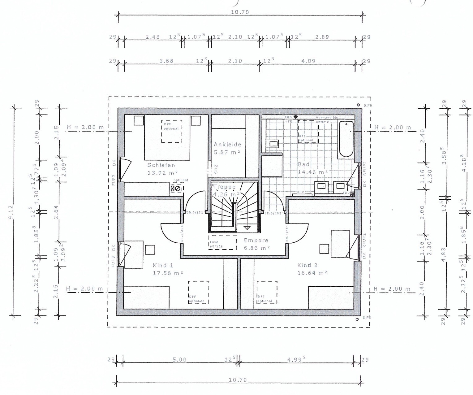

Drasleona23 Apr 2020 18:58Unfortunately, my software doesn’t support creating views... The base model is the Solitaire 165, but only various designs (including extensions) are available on the website. We have also increased the height and width by 30cm (12 inches) each. The roof pitch will be 20 degrees.
The eaves sides are shown at the top and bottom of the plan. However, in our design, we raised the knee wall to 2.06m (6 ft 9 in). I probably should have mentioned that earlier, sorry.
P.S.: Attached are the original floor plans
