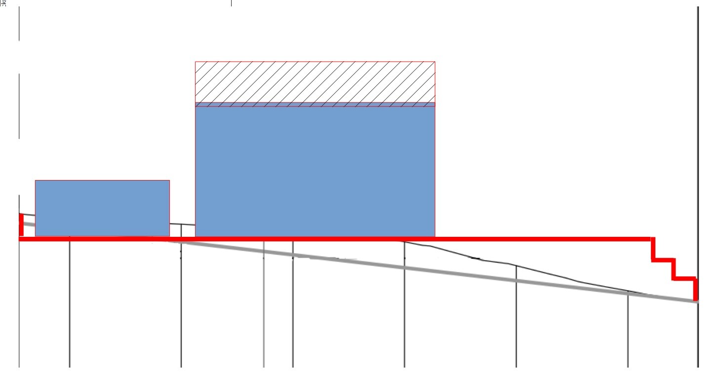

Drasleona24 Apr 2020 17:22On page 7 #39, I uploaded the site plan of the house. As I understand it, the section line runs from northeast to southwest, basically right along the ridge we have planned.
Maybe this helps you to better visualize it?

But wouldn’t a basement still be extremely expensive?Expensive despite what? “Extremely” no, basically it’s easy to estimate: a basement basically means a double foundation slab with walls standing between at vertical distance. Exterior walls on the valley side require retaining walls if there’s no basement, which is roughly the same cost there. The exterior walls on the uphill side are added, as well as load-bearing interior walls. In return, the above-ground technical and storage rooms are eliminated. So effectively you end up paying more than half the cost of a basement if you choose not to build one — better to build a full basement and get it included.

We don’t want to keep the slope in the house area, so we wouldn’t need retaining walls or exterior walls in contact with the soil. Currently, 45,000.00 euros are budgeted for the groundwork and excavation. I’m very worried that this won’t be enough. The cost range for excavation work seems to be endless. However, I can’t imagine having a sloped property in the long term. You can’t really use a slanted garden properly either. That’s why our idea is to level the ground as much as possible and let the remaining slope in the southwest “fade out.”
Do you think my plan to level it is naive?
Drasleona schrieb:
We don’t want to keep the slope in the house area, so we wouldn’t need retaining walls or exterior walls in contact with the soil. [...] Our idea is to level it as much as possible and let the remaining slope in the southwest “fade out.”
Do you think my plan to level the slope is naive? Probably, if I understood it at all. I think I follow it about as little as you follow your slope.
Drasleona schrieb:
I also can’t imagine having a sloped plot in the long term. And you think it’s enough if Bibi Blocksberg simply says “hex, hex!”?
The slope is there. You can either accept it or terrace it, the latter usually being more expensive (so it costs more money, and you also pay with less aesthetic appeal).
Drasleona24 Apr 2020 21:41So, I’ve tried to incorporate this into the cross-section as I imagine it. Two versions: one stepped and one sloping. On the left side, one meter (3.3 feet) of height is cut into the ground, and on the right side, up to one meter (3.3 feet) is filled in (although the current terrain profile isn’t entirely accurate here. There is already a retaining wall about 50 centimeters (20 inches) high, so only about 50 centimeters (20 inches) more need to be filled to reach a total of one meter (3.3 feet)).
