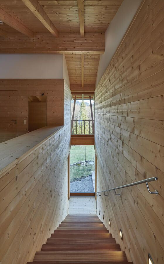

Thanks for the draft, it looks pretty good! So you don’t think the light source would be too far away?I believe a large window there would bring you significantly more light than a frosted glass door. You would just have to see how to integrate it nicely into the facade. Otherwise, you could also add that corner to your son’s room. Or create a small WC niche. But the bathroom and the room are already quite spacious anyway.A skylight behind the staircase is also possible and would bring in a lot of light, although I’m not sure about the exact orientation right now. It’s also important to consider the design of the railing—if it is a half wall or even an open railing, the light will be well distributed.

@hausnrplus25 Roof windows are of course the first idea, but that would mean losing the attic space, and it would probably be incredibly expensive since both the ceiling and the roof would need to be opened up.
I would definitely want to put a railing in the hallway, as open as possible, maybe even glass.
