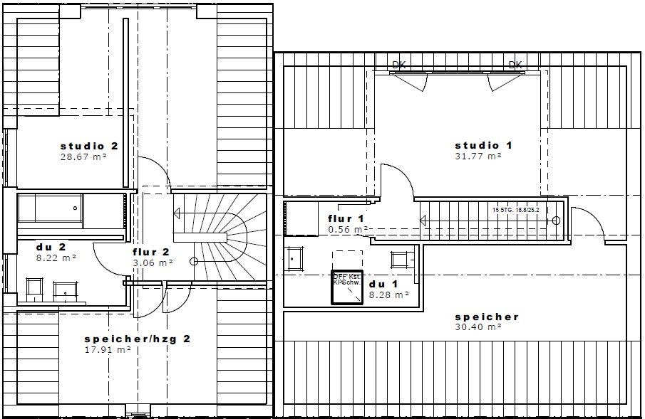

So, here is the complete version. It should be noted that this is still the design phase, so some parts have been put together quickly, and the exterior views for House 2 (for sale) are not yet final.
In the upstairs bathroom of House 1 (north half), there will be a storage nook on the right side of the plan, and the shower will be moved next to the door. Access to the storage nook will be between the bathtub and the shower, where a washer/dryer stack and shelves for towels, cleaning supplies, toilet paper, etc. will be placed.
The dining table on the ground floor is not yet properly sized; it will be a table for 8–10 people. We will probably prepare for a fireplace connection, which would be positioned slightly elevated on the split-level steps between the dining area and seating corner.
MadameP schrieb:
Yes, I noticed that too. I was thinking of shifting the wall between the kids’ rooms slightly to the right according to the plan,I would leave it as is. Some rooms simply have only about 2.40m (7 ft 10 in)... in this case a bit more. Maybe it will become an office?!
kaho674 schrieb:
The wastewater drainage in the attic would worry me. Does it run through the bedroom? I would consider swapping the heating and the second shower.I wouldn’t see that as a problem either. The alternative with the swap is not ideal since the sloped ceilings get in the way.
It’s all one family living in the house, so I wouldn’t worry too much about noise issues.
What I would improve if it were mine: I would place the tall kitchen cabinets where the terrace door is, aiming for an L-shaped kitchen. Then move the island to the center wall of the house, so further to the right according to the plan. Where the island was attached before, put the terrace door. So everything would rotate within this triangle. The terrace door where it is now only causes issues when it’s open.

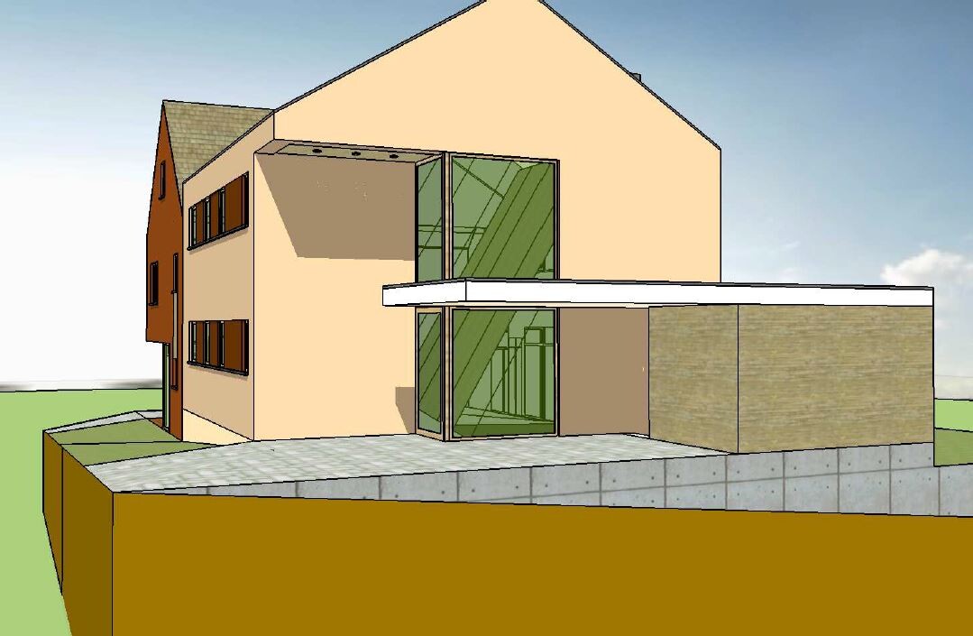

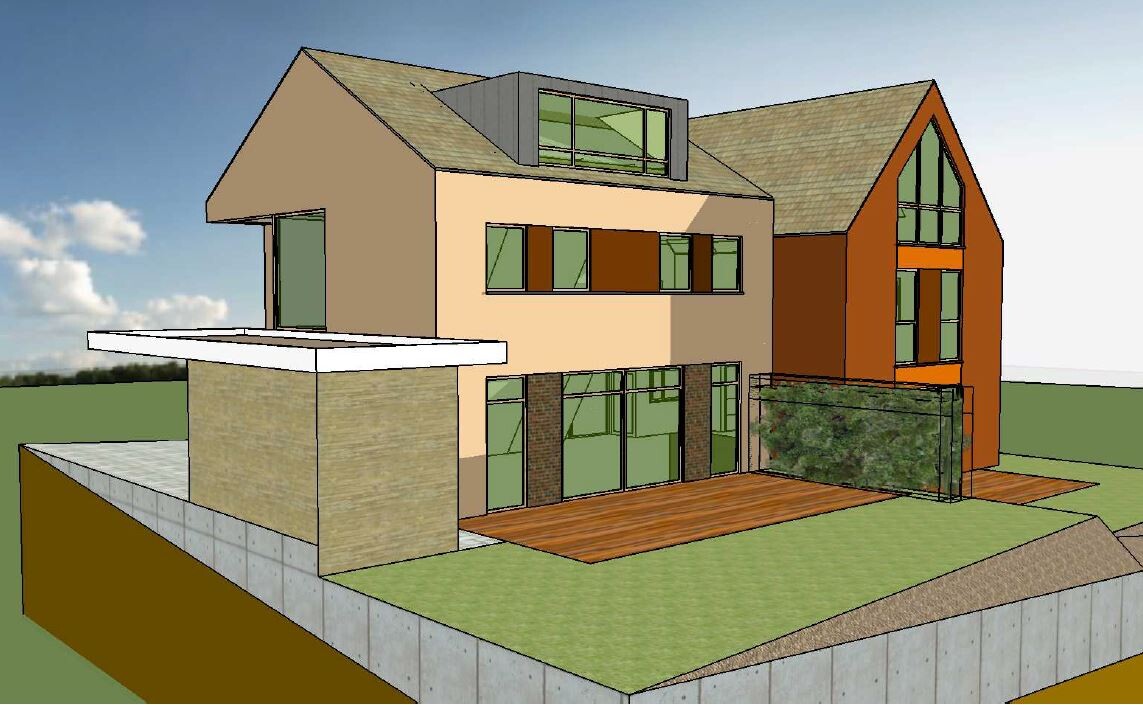

Here are the preliminary views "quickly done," meaning some of the windows are not entirely accurate and with the following changes:
The carport for House 1 (light) will be applied for, but we probably won’t build it at first. I don’t like it... The storage room might be made slightly larger instead. The front door will definitely not be glass, as incorrectly shown here.
House 2 (dark) will not have a garage, but a storage room instead, possibly with a carport. It fits better there.
That is why there are windows and a patio door from the kitchen on that side at ground floor level.
If it were mine, here’s what I would improve: I would place the kitchen’s tall cabinets where the patio door currently is, aiming for an L-shaped kitchen. Then position the island along the house’s central wall, so more to the right of the plan. Where the island was previously attached would become the patio door. So everything rotates around this triangle. The patio door in its current place only gets in the way when open.Are you referring to the southern half? I ask because I just posted the complete project. I need to think it through, but it sounds good at first.
I’m still not happy with having the kitchen in the northern half; I doubt I can fit everything I want there.
