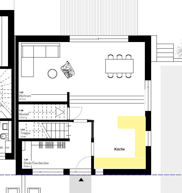

Preface: The larger half on the north side (right on the plan) is intended for personal use. The smaller "half" on the south side (left on the plan) is for sale. For the sales half, the only requirement was a practical use of space for 3, max. 4 people. Therefore, I will go into more detail regarding the personal half.

Personal half:
- Split level to the living area, creating high ceilings in the open living space and making use of the topography
- large wardrobe/coat area
- storage space utilized under the staircase
- utility room on the first floor
- large children’s room (intended to be swapped with the attic studio when the child is older)
Sales half:
What do you dislike? Why?
Personal half:
- Utility room only accessible from outside (wtf?!)
- Open living space rather small
- Kitchen is small, no island, dining area only for 6 people
- Guest WC wastes space
- Overall few and small windows
- Family bathroom layout: shower exit directly in front of the door, toilet right next to the sink
- No dressing room
- Attic bathroom: again, shower exit directly in front of the door
- Attic studio windows: tiny arrow slit window facing west (the side with the really great view) and two roof windows. (my next wtf moment)
Sales half:
- No second shower bathroom
- First floor bathroom tiny, no shower
- Boring floor plan
- Second room in attic without a window?! (again a wtf moment)
Price estimate according to planner: just within budget (prefer not to discuss figures publicly due to sales plans, thanks for understanding)

Why is the design as it currently is?
Our requirements regarding the space program were largely implemented.
Which requests did the architect fulfill?
Offset in height and depth between the two halves, staircase not opening off the living room, utility room on the first floor
What do you consider especially good or bad?
The arrangement, location and size of the windows raise major questions for me.
Furthermore, I don’t understand why the plot width isn’t fully used. We are fine with 3.50 m (11.5 ft) on the sides for parking. For the sales half, we’d leave 3 m (10 ft) to preserve garden space at the back. The very first study was even more “tube-shaped,” and we already pointed that out. Now the northern half still has 4.12 m (13.5 ft) and the southern 3.93 m (13 ft) width on the sides. Why?? Dead space next to the cars that we won’t use, instead of garden space facing west.
What can we do better?

Mottenhausen8 Nov 2018 00:01I already mentioned on page 2 that I don’t like the design. The longer I think about it, however, the more I want to see the practical implementation. I keep thinking of historic Nordic port cities with their narrow warehouse buildings along old quay lines. Somehow, it has a certain charm.
I believe the project in its current form has the potential to fall into one of two extremes after completion: “WOW, that’s amazing” or “oh my goodness…” I’m torn about which outcome is more likely.
Why have a shower on the ground floor if there’s the backup shower in the attic? True, I had completely forgotten about that.

In my opinion, not much of this remains. Apparently, there was a complete budget miscalculation. The basement was removed. Thanks to the utility room on the ground floor, the staircase, and the not-so-small cloakroom, there’s no longer anything generous or open. Additionally, the house was scaled down—probably because even then the money won’t be enough.
Since the basement is no longer included, I would try to move the technical equipment into the attic to gain that space. If the budget is really that tight, one might also wonder why three bathrooms are being built for three people. Even though the ground floor toilet has no shower, it still involves all the connections, tiles, plumbing, fixtures, and costs money.
I would rather send my guests upstairs to use my bathroom’s toilet, separating it a bit more. That would free up even more space on the ground floor and save money.
The large rooms on the upper floor look nice. But what good is that if I don’t know where to place my wardrobes? I also can’t really identify a workspace. It will probably end up in the bedroom, which is fine as long as the wardrobe blocking the west sun is sufficient. But I would personally prefer a window there.
If the attic is actually going to be finished now, I would initially build only a small room for the child on the upper floor, which can later become my workspace. Instead, make the bathroom bigger, possibly add a walk-in closet, and in the meantime, the workspace would be in the attic until the daughter is old enough to want the room upstairs. Then we can swap.
I would completely rethink the whole window situation, but that can also be adjusted later on.

I find a blind offset pointless, yes. But I disagree that its height here would be low: with the same pitch and eave height, a big width difference almost automatically means a correspondingly large offset. But if the blind offset is “pointless” – why shouldn’t that apply in our case?
Same pitch, same eave height doesn’t work with the maximum ridge height. We tried it! It would work better with shed roofs meeting at the party wall to form a large gable roof. But that would make the building mass even bigger and blockier than with the gable roof variant. It just doesn’t look good.
I’m too lazy to look back: would barrel roofs be permitted? No.
Mottenhausen schrieb:
I think the project as it currently stands has the potential to end up at one extreme or the other after completion: “WOW, that’s awesome” or “oh dear, what a mess.” Haha. I definitely hope for the first one in the end. Well, nothing’s decided yet.
kaho674 schrieb:
But of this:
very little remains in my opinion. ...The basement was dropped. Thanks to the utility room on the ground floor, the staircase, and the not-so-small cloakroom, there’s no longer any sense of spaciousness and openness. The house has also been scaled down.-... Katja, you’re quoting from the old thread. One reason I opened a new one is precisely because the conditions have changed somewhat.
The decision against a basement was made after learning we’d need a waterproof concrete shell (point 1) and simply couldn’t recover the cost of the basement during resale (point 2), as the land was too expensive.
I’d rather skip the very – VERY – expensive storage room in the basement and instead have some budget left for flooring, plaster, kitchen, and technical equipment that I really like.
There won’t be three of us needing 170 sqm (1830 sq ft) of living space, especially since “three of us” is likely only for the next 20 years at most. So, the space is actually fine as is.
I also dislike that the open-plan area in the design doesn’t feel spacious or open. The cloakroom and WC waste space. We need to revisit that.
kaho674 schrieb:
The large rooms on the upper floor are nice. But what good are they if I don’t know where to put my wardrobes? I can’t really see a workspace either. It will probably end up in the bedroom. That’s okay as long as the wardrobe that blocks the western sun is sufficient. But I’d prefer a window there.
If the attic is now actually being finished, I would initially build only a small room for the child on the upper floor, which could later become my office. The bathroom should be bigger, maybe a walk-in closet, and the workspace would meanwhile be in the attic until the princess is old enough to want her room upstairs. Then we swap. The workspace is included in the “studio,” which will serve as a home office, guest room, and hobby room. We decided (this was also a development over recent months) against a separate office. So there is no lack of workspace on the upper floor.
I don’t want to make the child’s room smaller because a) she currently has a small room and everyone involved dislikes that, b) this house is also being built for her, not just for us, and most importantly c) the studio and child’s room are intended to be swapped in the future, and a tiny room wouldn’t suit either of those uses.
I also prefer a bedroom with a window facing west and am wondering if it might make sense to shrink the bedroom considerably and make it accessible via a small walk-in closet. We don’t need much space to sleep, and I find small and cozy more comfortable anyway.
But I assume the architect and MadameP sat down together and talked extensively to arrive at this design. The whole process is understandably not shown in a forum.
There are processes where, based on the wishes of an original poster, another final design results that is good and with which the original poster can identify and accept as a living space. Exactly. The design isn’t quite what we want yet, but it’s heading in the direction we worked out with the architect. This whole house thing is a process. In the beginning, you say, “Ah, I want this, we’re going to do that, it has to be like this.” And the more you engage with it, the more you might be willing to let go of things you once thought were essential, because they might not be that great, meaningful, fantastic, or practical after all. (At this point I hear 11ant laughing about the roofs.)
