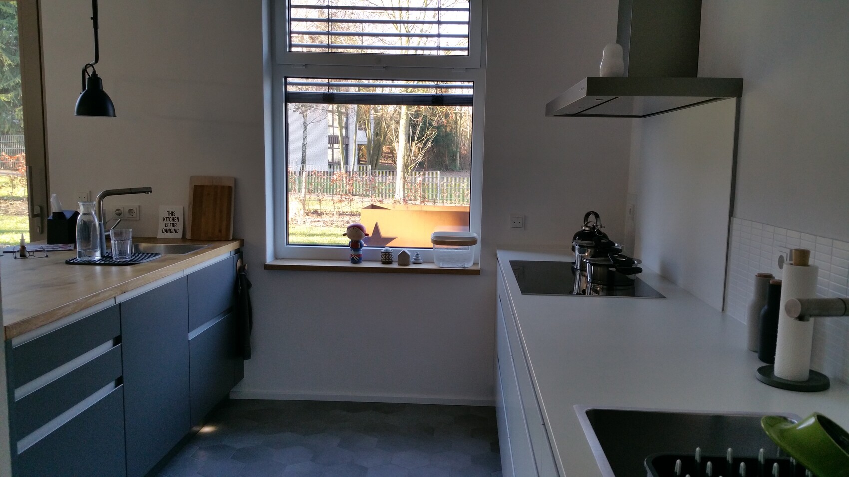

Wickie
18 Feb 2019 09:36
@11ant Here you go. Did I really forget to log off here before the ski trip? My bad. Won’t happen again...
The work block separates the dining-living area from the kitchen. Access to the garden can be seen in the first picture (that’s the movable part of the sliding door).
Modern kitchen: gray cabinets, wooden countertop, black pendant lights, gray beanbag.
That’s why there is only the “perch window” in the kitchen and intentionally no door. The windowsill is actually not much lower than the countertops, but it’s obviously a great spot for all residents and visitors to sit and chat (currently just a bit “cluttered” with decorations).
At first, our architects had planned a kind of “conversation window” with the lower part hinged to swing open. But that felt a bit too much for me. So now the lower part is fixed and only the upper part tilts open. With the ventilation system and extractor hood, we could have made the whole window fixed from today’s perspective, but oh well.
In front of the window, you can also see part of my corten steel herb raised bed. You can quickly step out and pick herbs there. Soon it will be planted for the first time!
Modern kitchen unit with sink on the left, large window front, stove on the right with extractor hood, garden view.
MadameP18 Feb 2019 09:55
That looks great, @Wickie! Am I seeing this correctly, you have two sinks?
