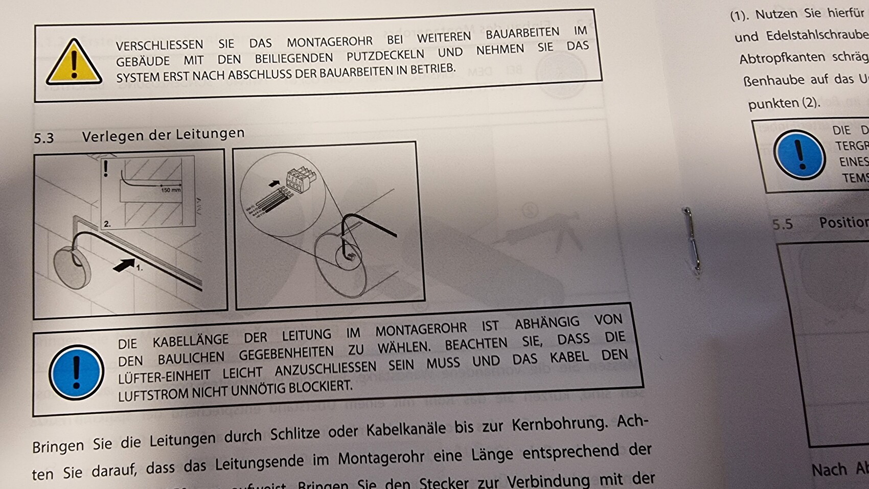

Sorry for the late reply, but I hadn’t had a chance to unpack a fan like that before. In the included manual, I found the following information (see picture). So, as described by @bigborre, the connection is made from the inside.
I think the best option right now would be to run a cable from the outside parallel to the respective drill hole—no idea how tight that space is—or possibly enlarge the core drill hole slightly to lay the cable through it. Perhaps inside, you could place the cable in a small surface-mounted box and run it to the fan in a slim cable conduit. It wouldn’t be visually appealing, though...
