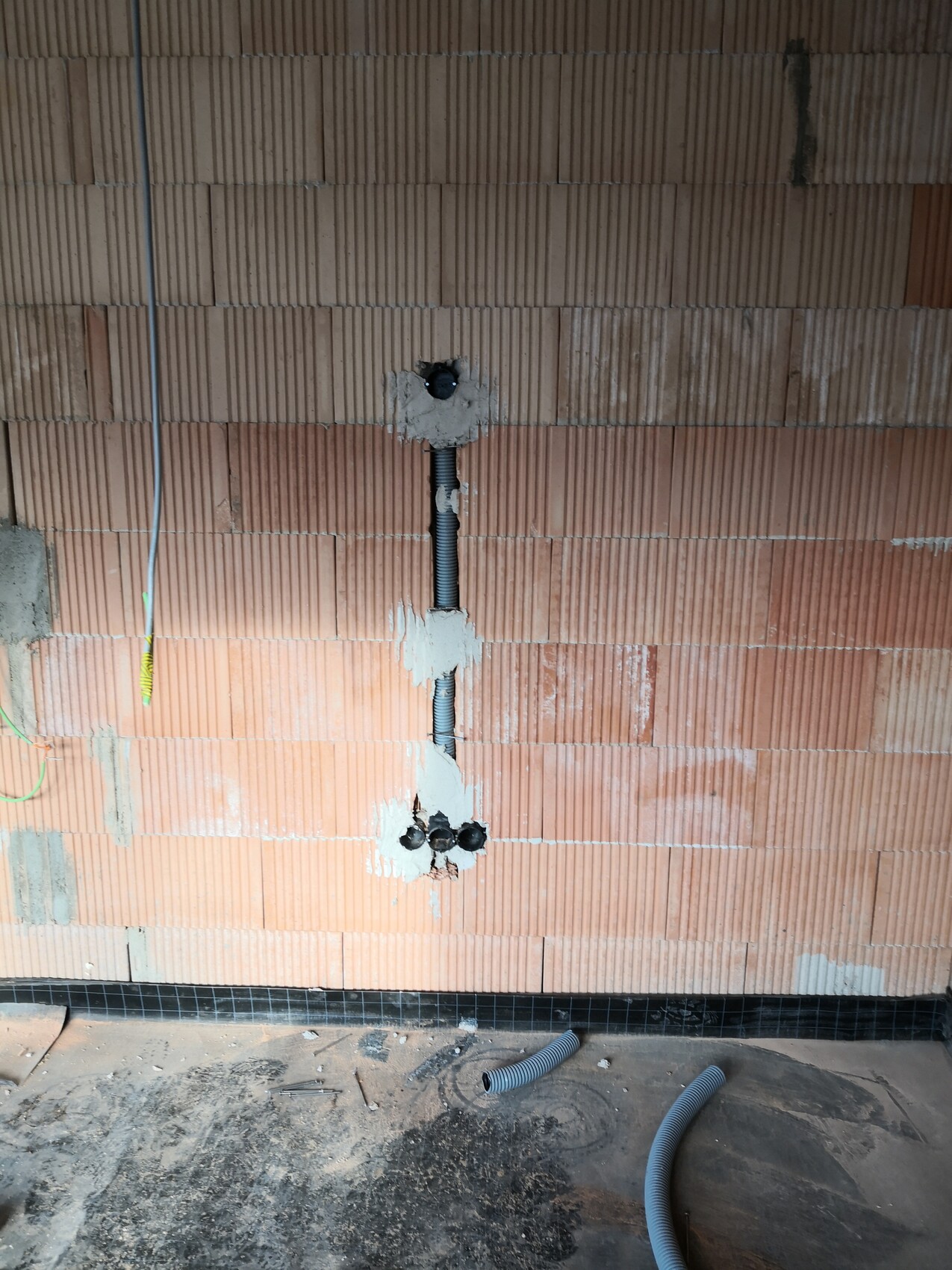

We planned a storage room behind the TV, where a trunking channel will be mounted on the wall, along with a 50mm (2 inch) conduit through the wall to insert all cables. The DVD player can also be stored in the storage room, since nowadays it can be controlled via HDMI.
In other cases, we always install a conduit from the TV downwards for clients, as there is usually a sideboard anyway.
The picture shows the secondary apartment, where outlets are also located in the storage room and connections run from top to bottom.
