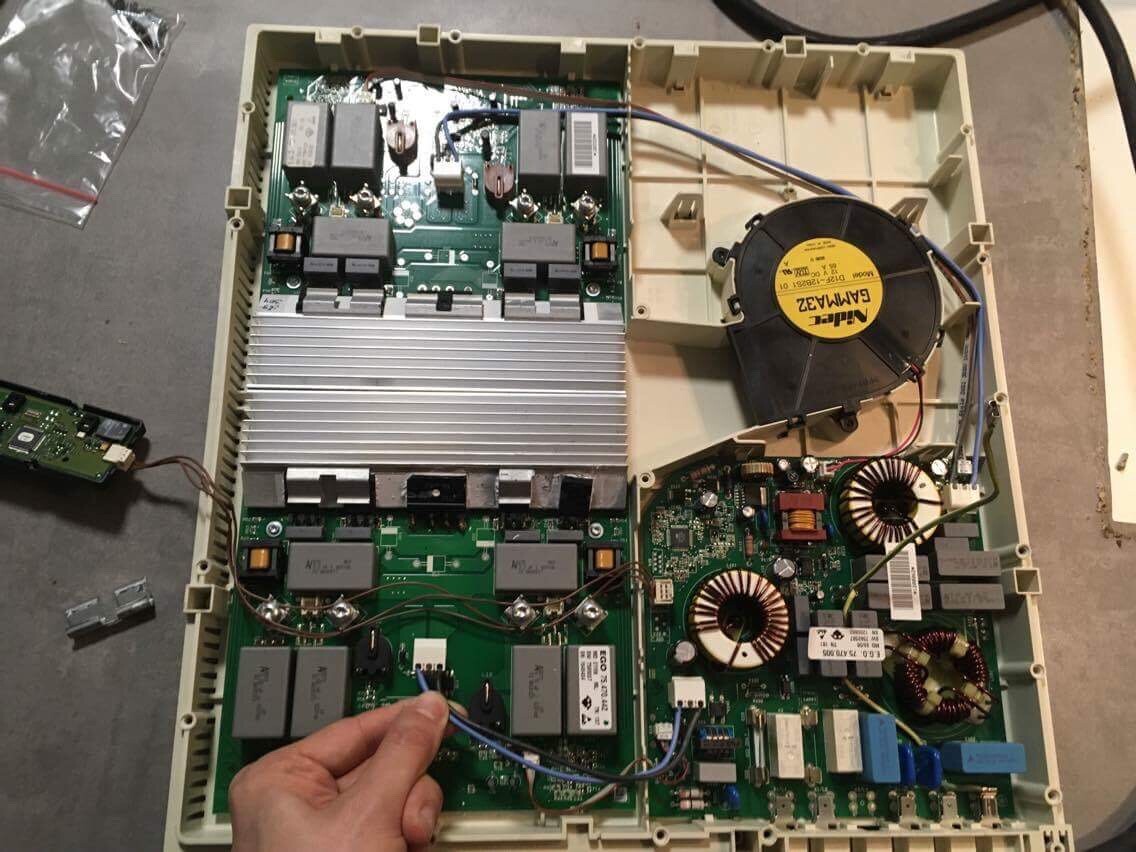

With a large frying pan, I can easily stay on Boost mode for several minutes. With my favorite pan (40cm (15.7 inches), 31.5cm (12.4 inches) base), not much happens above setting 8 anyway.
Also, Boost doesn’t automatically mean the cooktop is delivering its maximum power. With cheap aluminum pans, I can run Boost plus setting 8 as well. With suitable cookware, you can push significantly more power in. Then the second cooking zone is basically inactive. It’s simple math: 3.2 kW Boost, 3.6 kW max, so 400 W remain. A cooktop isn’t a perpetual motion machine and won’t just add another 1000 W out of nowhere.
If heat dissipation isn’t working properly, I would first check the installation situation. Although I often run the cooktop at high load, the fan rarely runs at full speed. The cooktop actively dissipates heat through heat sinks. If the installation doesn’t allow proper heat dissipation, it will soon shut down. I’ve attached a picture of my (old) cooktop. The left side is the front. The fan draws air from below and blows it out the front of the cooktop. Here, 1. there must be enough space beneath the countertop (preferably also beveled), and 2. the air must also be able to exit the cabinet, otherwise it quickly becomes like a sauna.
