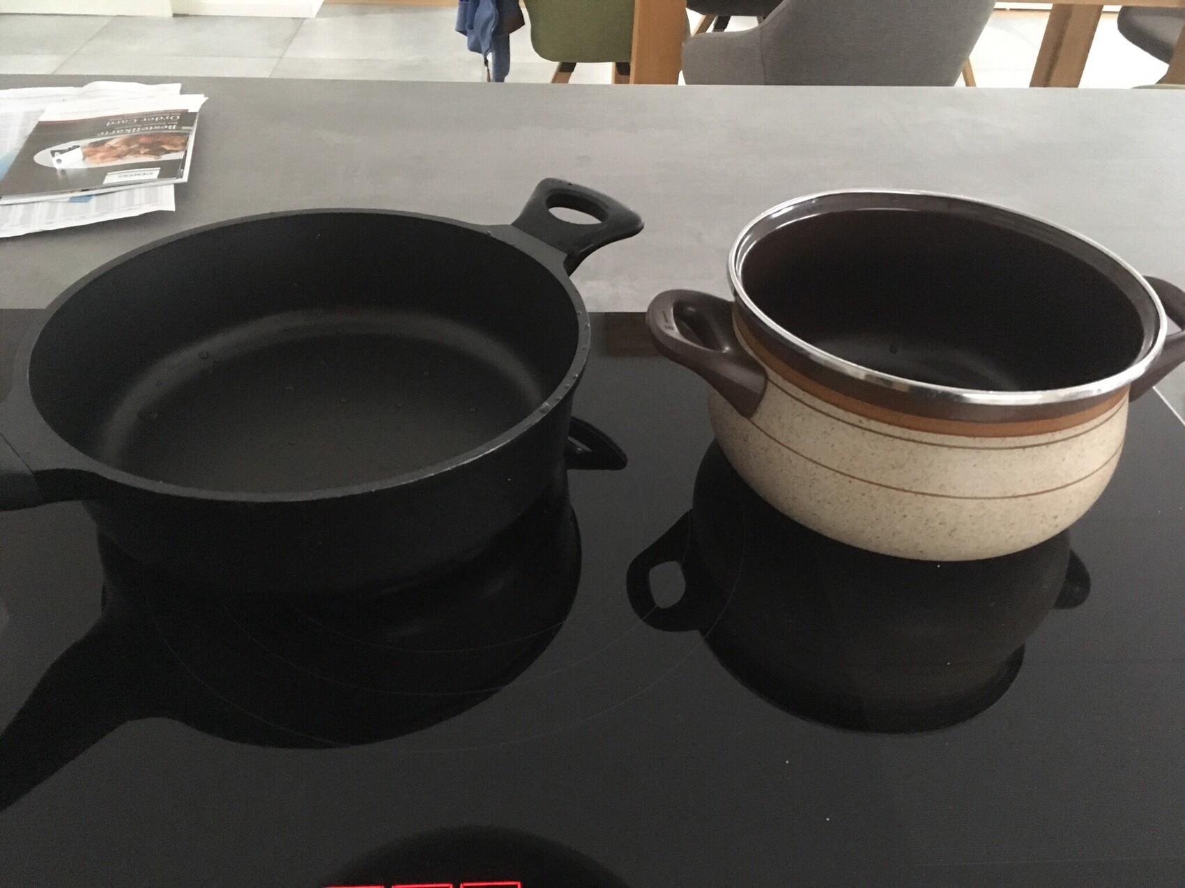

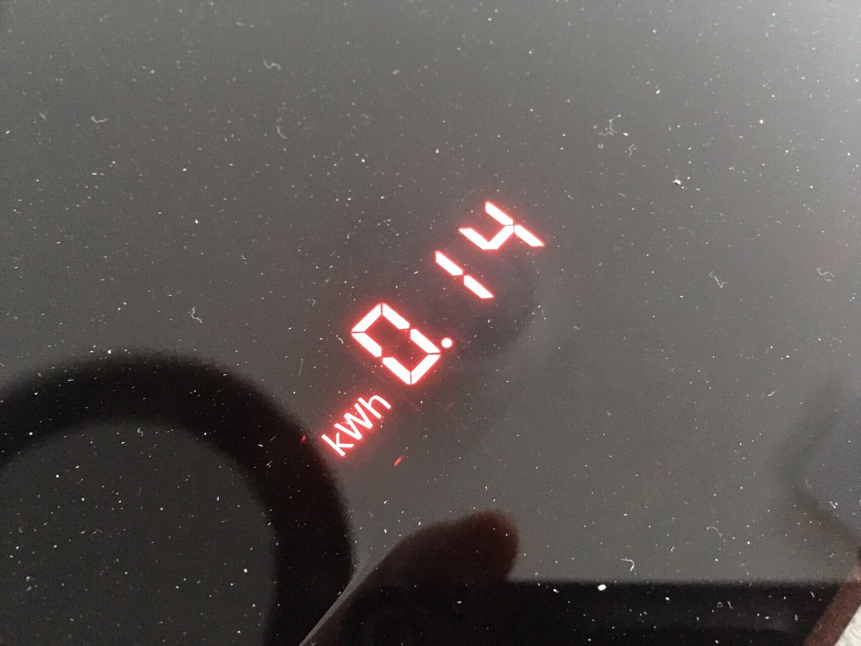

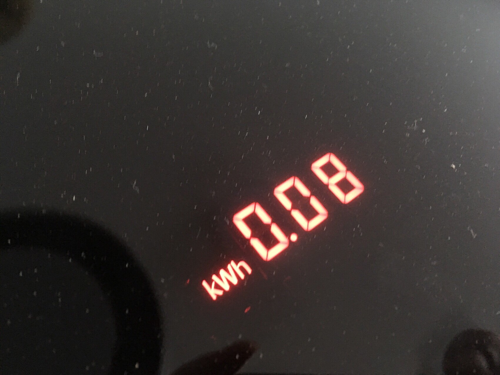

daniels8730 Nov 2017 09:30Just discovered: my new cooktop can display the energy consumed during the last cooking session. So I tested it right away.
Cheap pan from Lidl after 3 minutes on boost: 0.08 kWh. That corresponds to an average of 1.6 kW.
The good old steel enamel pot from my mother, also after 3 minutes on boost: 0.14 kWh, or 2.8 kW.
The difference was easy to notice, too – the pan simmered quietly, while the pot boiled vigorously.
The induction base of the pan is even slightly larger than the bottom of the pot, but the pot is made entirely of steel, so it can also absorb the magnetic field from the sides.

Knallkörper30 Nov 2017 17:00Our Neff cooktop has that feature too. Unfortunately, it’s just an estimate and nothing more. It might work for comparing pots, though.
Edit: Did you really leave the two pots on "Boost" for 3 minutes without anything inside?

Edit: Did you really leave the two pots on "Boost" mode empty for 3 minutes?Of course not! 1L (34 fl oz) of water.
I don’t find it that inaccurate for comparison since the results are reproducible. The same values come up every time.
Knallkörper30 Nov 2017 17:32Our cooktop displays this after every cooking session. However, the main electricity meter always shows a lower reading, even though other devices are obviously connected as well. I also can’t imagine that current transformers are installed there.
daniels87 schrieb:
Of course not! 1 liter (1.06 quarts) of water. I don't find it inaccurate for comparison since the values are reproducible. The same results come out again.Really? For me, even 1 liter (1.06 quarts) of water would be gone long before after 3 minutes of boosting... Definitely in the pot and not the pan...Similar topics
