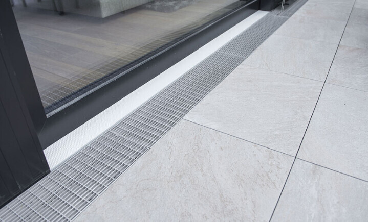

Example (but it would also have to be connected to the drainage system):
View of glass front on the left, metal channel drain on the floor next to light gray tiles.
neutri80
20 May 2021 14:39
nordanney schrieb:
Example (but it must then also be connected to the drainage):
That looks like a sliding door, so it’s completely flush, right? We don’t have a sliding door. So we basically have to step over the frame. Do you need to do it like that as well?
