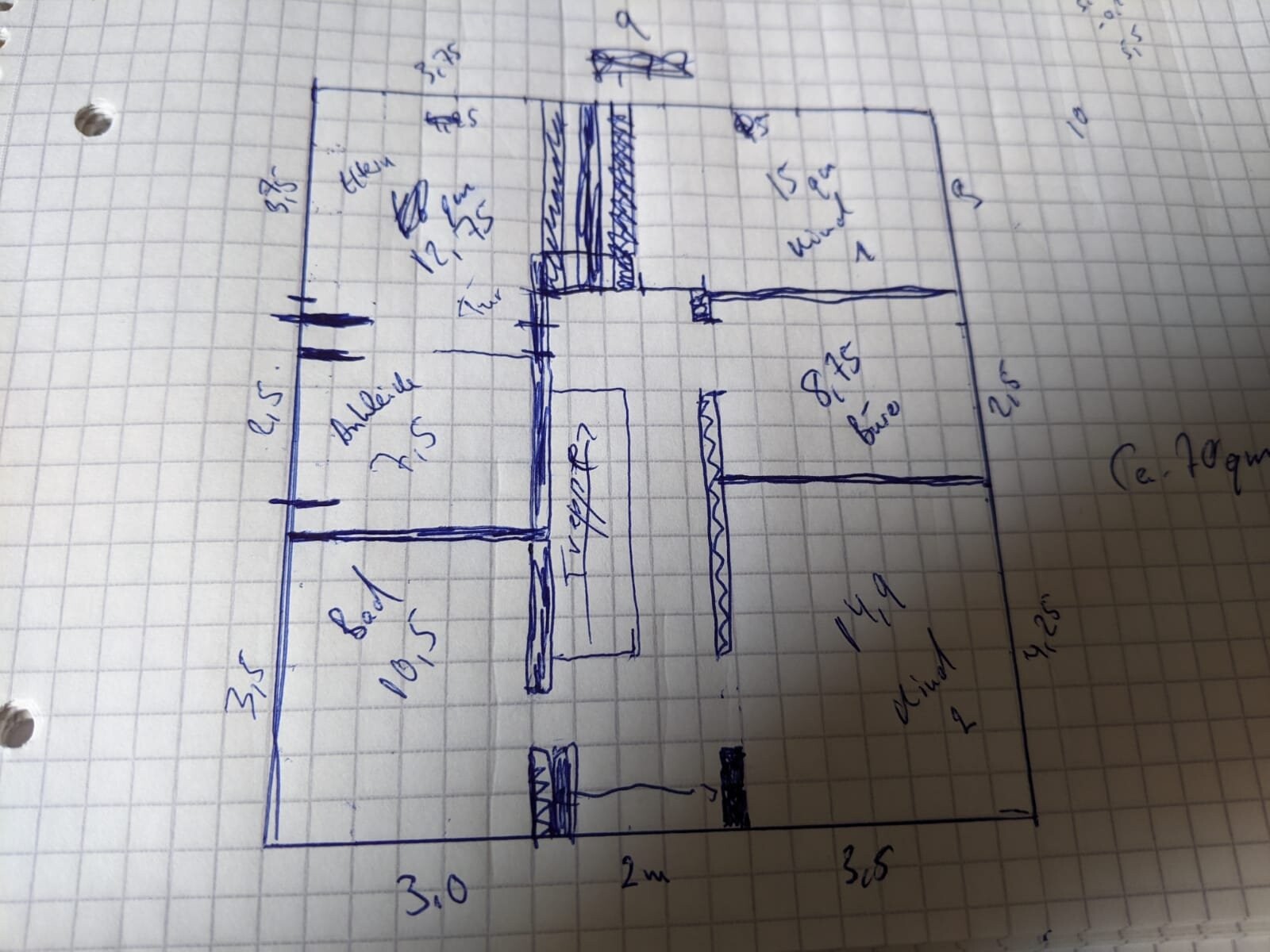

Hand-drawn floor plan of an apartment with hallway, several rooms and measurements in meters
So, I made a simple drawing and will improve it when I have time. The indicated dimensions are the interior measurements. The upper floor could look something like this.
haydee schrieb:
No bathtub is just as excessive as having two. Why not just one?
There are still two unknown family members to consider.
Maybe swap the kitchen and living area. That way, the kitchen would be closer to the terrace.
Please draw in realistic furniture in the open living area. Kitchen, dining table, and cabinet won’t work in reality as shown.
I’ll see what I can do with the gained space on the ground floor and will think more about the kitchen layout.
