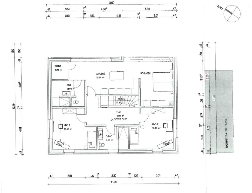

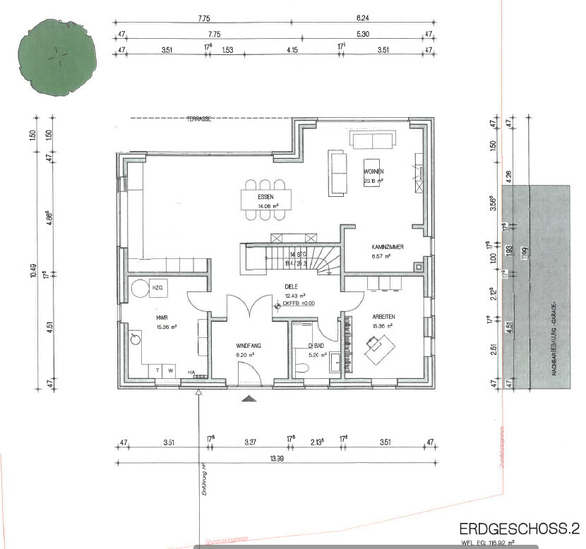

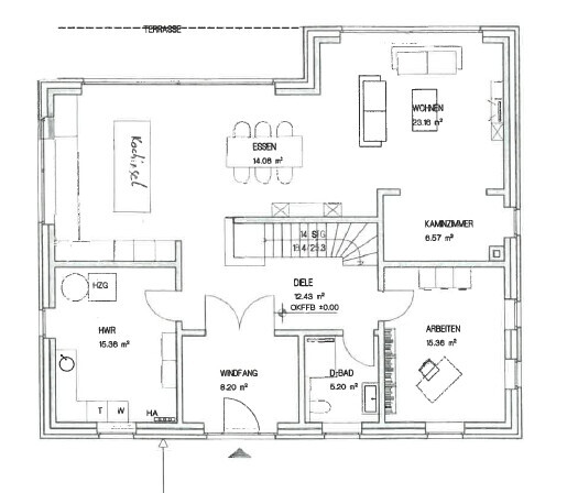

StefMeister8 May 2019 14:21@haydee I agree with you that the rooms are definitely too big for small children, but as a teenager or, in my case now, an adult, you simply want more space for your partner, friends, and so on. That’s probably not very important to children, which is why I want such a large master suite, as you described nicely. We will equip the children’s bathroom in a way that allows us to separate everything, meaning all child-related activities will take place there. This also means that, temporarily, storage for cleaning supplies and similar items will be created in a cabinet, but I don’t see the point in creating an extra room just for that, which later would become unnecessary or rarely used. I understand that sleep will become a luxury, but the children won’t be planned for another 8–10 years, and our income might take a slight hit. However, the mortgage and monthly payment are adjusted so that we can finance the house on one income alone while covering all other expenses (including vacations). From what I’ve seen with relatives, how life changes with children and how living arrangements shift, having family nearby makes things much more comfortable and definitely takes a load off your shoulders.
My comment was not about your financing, but purely about your wishes and expectations.
In your early 20s with two incomes, you dream of a loft, some luxury, a bit of a glossy magazine style.
Kids, yes – but please don’t disturb.
Then comes the baby and toddler phase. At this stage, the standard floor plans you often see, with a utility room upstairs and an open layout downstairs, simply work well (that’s why so many are built that way).
Then comes the phase with teenagers.
That’s when you design a concept like Hampshire.
And later on, you might build something like Nordlys.
Four age groups with four very different priorities.
You have to bring them all under one roof.
I did not describe the children’s rooms as too large.
Regarding your parents’ suite:
Imagine the mother is awake all night because the child is sick. The child finally falls asleep. You get up, walk into the dressing room to get dressed. The child cries out loudly, so you walk through the bedroom to the child’s room. Then you go back through the bedroom to the dressing room, into the bathroom, and again through the bedroom.
Connect the parents’ suite through the dressing room. One exit, and peace and quiet.
Laundry piles up upstairs whether or not there are children. It’s not the case that the washer and dryer are only used by the parents. The space would not be unnecessary.

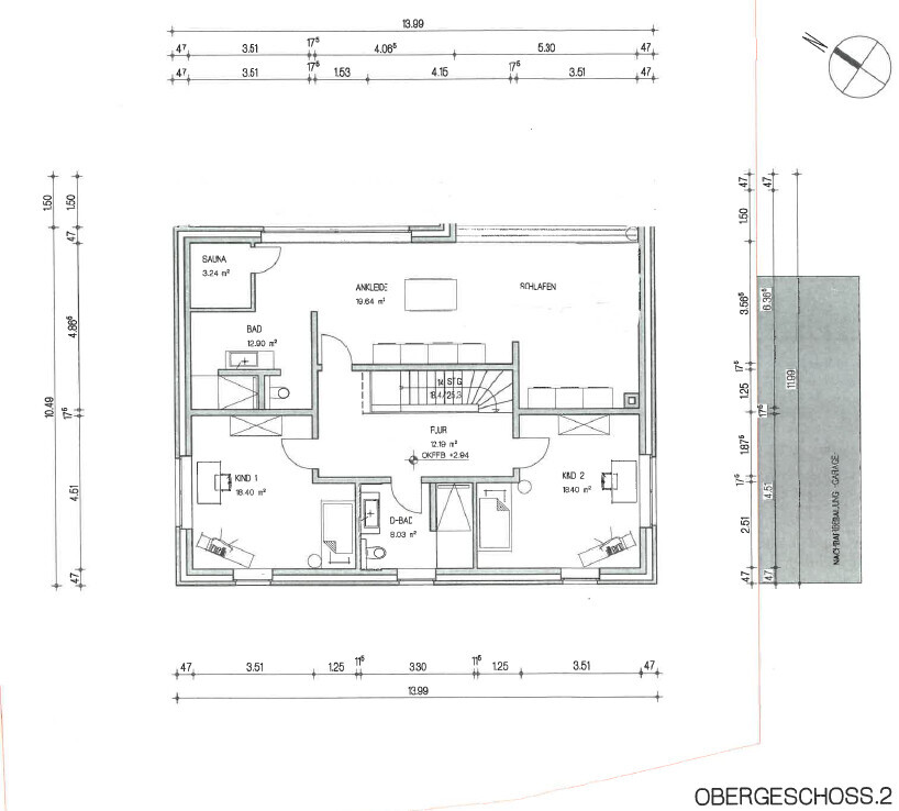

StefMeister9 May 2019 11:05So, after some personal adjustments and changes to the various proposals, we now have a design that we both like. I hope everything is clear in the pictures. In the bedroom, there will be a shoulder-height window in the dressing area/bathroom, as well as in the children's bathroom. We also like the staircase much better now. The kitchen still needs the freestanding kitchen island pushed forward into the room. Otherwise, only minor details regarding facade articulation and finishing touches remain.
I would strongly recommend at least separating the bathroom from the rest of the bedroom with a door. An open bathroom offers no real advantages, only disadvantages. If someone gets up at night to use the toilet, they have to turn on the light, which also shines into the bedroom area. Flushing the toilet is probably audible from the bed as well. After eating chili or kale, there are other sounds you don’t want to hear, and it’s hardly romantic. Not to mention the odors—after chili, using the dressing room isn’t enjoyable.
We once stayed at a hotel with a similar open concept, and it was dreadful. In the end, you’ll end up using the other bathroom for those needs anyway, making an open bathroom in the bedroom unnecessary.
