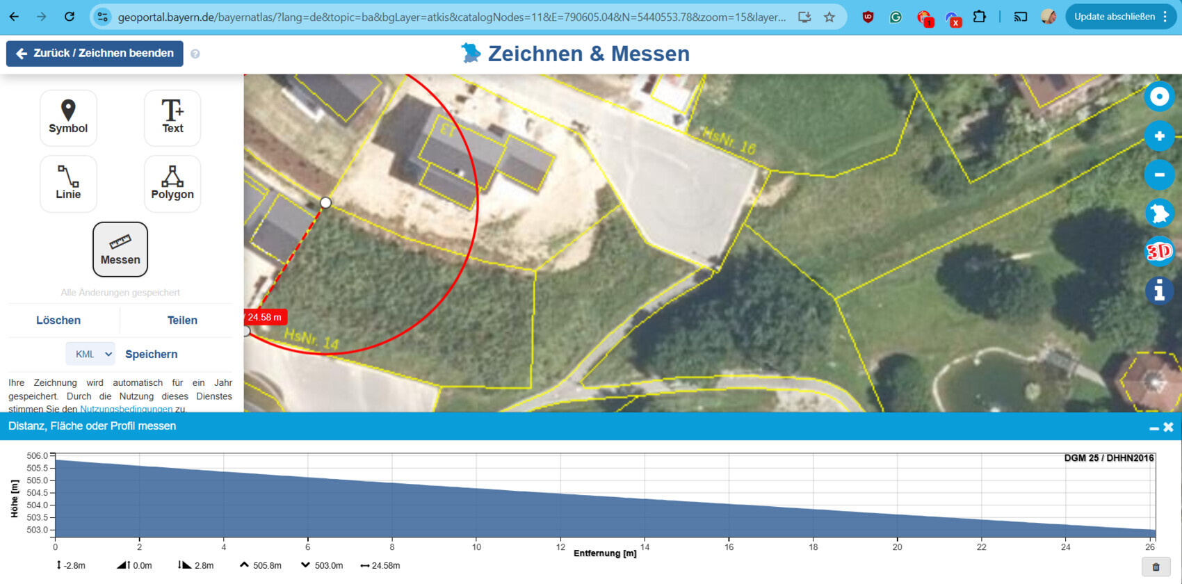

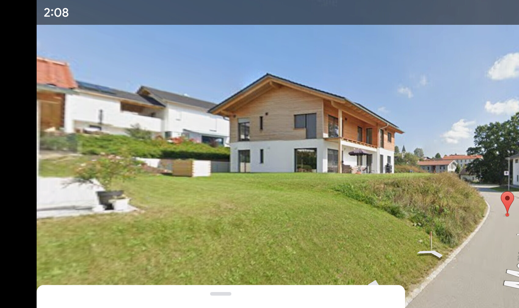

hanghaus20234 Nov 2024 11:58A large part of the plot is mostly a gently sloping terrace.
For me, 18% is already quite steep. Do you have a photo of how your western neighbor built their house?
@ypg
Thanks, we are also really looking forward to the beautiful view.
Could you please explain how you calculated the 18% for that section? I can’t find sufficient data in the Bavaria Atlas and would like to learn more about this.

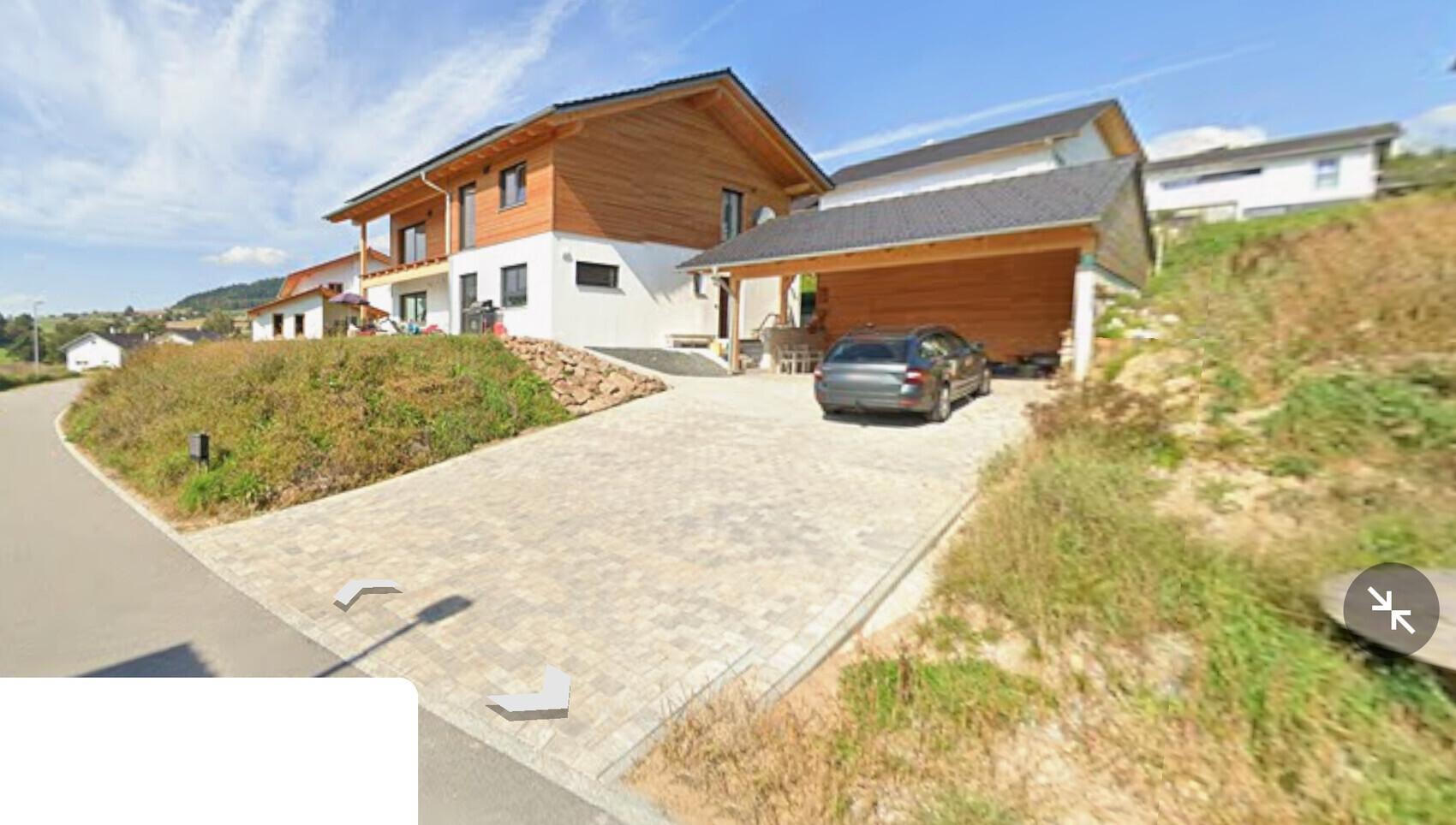

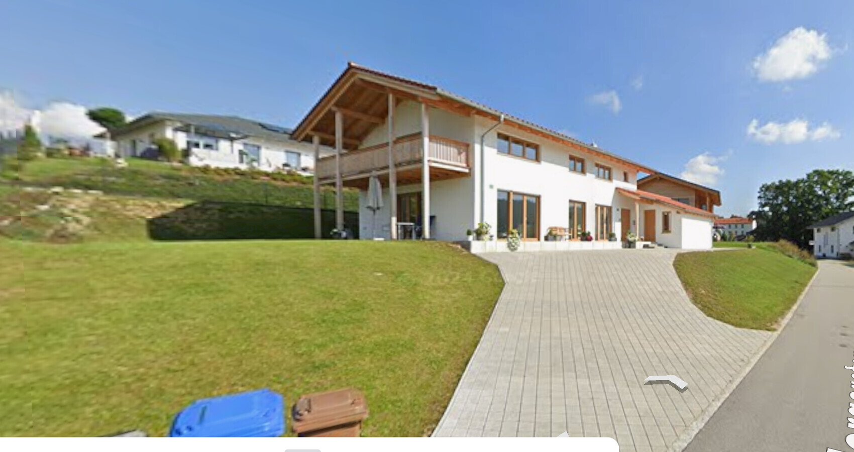

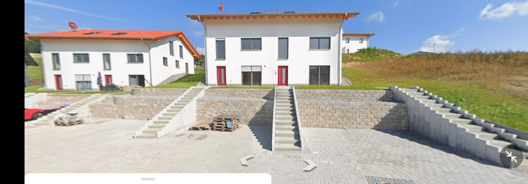

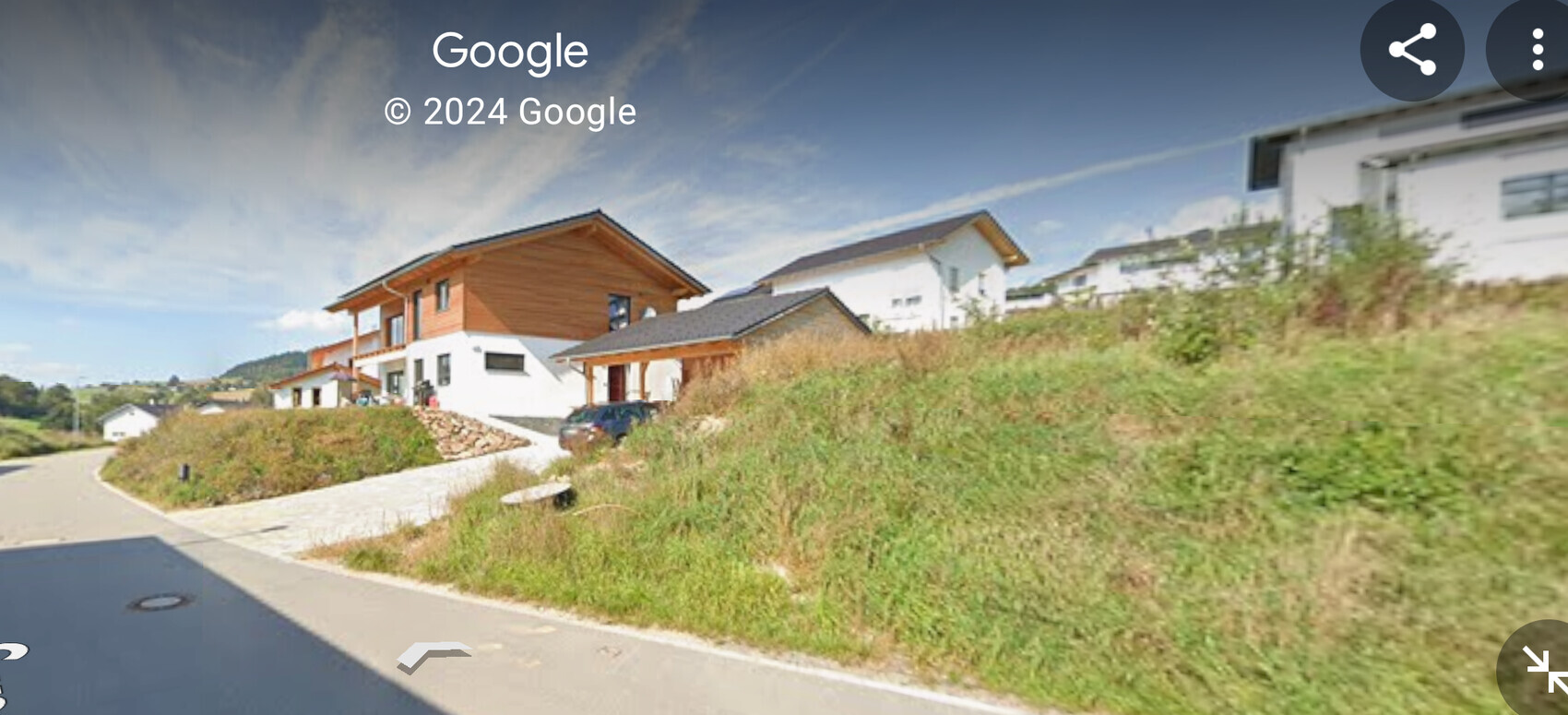

I’m currently online via mobile, so I attached screenshots from my phone (Google Street View). In this case, pictures of “all” western neighbors for better understanding.
Picture 1 shows the paved parking spaces of the first houses on the street (I think a developer project), where you can see the ground leveled and stabilized with a retaining structure up to the slope. The house is then built partially on the leveled area and partly into the slope above.
The next neighbor has an ascending driveway but no garage; it looks like they remodeled the entire lot and placed the house on the leveled area. At the rear, I don’t see a retaining wall for the slope, only the next embankment leading to the house above.
The immediate neighbor left the slope beside the street as it is, except for the driveway to the garage where excavation was done. The house also sits on this upper level, and at the back, you can see the slope with a retaining wall.
Does this help you so far?

hanghaus2023 schrieb:
"A large part of the plot is mostly a gently sloping terrace."
To me, 18% already seems quite steep. Do you have a photo of how your western neighbor built their house?

hanghaus20234 Nov 2024 16:55In the third picture, you can clearly see that the western neighbor to the north has a retaining wall made of L-shaped blocks, which is against the building regulations. However, the excavation for landscaping is probably within the allowed limits. I’m surprised that the building authority allows something like this.

In the third picture, you can clearly see that the western neighbor on the north side has a retaining wall made of L-shaped blocks. This is contrary to the development plan. However, the excavation for landscaping is probably within the allowed limits. I'm surprised the building authority allows something like that.
What are your plans for placing the house? Would you prefer the garden on the west side or the east? Do you want the house to be as tall as possible? Where and how high would parking spaces or a garage be? The neighbor’s garage is located far back and dug in quite deep.Yes, the neighbor has apparently taken a few liberties, in a bit of a “Pippi Longstocking” style.We would place the garage towards the neighbor’s side, but lower down. The house would rather be positioned as high up as possible. A split-level design would make sense, probably something like the rough sketch I doodled.

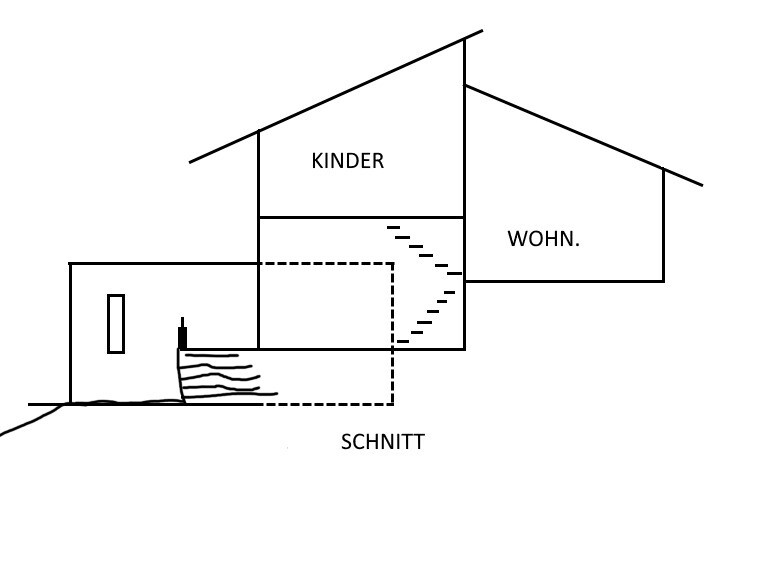

hanghaus20238 Nov 2024 10:38Split level construction is expensive and not necessary here.
