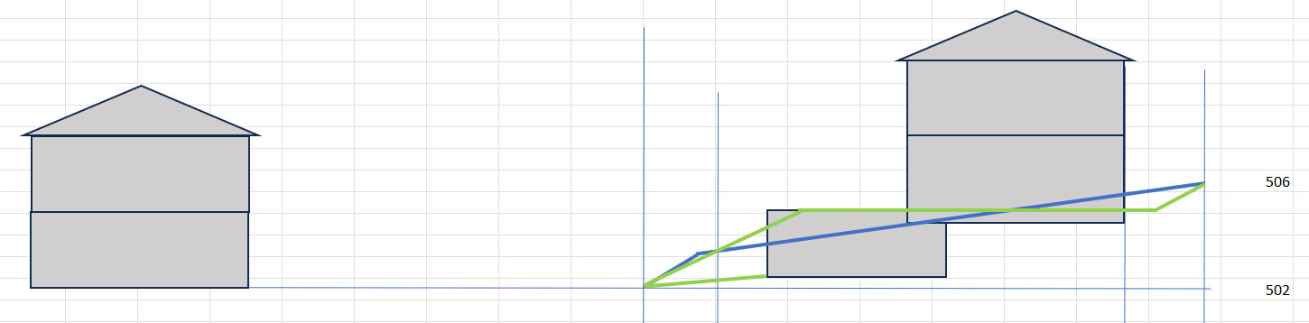

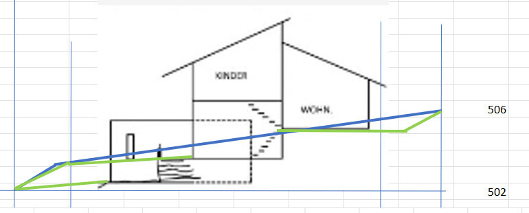

hanghaus20238 Nov 2024 11:59In my opinion, it’s also possible without a basement. The lot here is 22m (72 feet) wide and the building area is 16m (52 feet).
blue: original terrain
green: modeled terrain
I looked at it again. It actually works better this way since the volume is reduced by a quarter.
The roof is a bit flatter so the children can still have a good view outside.

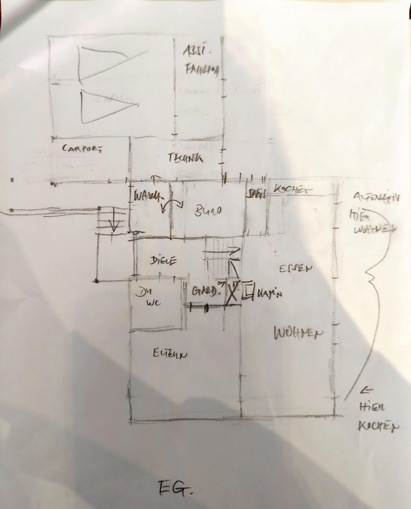

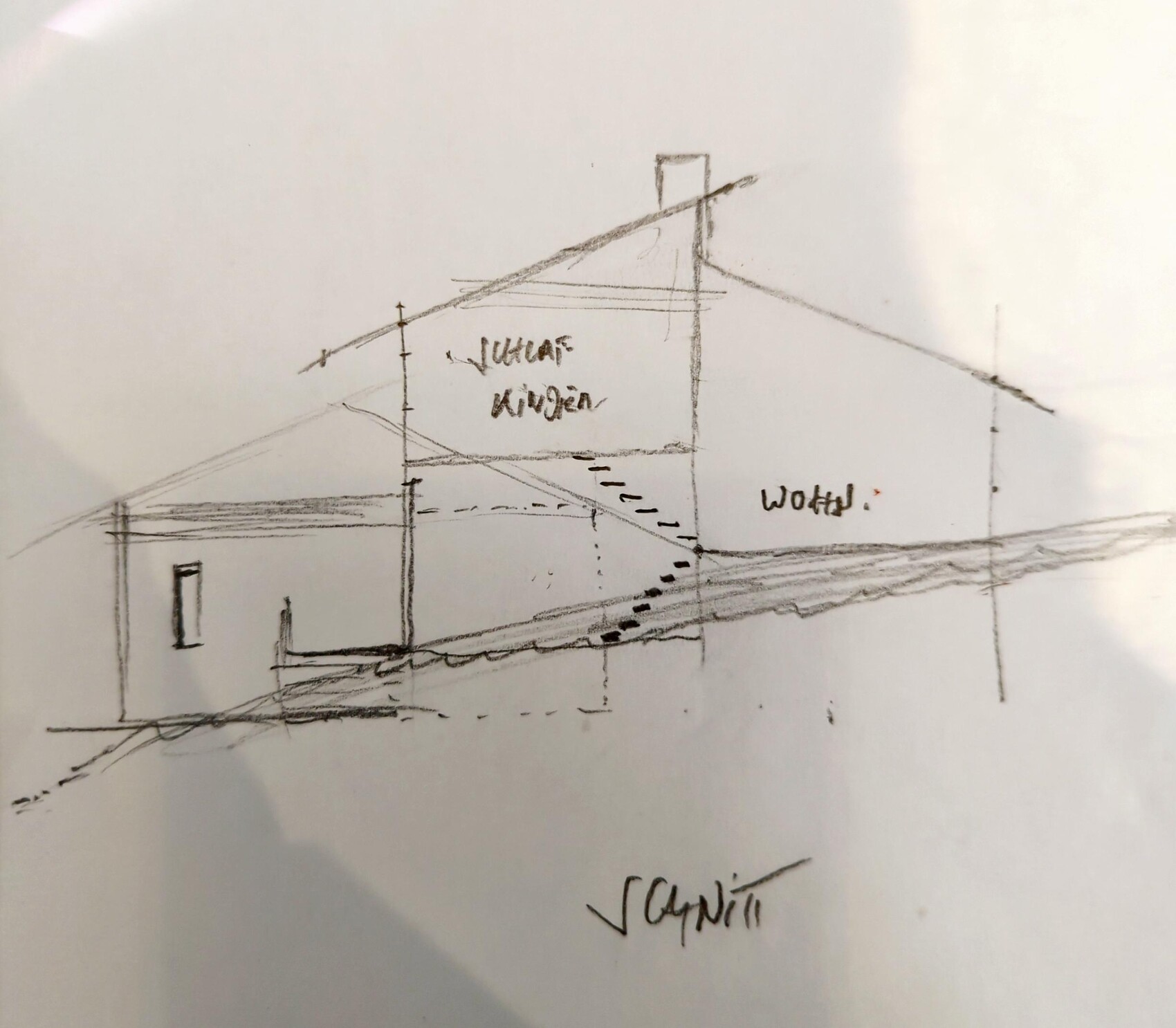

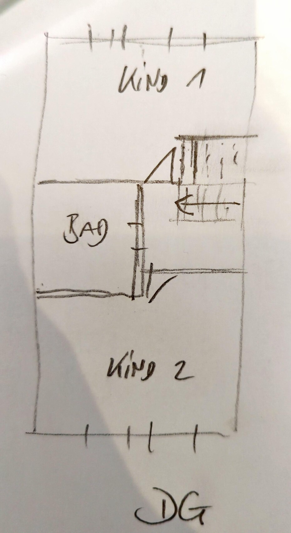

I’m happy to upload the original sketches of the preliminary design so you can see that the site has been well taken into account.
The dropped ceiling in the child’s room was just an example to show that storage space could be created here (or in the garage ceiling). The pantry was a suggestion added later, but I’m not sure if we will actually need it; it wasn’t really a requirement in the program brief.

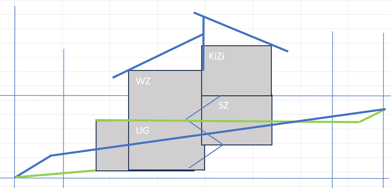

hanghaus20239 Nov 2024 11:27H
hanghaus20239 Nov 2024 11:57Do you really want to live in the north? Right next to the houses above?
If that’s truly what you want, the house should be positioned closer to the street to at least have some garden space on the north side.
Tell me what you like and don’t like about the design.
I have the entrance at the bottom and the same number of stairs up to the living room.

hanghaus20239 Nov 2024 13:44With the boundary garage, the architect cannot maintain the ridge direction.
Your plot is large enough and does not actually require the boundary development.

I’m happy to upload the original sketches of the preliminary design, That’s pretty much the style of my own rough sketches as well (except I usually use a ballpoint pen). Architects tend to draw without worrying about making it look like traditional draughtsman’s drawings.
