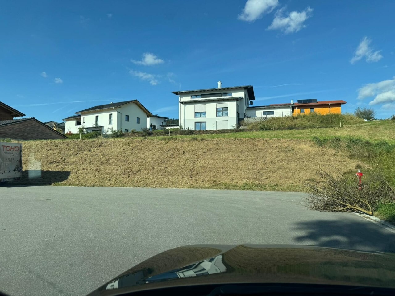

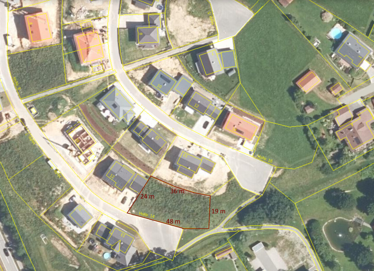

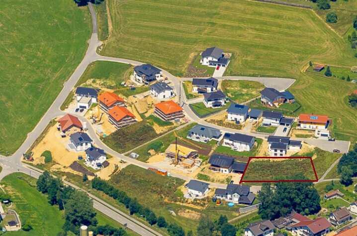

Since this will probably be relevant later: I have attached the aerial photo we received from the municipality, as well as a section of the parcel map from the Bavaria Atlas and a photo taken from the cul-de-sac (each looking south, with the map oriented north). Unfortunately, I can’t really determine the elevations from the Bavaria Atlas, but the highest point is about 508 meters (1,667 feet) above sea level, and the lowest point (the street) is 502 meters (1,647 feet) above sea level. A large part of the plot is largely a gently sloping terrace, which then drops steeply to the street with a steep embankment. The area to the east of the plot remains green space. I have also attached the zoning plan; ours is parcel 20. By the way, the street can be accessed via Google Street View, so you can compare how the future neighbors have handled the "embankment."

By the way, the street can be explored using Google Street View,Parking below, living above – and to the east, a wonderful view of the church tower. Nice!Wo1z3rl schrieb:
