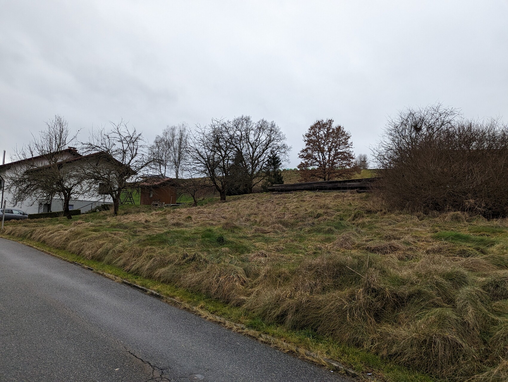

Is it a sloped plot? Yes, that's correct. My uncle’s original plan included a basement for living space. I added a photo from January; the street area is included as well. Behind the row of apple trees, there is still a strip of land about 1.5 m (5 feet) wide.
