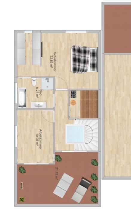

ᐅ New Construction of a Semi-Detached House on a Slope in Hesse – Feedback on the Floor Plan
Created on: 1 May 2020 10:31
KundF_HofK
KundF_Hof1 May 2020 10:31Hello everyone,
we have now reached the point where we are building a semi-detached house (both owners of the semi-detached) in Hesse. The plot is located in an established residential area with existing buildings that we will have demolished. The plot will be divided lengthwise in the middle.
We are currently working on a near-final version of our floor plan with our builder and would greatly appreciate any feedback. Perhaps we can still improve or optimize a few things.
Plot size: currently 783 sqm (8427 sq ft), to be split in the middle
Slope: yes, sloping down towards the street
Floor area ratio: 0.3
Building envelope, building line and boundary: 18 meters (59 feet) length, width up to the setback area, approximately 13 meters (43 feet)
Edge development: no
Number of parking spaces: 1.75 for living area > 50 sqm (538 sq ft), 1 parking space for < 50 sqm (538 sq ft)
Number of floors: 2 full stories, plus 75% attic floor, plus basement
Roof type: flat roof
Architectural style: cubist, Bauhaus
Orientation: east-west
Maximum height / limits: 11 meters (36 feet) above natural ground level
Owners’ Requirements
Style, roof type, building type: minimalist, lots of light, possibly with color, flat roof, semi-detached house
Basement, floors: basement, half below street level, half above ground
Number and age of occupants: 2 adults, 2 kindergarten-aged children
Office: family use or home office: home office, not near children’s rooms
Guest bedrooms per year: grandparents weekly
Open kitchen, kitchen island: open kitchen, with U-shaped layout or kitchen island
Number of dining seats: 6
Fireplace: plan for one to be added later if needed
Balcony, roof terrace: no balcony, 25% roof terrace
Garage, carport: 1 garage, 1 carport
Utility garden, greenhouse: child-friendly garden
Who designed the plan: discussions with several architects, best elements combined by us
What do you particularly like? Why?: the room layout and functions fit our needs, but is the space adequate for each?
If you had to give up on any details or expansions
- what could you do without: sauna (but prepared for in the attic)
- what could you not do without: 3 rooms plus master bedroom, study
What is the most important / fundamental question about the floor plan summarized in 130 characters?
The house is on a slope, and the basement will be half above ground facing the street. A separate entrance is needed for the granny flat. The house should be an eye-catcher, possibly (plastic windows) with wood appearance, front overhang covering kitchen and hallway above. Bay window not possible as it is too expensive according to the contractor.

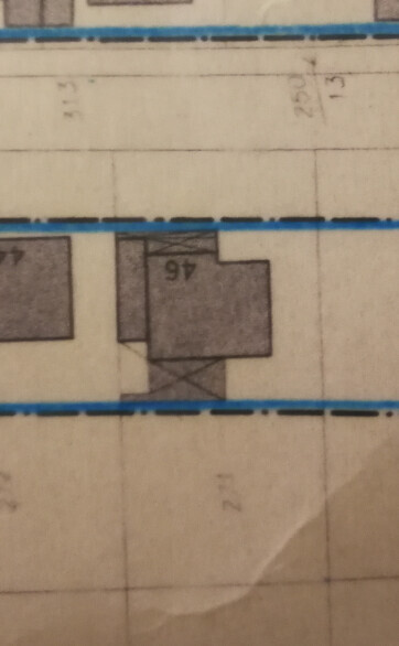

First of all: Do the cadastral map and the development plan show us what is on the property? What type of building is marked there? Why is there talk of a semi-detached house? Is the same building supposed to be mirrored and built somewhere on the plot? Could you please post a north-oriented drawing of the property that shows where the semi-detached house / duplex is marked? I find many aspects confusing here.

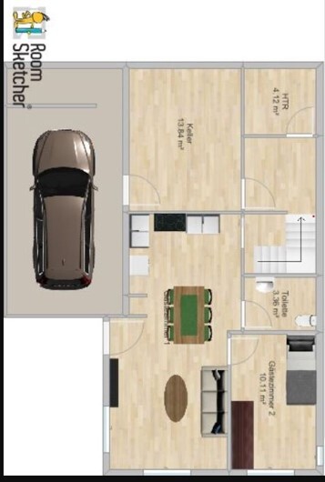

The stairs from the basement to the ground floor are drawn incorrectly. At least, you can’t access them as shown. The arrow always points upwards, so if you rotate the plan accordingly, it would also work for a secondary apartment entrance.
Regarding the secondary apartment: bathroom without a shower? Window facing your garage driveway? Who will rent that?

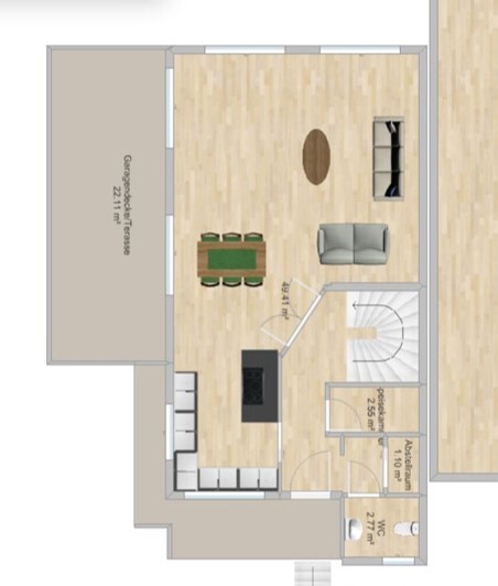

Ground floor: living room is disproportionately large compared to the dining area. The dining area has no space and feels cramped. Where is the cloakroom?

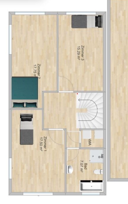

Upper floor: I won’t comment on the dressing room... haha... amateurs will probably end up lining up wardrobes one behind the other there.
Well, there is still enough space to shift things around... but 6.x m² (around 65 ft²) for a bathroom with a bathtub and two doors is quite ambitious, if not Olympic-level.
Given the sum of planning errors, I would strongly recommend having an architect or the general contractor do the design properly as soon as possible!

First of all: Do the cadastral map and the development plan show us what is on the plot?
What type of building is marked there? Why is there talk of a semi-detached house? Is the same design supposed to be built mirrored on the plot? Could you please upload a north-oriented drawing of the plot showing where the semi-detached house (DH/double house) is planned?
I find a lot of this quite confusing.

The staircase from the basement to the ground floor is drawn incorrectly. At least you cannot reach it AS DRAWN. The arrow should always point upward. So rotate the plan overall, then a bathroom in the granny flat will also work.
Regarding the granny flat: bathroom without a shower? Window faces your garage driveway? Who would rent that?
Ground floor: living room is too large in relation to the dining area. The dining area is cramped and undersized. What about a cloakroom?
Upper floor: I won’t even comment on the walk-in closet... laugh... amateurs will probably end up lining up wardrobes in a row. Well, there’s still enough room to push things around... but 6.x square meters for a bathroom with a bathtub and two doors is ambitious, to say the least.
Given all the planning mistakes, I would urgently recommend having an architect or the general contractor handle this!

- Currently, there is an existing building on the site. According to the forum guidelines, development plans and cadastral maps should be provided, which was my intention here. According to the development plan, a semi-detached house is permitted, and that is what we want to build.
