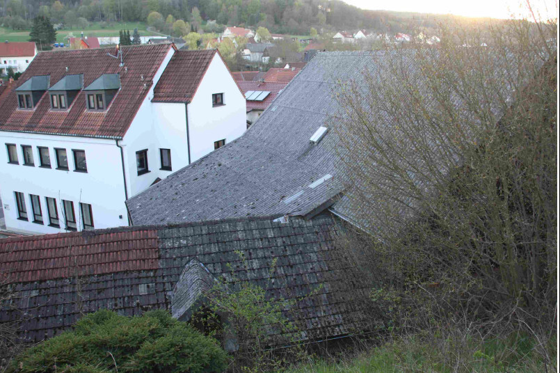

haydeeAfter searching for over a year for a demolition company, we have found a firm that
a) submitted a quote within the cost estimate provided by the architect
b) includes everything in the quote
c) is not intimidated by inner-city locations or steep slopes
The plot is currently developed and will be mostly demolished. The new house will be built along the line of the old retaining wall, so no further excavation will be necessary.
I hope you understand what I mean.
I’m attaching a photo of the current buildings.

The demolition has been approved, and the excavator will arrive in about 2 weeks.
After that, we’ll see what condition the old retaining walls are in.
I’m starting to feel a bit sad that everything will be gone. There are memories attached to it. At least the old stone cellar in the barn will be preserved.
