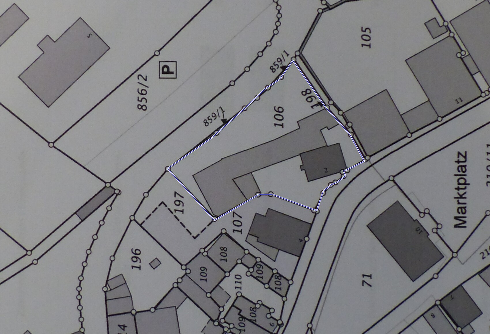

After searching for over a year for a demolition company, we have found a firm that
a) submitted a quote within the cost estimate provided by the architect
b) includes everything in the quote
c) is not intimidated by inner-city locations or steep slopes
The plot is currently developed and will be mostly demolished. The new house will be built along the line of the old retaining wall, so no further excavation will be necessary.
I hope you understand what I mean.
I’m attaching a photo of the current buildings.
Development plan/restrictions
Plot size: 1227 m² (13,210 sq ft)
Slope: yes, see photo

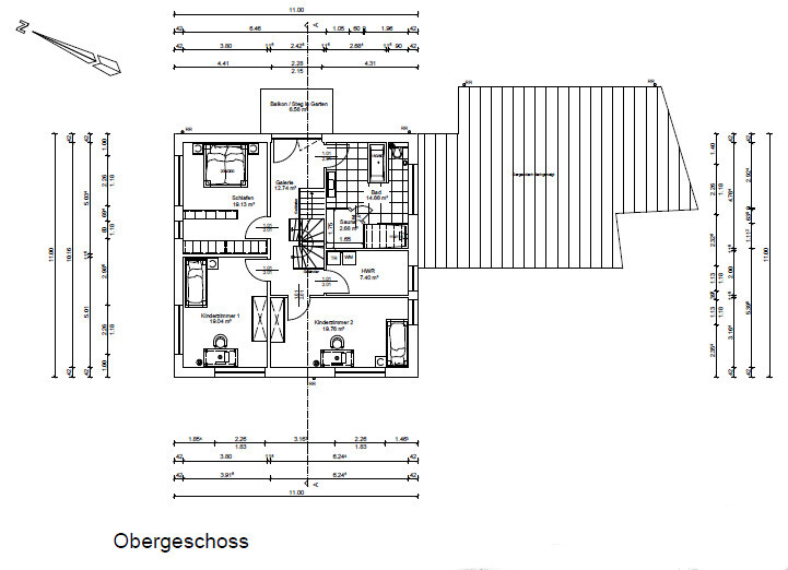

Client requirements
Architectural style, roof type, building type – gable roof
Basement, number of floors – no basement, two full stories
Number of occupants, age – 2 adults (38 years old), 1 child (1 year), possibly a second child
Room requirements on ground floor and upper floor – ground floor: utility room, wardrobe, shower bathroom, kitchen, dining, living
Upper floor: bedroom, walk-in closet, 2 children’s rooms (one may be used as a multipurpose room), bathroom with steam shower, laundry room
Office: family use or home office? No
Number of overnight guests per year: 2–3
Open or closed architecture: open living, dining, kitchen
Conservative or modern design: rather conservative
Open kitchen with cooking island
Number of dining seats: 8–10, extendable to 12
Fireplace: no
Music/stereo wall: no
Balcony, roof terrace: upper floor with access to garden (sloped site)
Garage, carport: double garage with storage room, new garage, existing storage room
Utility garden, greenhouse: no, possibly outdoor kitchen later
Additional wishes/special features/daily routine:
Ground floor wheelchair accessible, bathroom suitable for wheelchair, straight staircase

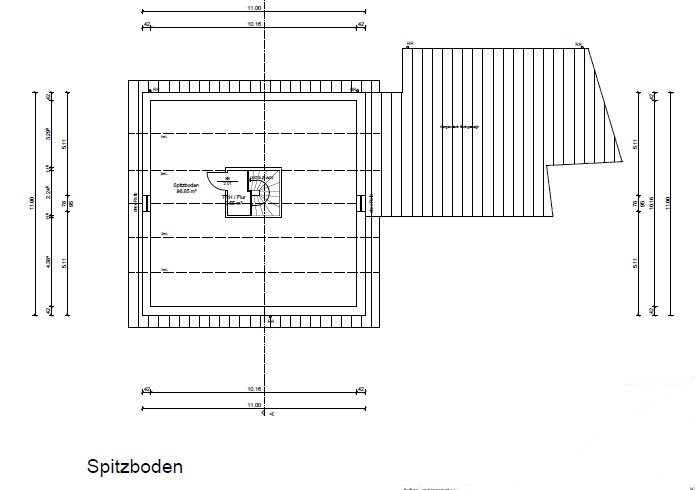

What do you dislike? The staircase to the attic – absolutely not acceptable

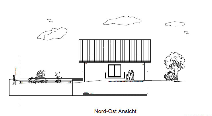

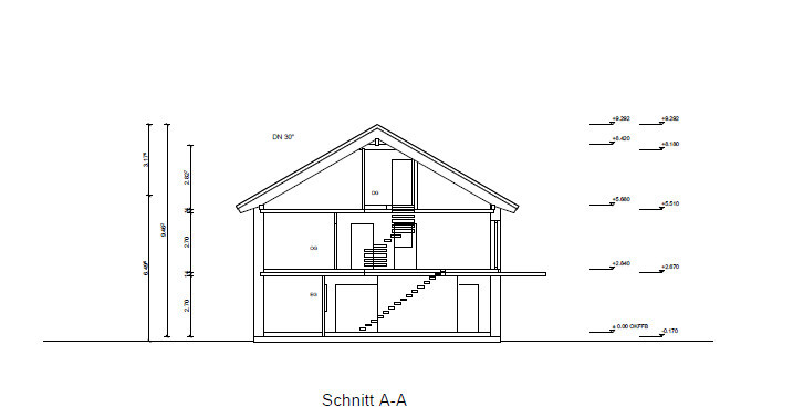

Why is the design the way it is now? For example:
Which requests were implemented by the architect?
The design has already been changed a few times. The architect worked out the space requirements with us, created the floor plans, and the slope had to be taken into account. Our wishes regarding rooms and sizes were considered.
Kitchen and bathroom layout are not yet finalized – they were drawn in by the architect for now.
What bothers us is the staircase to the attic. We want a well-accessible staircase.
Neighbors: parcel number 107 Bank and doctor, parcel number 105 parish office
Hopefully, I haven’t forgotten anything. When my husband returns from his business trip, we plan to meet with the architect. It would be great if you could give us some advice or suggestions.
