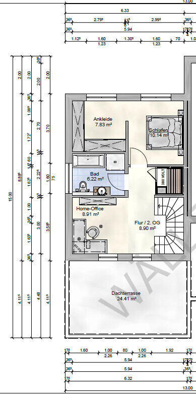

KundF_Hof6 May 2020 17:45Hello everyone, here is an update with professional drawings. I would be very happy and grateful if you could share your thoughts and opinions again.
What I’m missing:
Ground floor, pantry – but I’m not sure where to put it.
Where I have questions:
Is the offset between the houses too long, causing you to often or frequently face the neighbor’s “blank wall”?
Is the utility room on the first floor big enough?
Is the kitchen space sufficient?
Do I really need the “light corridor” on the second floor?
What I’m missing:
KundF_Hof schrieb:
now there is an update with professional drawings.Using professional software doesn’t automatically mean that a professional is sitting at the desk. The separation joint does not go all the way through, so this results in a party wall with a pointless gap. The basement garage is faulty and only works for the other half of the building: in Germany, left-hand drive cars are standard. I do not see any practical advantage in the offset between the two halves of the house.https://www.instagram.com/11antgmxde/
KundF_Hof6 May 2020 19:3811ant schrieb:
Professional software alone does not guarantee that a professional is working at the desk. The expansion joint does not go through here, so this is a party wall with a pointless finger joint. The basement garage is poorly designed and only functions properly for the other half of the house: left-hand drive cars are standard in Germany. I don’t see any practical benefit to the offset of the two halves.Thanks for your feedback: The offset is intended a) to visually break up the facade so that the front view doesn’t look so massive, and b) so that when I’m sitting on the terrace, I’m not right next to the neighbor’s table.The offset is an expensive privacy screen wall that also consumes considerable building depth; there are far wiser alternatives. The massing break can also be designed more cleverly. Why Pyrrhus is so popular today as a revered military commander is beyond my understanding.
KundF_Hof6 May 2020 20:3211ant schrieb:
The offset is an expensive and space-consuming privacy wall, and there are far wiser conclusions to be drawn.
Also, the way to break up massiveness can be done more cleverly. Why Pyrrhus is so popular today as a revered military commander is beyond my understanding. I want to set aside the question of cost here; the plot is long enough to accommodate the offset. I am aware that there are other options for privacy screening. However, none will be as solid and sound-insulating as a 2m (6 ft 7 in) high house wall.
Could you please explain the second part of your comment again?
