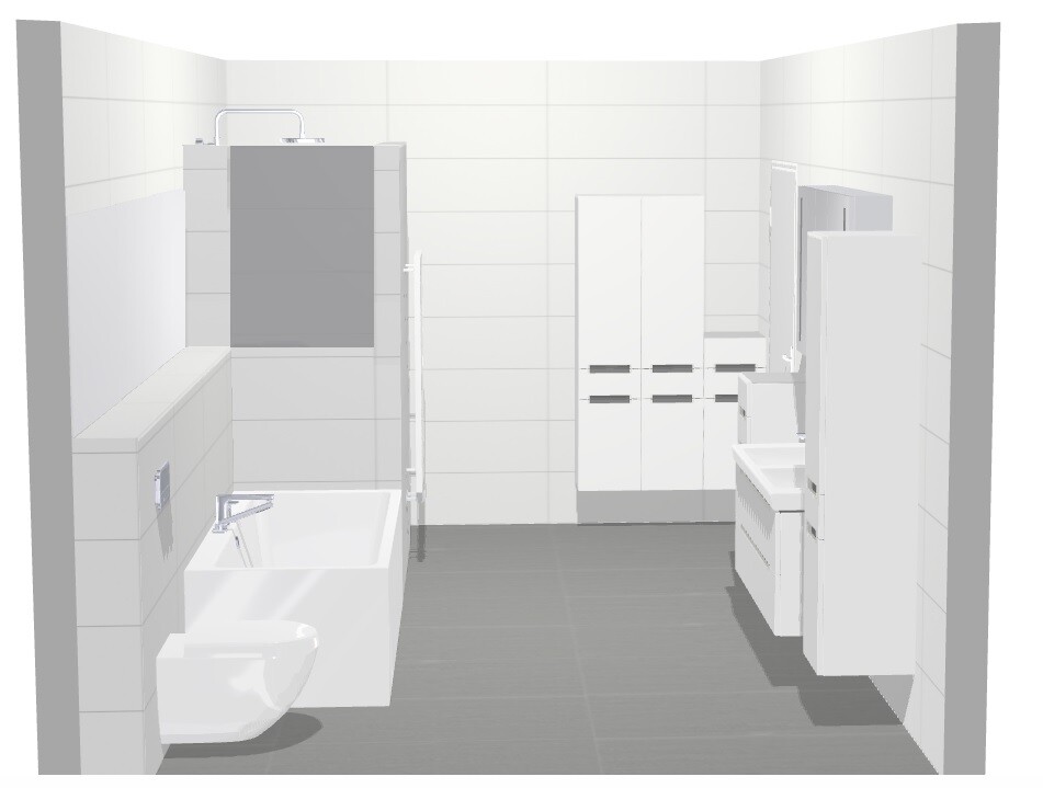

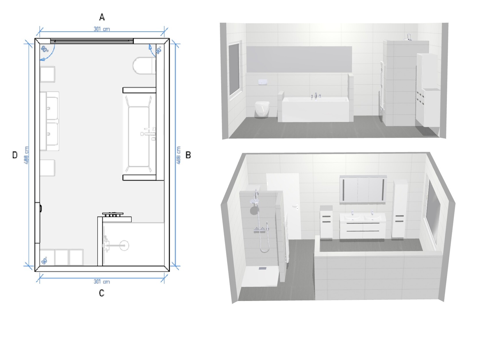

We have nearly completed the design of our town villa. However, I am still unsure about the layout of the bathroom on the upper floor. Because of the ventilation pipe from the toilet flush, a wall cladding will be necessary, which I find less than ideal. What do you think would be the best way to handle this? I would appreciate any tips and suggestions, and am also open to alternative floor plan options.

kaho6745 Apr 2018 09:56
I think it looks very nice except for the dark shower; I always prefer glass there, at least for the upper half. But that conflicts with your towel holder – only one of the two can work.
5 Apr 2018 12:14
I would attach the shower screen to the bottom wall of the room and make the partition at the bathtub only about 1.60 meters (5 feet 3 inches) high.
It goes without saying that the fixtures have to be mounted on the room wall, so the low partition “above that,” i.e., above 1.60 meters (5 feet 3 inches), would have no contact with water.
This would ensure moisture ventilation and natural light.
Instead of 1.60 meters (5 feet 3 inches), you could also use the shelf height on the right-hand wall, for example 1.30 meters (4 feet 3 inches). If the shower reaches the full length of 2 meters (6 feet 7 inches), this height would be perfectly sufficient. [emoji4]
Sammydog
5 Apr 2018 13:20
2m (6 ft 7 in) would not fit because of the passage. Maximum 130cm (51 inches). This way it could also be designed.
Although it looked more harmonious before.

5 Apr 2018 13:47
Sammydog schrieb:
2 m (6.6 ft) would not be possible because of the passage. Maximum 130 cm (51 inches). That’s how it could be designed.
Huh? Given the proportions in #18, that should be about 2 meters (6.6 ft), right?!
The latter is a complete waste of space in the room, while the shower is smaller.
Sammydog
5 Apr 2018 14:07
The wall measures 488 - 85 toilet - 180 bathtub - 75 passage - 12 partition = 136 cm (54 inches).
It could also include a glass partition integrated on the front side.

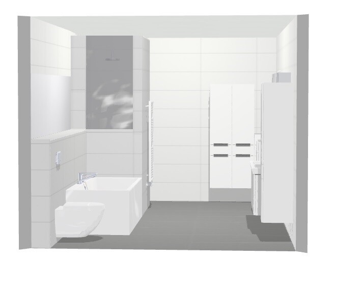

Sammydog
5 Apr 2018 14:29
At a height of 220cm (87 inches)
