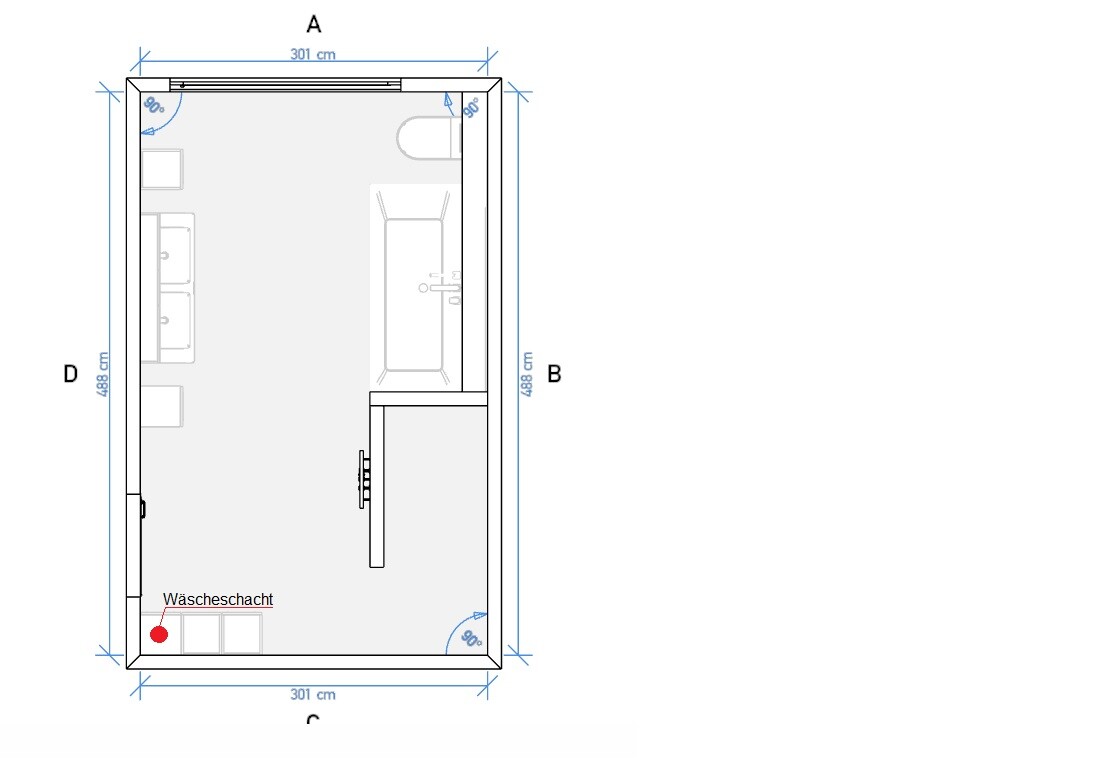

We have nearly completed the design of our town villa. However, I am still unsure about the layout of the bathroom on the upper floor. Because of the ventilation pipe from the toilet flush, a wall cladding will be necessary, which I find less than ideal. What do you think would be the best way to handle this? I would appreciate any tips and suggestions, and am also open to alternative floor plan options.

For example, like Katja has drawn it [emoji4]
As a user, you can’t always invest a lot of time, otherwise there would be sketches flying around all the time here [emoji6]
By the way, there are good bathroom planners online that even inexperienced users can handle well, for instance from Villeroy & Boch
Edit: I would, however, place the washbasin and bathtub opposite each other to create a more intentional layout rather than just lining them up. The bathtub and built-in shower should then be aligned, of course

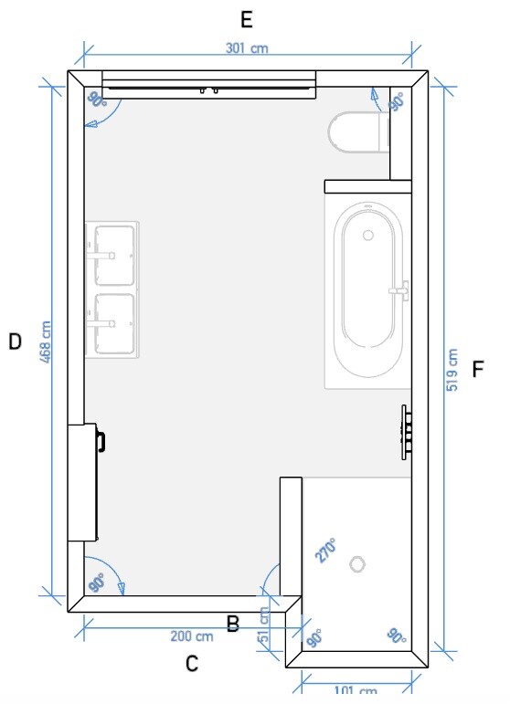

Thank you, Katja, we like this version best so far. I redesigned the room and adjusted the floor plan.

In the first post, the room length is 488cm (192 inches). In my opinion, it is not necessary to make this recess. I would rather double the shower wall towards the child’s room to help reduce the noise from the shower. The shower entrance would then be from the left side of the plan, not from the top.

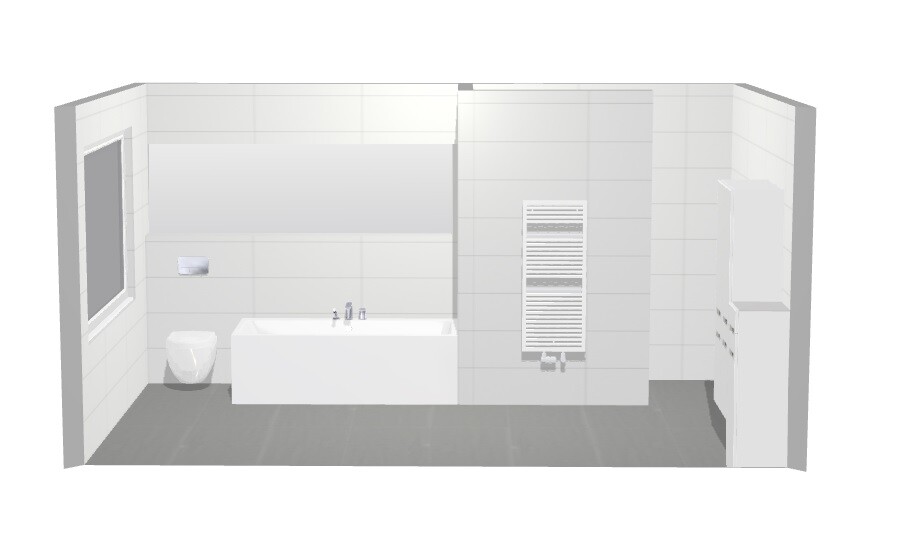

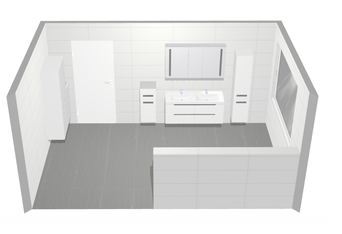

I think this would really be the best option, what do you think? I find it both functional and visually appealing this way.

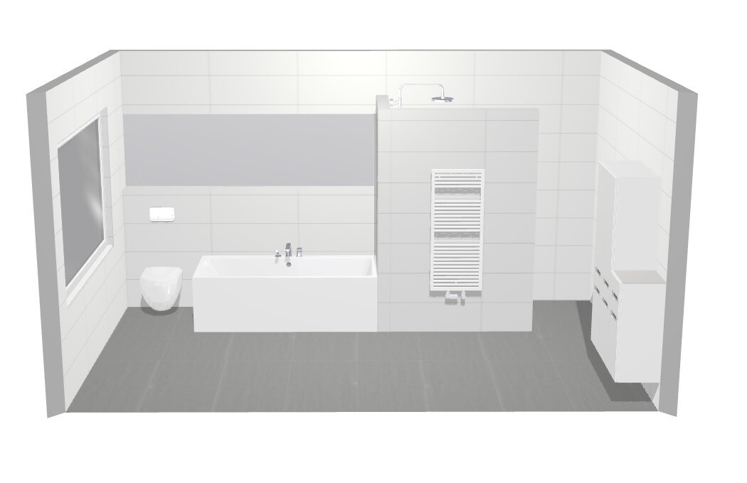

Above the bathtub, a 20cm deep (8 inches) wall is created due to the toilet flush tank, which can be decorated. The mirror, over 2m (6.5 feet) long, adds depth to the bathroom. Wall niches will be installed in the wall behind the bathtub.

Shower partitions at 220cm (7 ft 3 in) for a bit more natural daylight
