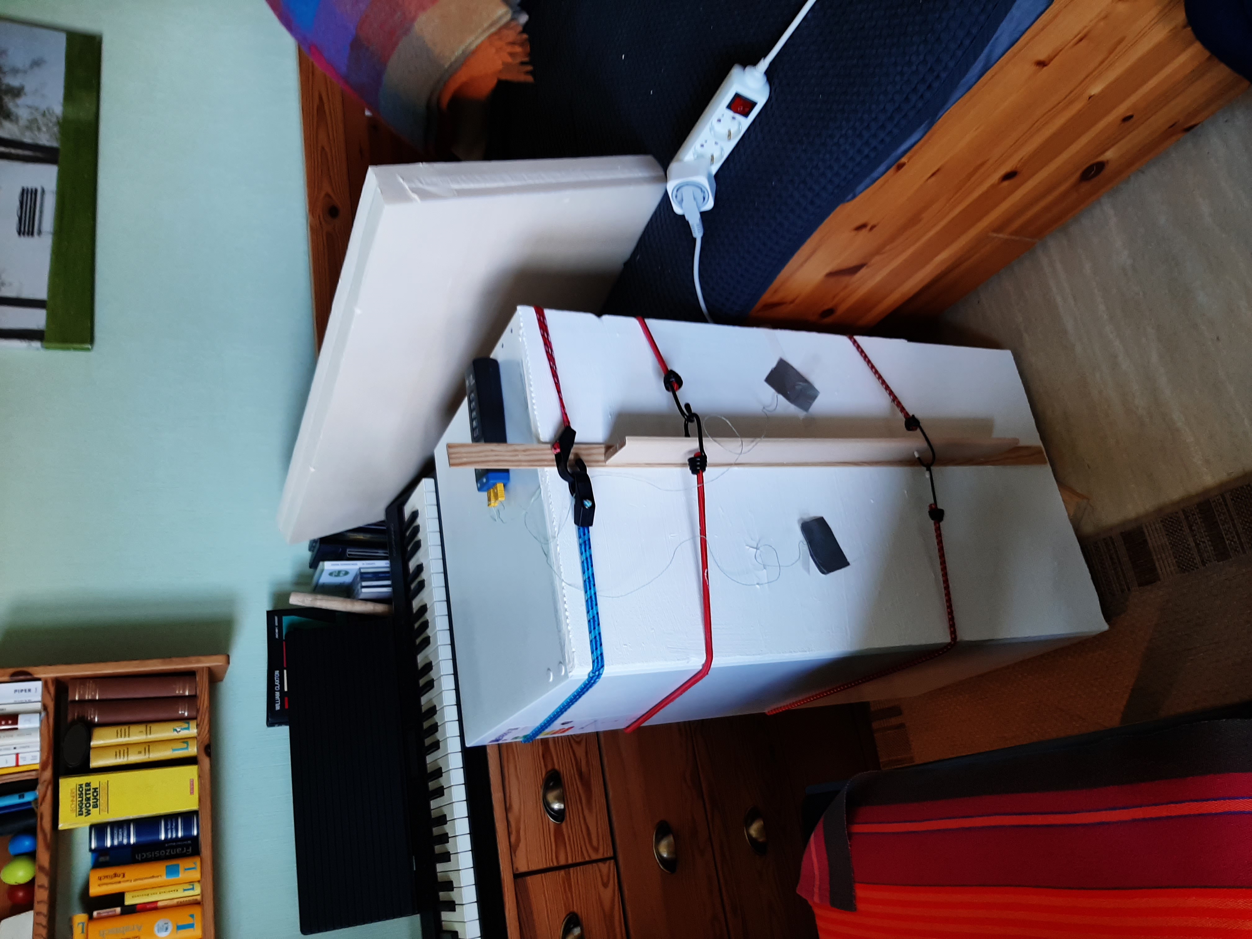

Hans Hille24 Jul 2024 23:28We have been considering PSCoat for years – the idea is great, even if not new – but what about the results?
I received a sample pack and conducted a simple test series:
I removed the door from a small refrigerator and placed different insulation boards in front of it, measuring energy consumption.
It was interesting to see that a 60mm (2.4 inch) XPS board actually required only half the energy compared to a 20mm (0.8 inch) one – not scientifically precise, but directionally correct.
Finally, I applied a generous layer of PSCoat to the 20mm (0.8 inch) board and found that the energy consumption was the same as with the board without the coating! It can happen! Forget about it!

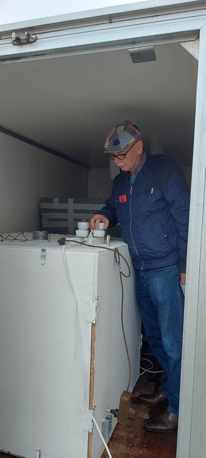

After a long time, here is some feedback.
Mr. Hille had good intentions, but unfortunately the presentation is not entirely accurate.
I can gladly connect you with customers who have set up functional tests or have significantly reduced their bills.
The described setup does not measure the thermal transmittance of a building component, but primarily the control behavior of a cooling system under highly distorted boundary conditions.
The compressor and condenser release considerable heat to the surroundings during operation (locally well over 100°C (212°F) on components). This heat radiation and convection directly affect the plates in front. What is mainly measured here is the feedback from the system’s own waste heat, not the steady-state heat flow through the plate.
Here is a picture of Mr. Hille’s scientific experiment and one that delivered the promised values (cube, MDF with PS coating, heated for two weeks in a cold room). I’m happy to facilitate contact between you.
