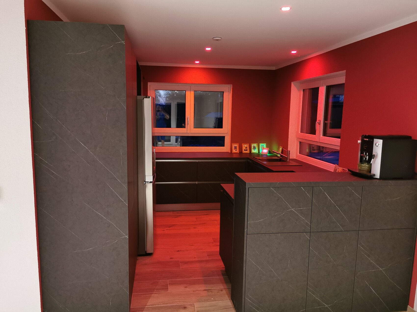

Our appliance isn’t fully built-in or boxed in, but on the sides I left only about 5cm (2 inches) clearance and personally see no problem boxing it in as long as the distances are maintained and “normal ventilation” (ventilation grille or similar) is provided.
Our kitchen installer advised us the day before yesterday against integrating our Samsung side-by-side refrigerator into the main kitchen cabinets. In 100% of cases, it looks awkward because the unit has to protrude to open the doors. Alternatively, if you have a free wall, you could build a drywall enclosure to integrate it. That looks fairly acceptable, but if something goes wrong with the fridge and the next one doesn’t fit exactly, you’d have to break open the wall. However, that would still be less expensive than changing the kitchen units. Therefore, our Samsung will probably be used as a discreet beer cooler in the pantry, and we will stick with (built-in) standard sizes.
