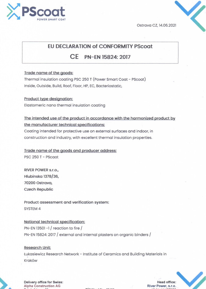

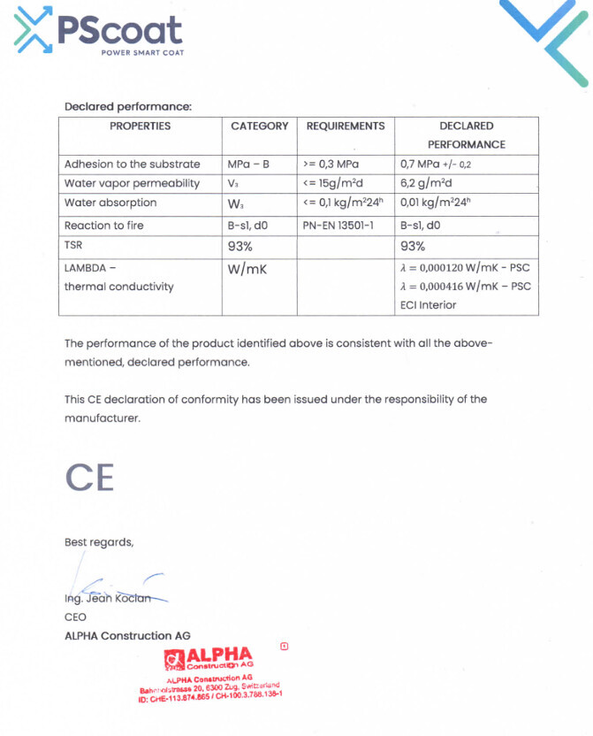

KarstenausNRW23 Dec 2022 09:16I now have the CE declaration, but there is no performance specification available. A few inconsistencies concern me, such as the incorrect font used for the CE mark and the fact that the declaration is in English. It must be submitted in German. The last two digits of the year when the CE marking was first applied are also missing. The reference number of the performance declaration is absent as well. The harmonized standard with edition (e.g., EN...) or the indication of the EAD is not included, nor is the four-digit number of the notified bodies.
Aside from that, it looks good 😉 .

KarstenausNRW schrieb:
I now have the CE declaration, but there is no performance specification. I am concerned about a few inconsistencies, such as the incorrect font used for the CE mark and the fact that the declaration is in English. It must be submitted in German. Also, the last two digits of the year when the CE marking was first applied are missing. The reference number of the performance declaration is also missing. The harmonized standard with version (e.g., EN...) or the indication of the EAD is not provided, nor is the four-digit number of the notified bodies included.
Apart from that, it looks pretty good 😉 .
If interested: I also have TÜV and ISO certificates, application instructions, and testing regulations available.
So, go ahead and order...

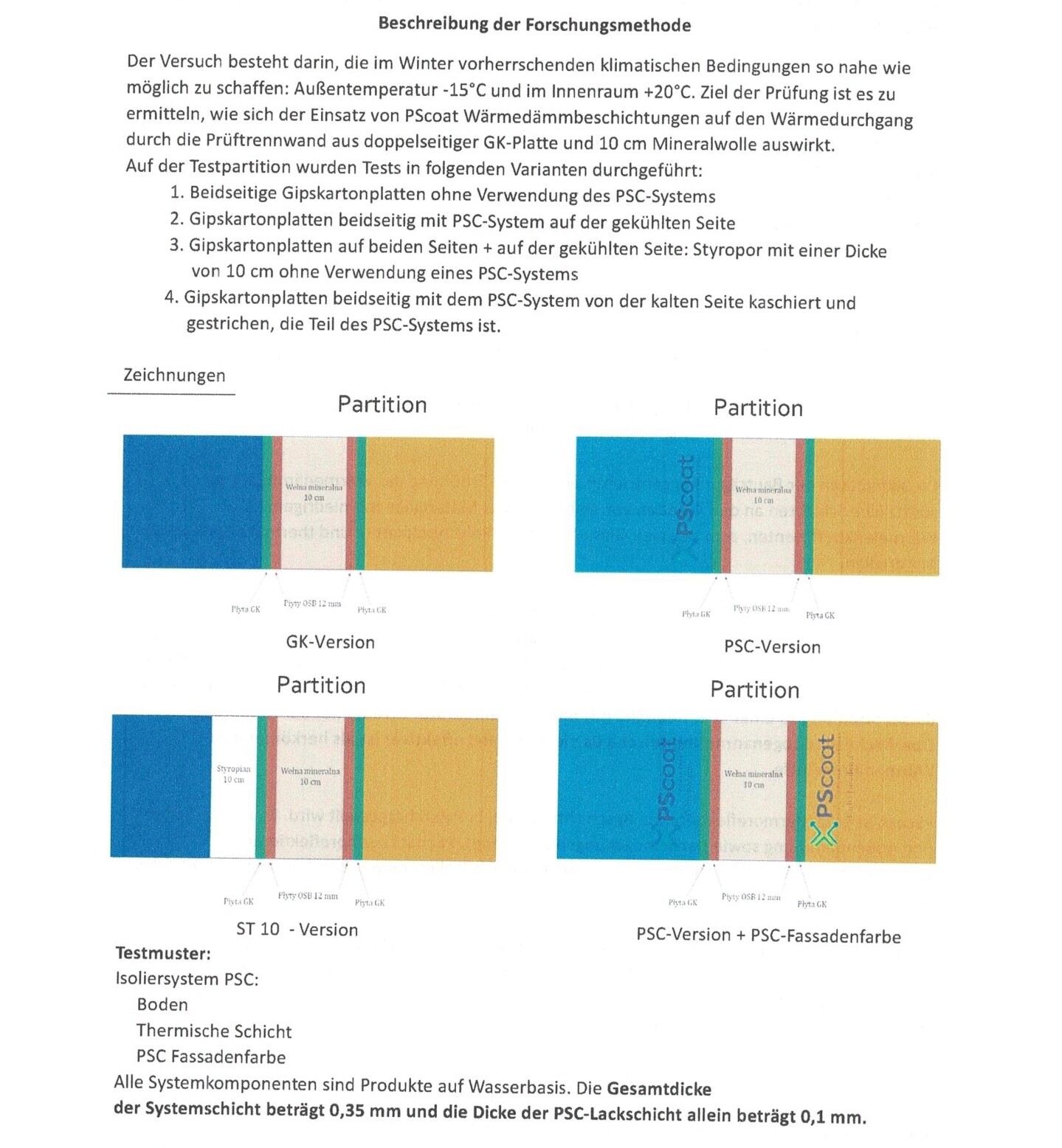

.[ATTACH alt="1671782721119.png"]77149[/ATTACH] Did you also receive references? By now, all tire vulcanizers worldwide, as well as many churches, warehouses, historic buildings, and so on, have been insulated with this...
I now have the CE declaration...

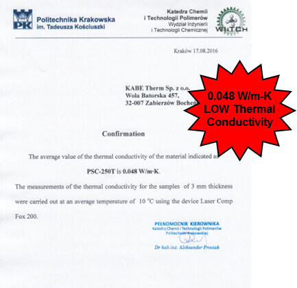

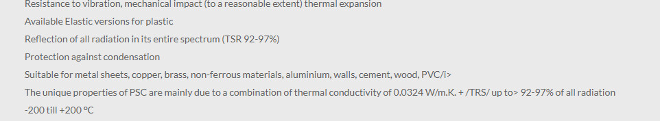

.[ATTACH alt="1671782721119.png"]77149[/ATTACH] I’m not doubting the existence of the product. It may be approved and perfectly fine, for example, for insulating hot metal surfaces. But the thermal conductivity value (lambda value) promoted by Adam is not realistic. In my opinion, it has been manipulated in the "CE certificate." Why else would the font change in an official document at the “controversial” parameter?
And why does the manufacturer state a different value for the same product in their brochures?
KarstenausNRW23 Dec 2022 10:47Adam2112 schrieb:
Did you also receive references? I did, but almost exclusively for industrial applications. In residential construction, there are only a few photos, none of which show any details.
The references, as far as can be seen, are from 2016/2017. Furthermore, they are only from Poland/Czech Republic/Slovakia and Thailand. Apart from that, they are unverifiable, as there are no references regarding the application, the product, or the users.
