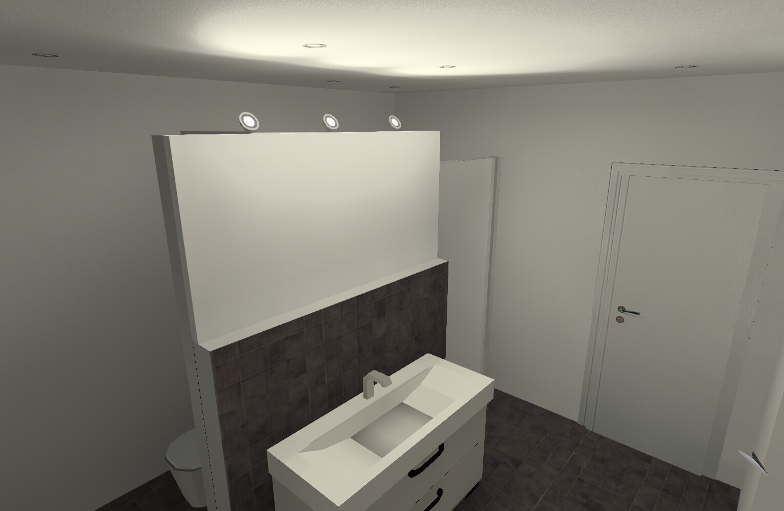

Now probably our biggest issue: the bathroom. Unfortunately, we are still not satisfied here:
The bathroom wall is planned to be about 2.20m (7 ft 3 in) high. I am considering that an LED strip could be sufficient for the general lighting here. I am still looking for an LED strip that can be somewhat directed. This would replace the four spotlights. Something similar, just with many small LEDs:
Toilet side: I also couldn’t find an alternative solution with a wall light or similar that really appeals to us.
There will also be a mirror light here.
The switch setup I imagine is as follows:
Double switch next to the door:
1. General lighting LED strip
2. Shower and toilet spotlights
Additional switch for a mirror light
Are there any other comments or tips?

Alessandro22 Apr 2020 12:50I actually quite like your original design for the bathroom. Make the spotlights dimmable to create a cozy atmosphere while bathing. Add a mirror light as well, and you’re all set.

True. Planning the bathroom lighting is not so simple.
Maybe as an idea:
Red: General lighting with spotlights and a wall light above the toilet.
Yellow: Task lighting (mirror light). There are several options here: pendant lights or wall lights to the left and right of the mirror, or integrated mirror lighting.
Green: Cozy lighting with dimmable wall lamps.
Not sure if it’s possible to connect the toilet wall light to two switches, so the lamp serves both as main and cozy lighting.
