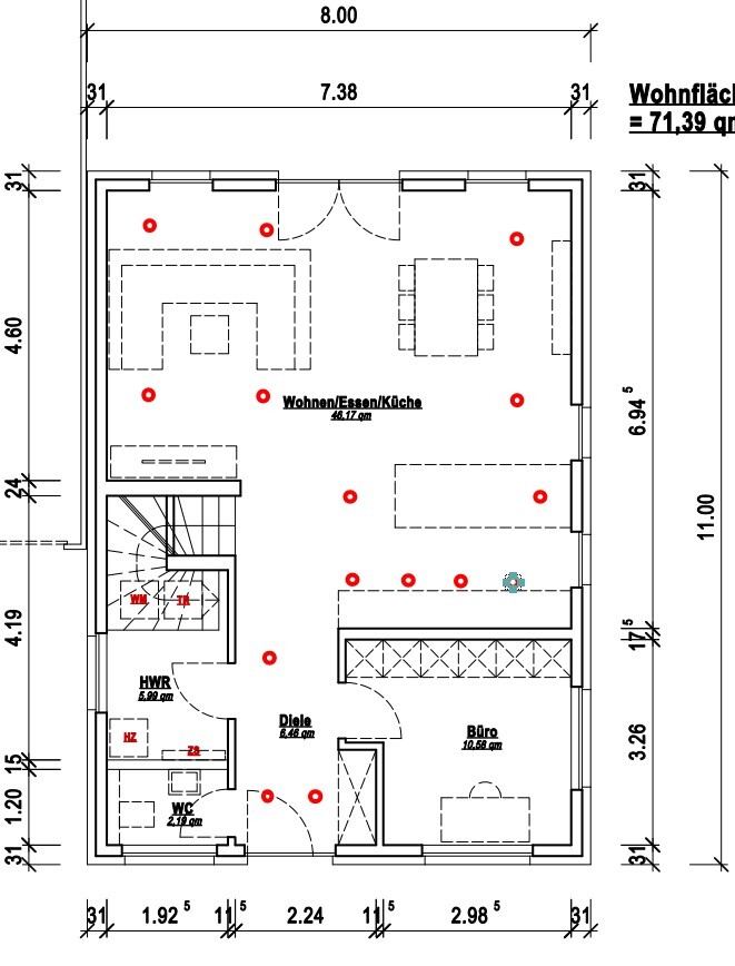

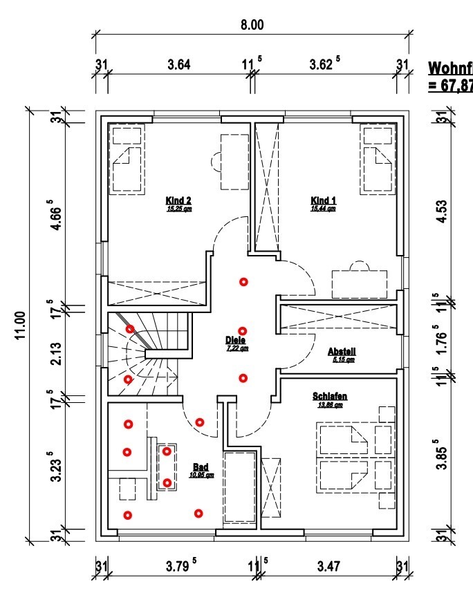

We are currently facing a challenging situation as we need to roughly position the recessed lights for our future house.
Attached are 4 images where we have tried to place the lights as accurately as possible, once with furniture layout and once with measurements.
We would appreciate some feedback so we can finalize this topic.
Rooms with recessed lights are:
Ground floor:
- Living room: These lights are mainly for illumination when cleaning. For dining, there is a regular ceiling light and some corner lights for ambiance. Possibly dimmable for events.
- Kitchen: These are intended to illuminate the work surfaces. The range hood above the kitchen island will have a light as well. On the side wall, there are tall cabinets with refrigerator, oven, etc. Possibly dimmable for events.
- Hallway: These lights are solely for illuminating the hallway. We want to manage without any additional light sources here.
Upper floor:
- Staircase: For basic lighting of the stairs, with a motion sensor. Possibly dimmable at night.
- Bathroom: These lights provide full lighting of the bathroom. Possibly dimmable for a relaxing bath.
We look forward to your suggestions and advice.
Thank you very much!

mambo198810 Apr 2020 11:59Hello everyone,
we are currently trying to recreate everything in DIALux. This will take a bit longer, so here is just a brief update:
- In the living room, we will probably place only 6 recessed spotlights in a rectangular layout. The hallway and kitchen will remain as they are.
- Staircase lighting on the side
- Upstairs is next…
Once I make more progress with the software, I will share some images. We still need to decide exactly which light fixtures to use.

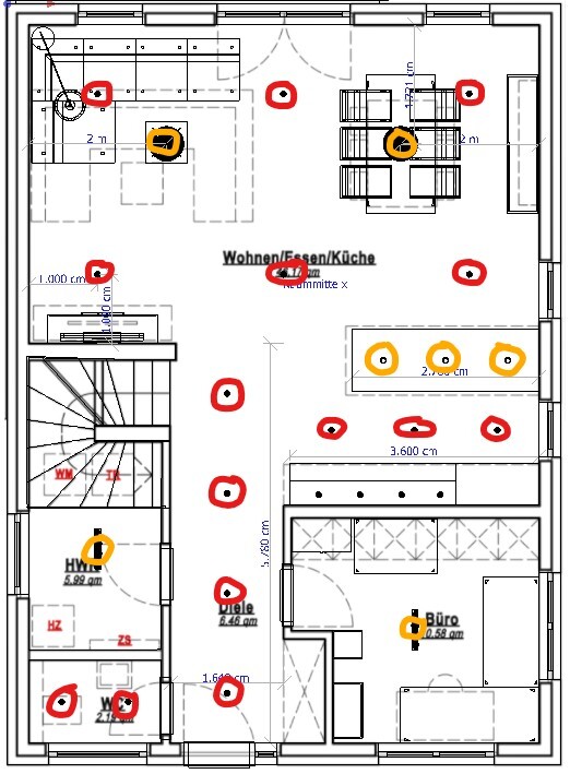

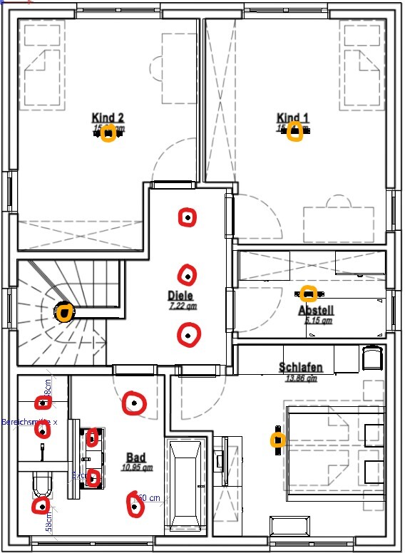

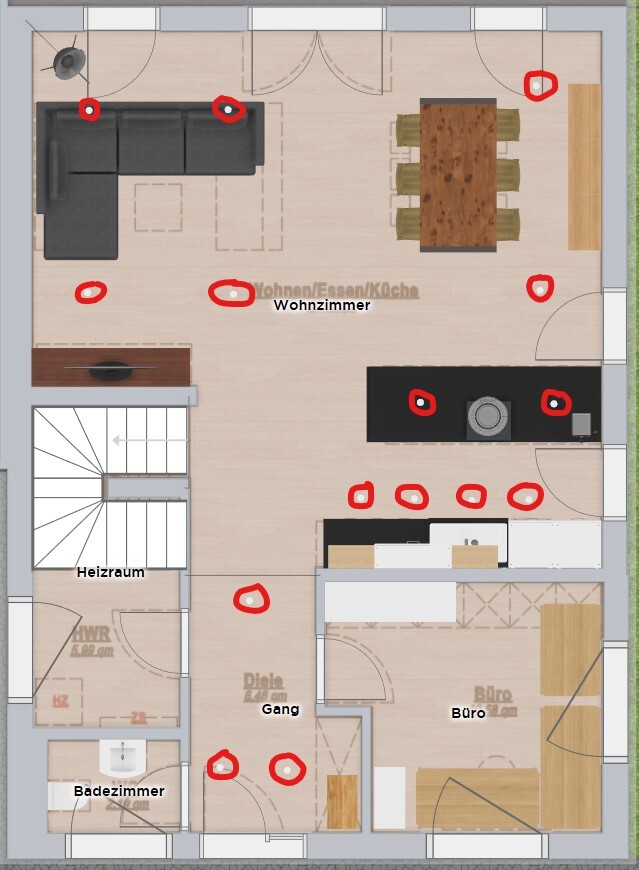

mambo198820 Apr 2020 18:39Hello everyone,
I have finally managed to recreate our future house in DIALux at a 1:1 scale.
Thank you again for all the suggestions and advice. We have tried to take many things into account.
Attached you will find the current plan. Spotlights are marked in red, and ceiling outlets are marked in orange.
Are there any further tips or suggestions?
Hello Mambo,
I have a few comments:
Ground Floor
Living Room: The pendant light and the lamp behind the sofa look nice.
Dining Room: The pendant light above the dining table is also good.
Living and Dining Room Spotlights: When will the spotlights be used?
Kitchen: Good.
Hallway: Good.
Stairs: Good.
Office: The lamp works well as general lighting.
I would definitely consider task lighting above the desk.
For example, diffuse, glare-free lighting on the left and right side of the desk chair, or at least a desk lamp.
Utility Room: Good.
Guest WC: Maybe add mirror lighting.
Upper Floor
Children’s Rooms 1 and 2: The general lighting is okay.
Additionally, extra lighting above the desks again.
It’s not very comfortable to work with the light source behind your back.
Hallway: Good.
Storage Room: Are tall cabinets planned there?
Bedroom: General lighting is fine.
Don’t you want lamps on the left and right sides of the bed?
Either pendant lights above the bedside tables or wall lamps.
Bathroom: I still believe that in the toilet area a stylish wall lamp with pleasant light would be better than a spotlight.
Shower is fine.
By the mirror above the washbasin, definitely add frontal lighting.
The spotlights would be directly above the head. This is not very flattering and creates ugly shadows under the eyes, nose, and chin.
Best regards, AMNE3IA
