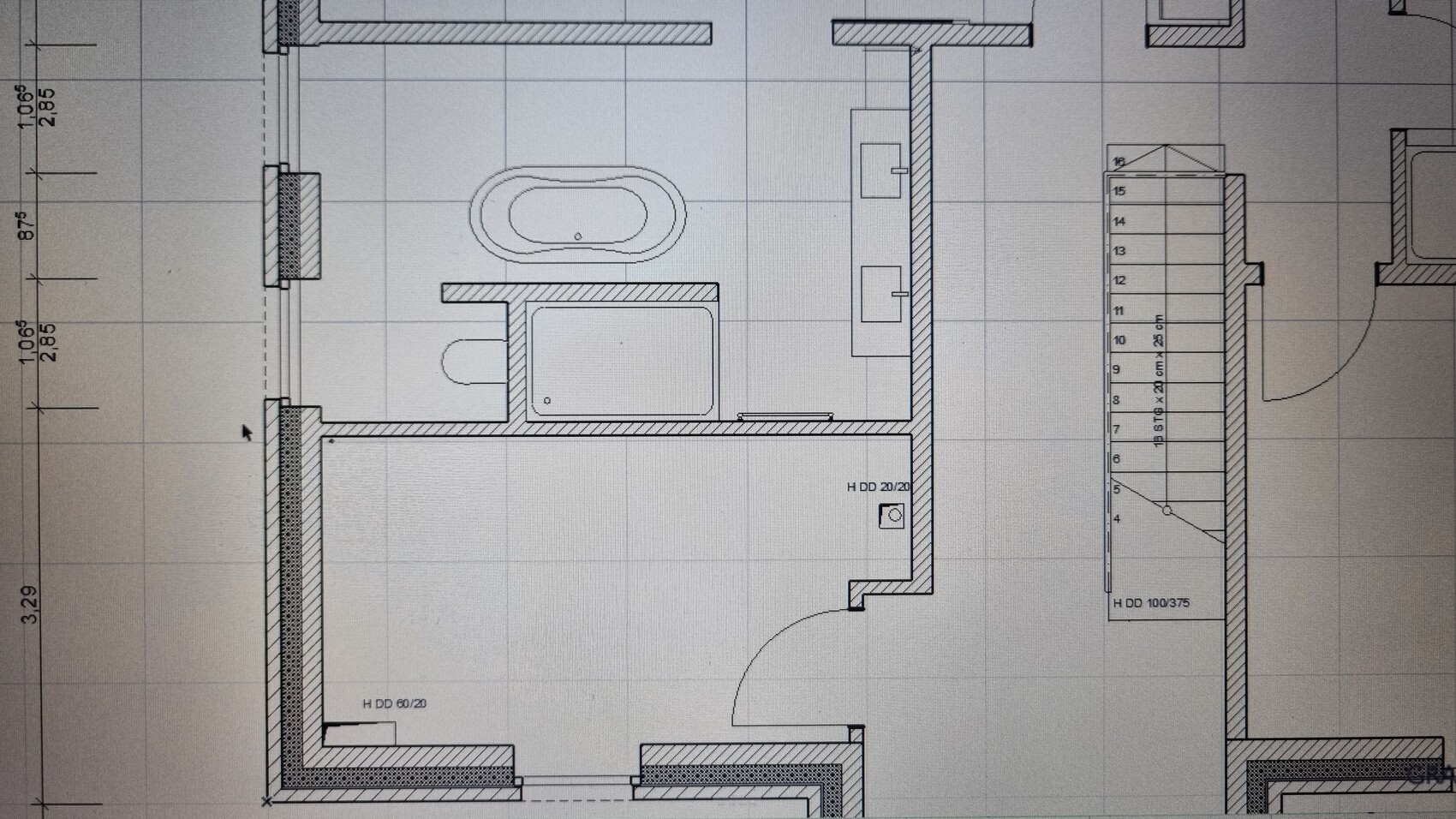

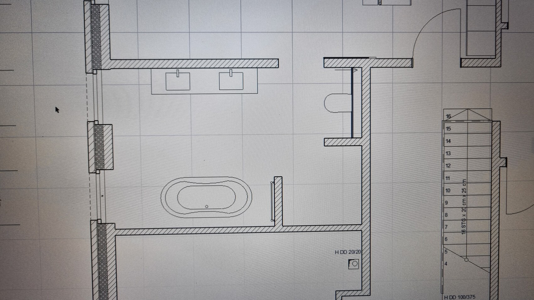

Here are two possible options again.
Floor plan of a bathroom with bathtub, double sink, doors, and walls.
Floor plan of a bathroom with bathtub, toilet, and sink, next to a staircase.

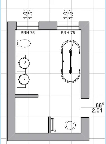

K a t j a20 Apr 2023 22:46
Hmm, with the first option you would fly right over the toilet and its occupant when entering. Option 2 feels too cramped and oppressive, and it’s too dark near the washbasin.

K a t j a20 Apr 2023 22:52
Edit: In option 1, it’s also questionable which way the door should open. Towards the throne occupant’s kneecap, for example, or in a way that blocks access to the room. Or outward—then the bedroom furniture layout needs to be considered. Just noticed—a sliding door in the bathroom? Really? Has anyone tried that before?

And the bathroom... I still think the solution from @Ibdk14 is the best. Then the windows can be opened at a maximum angle of 45° (45 degrees). Not ideal for cleaning the windows, but otherwise, they would hardly be opened at all.
Grundriss eines Badezimmers: Doppelwaschtisch links, Badewanne rechts, Toilette unten, Tür.

K a t j a schrieb:
Option 2 feels too cramped/claustrophobic to me and too dark at the washbasin.
Where exactly do you think it feels cramped?

K a t j a schrieb:
Too dark at the washbasin.
Is that serious? The room has about 5m² (54 ft²) of glass area.
Keep in mind, the bathtub is not floor-to-ceiling height, so plenty of light passes through.
Additionally, there is artificial lighting on the ceiling as well as directly at the washbasin.
