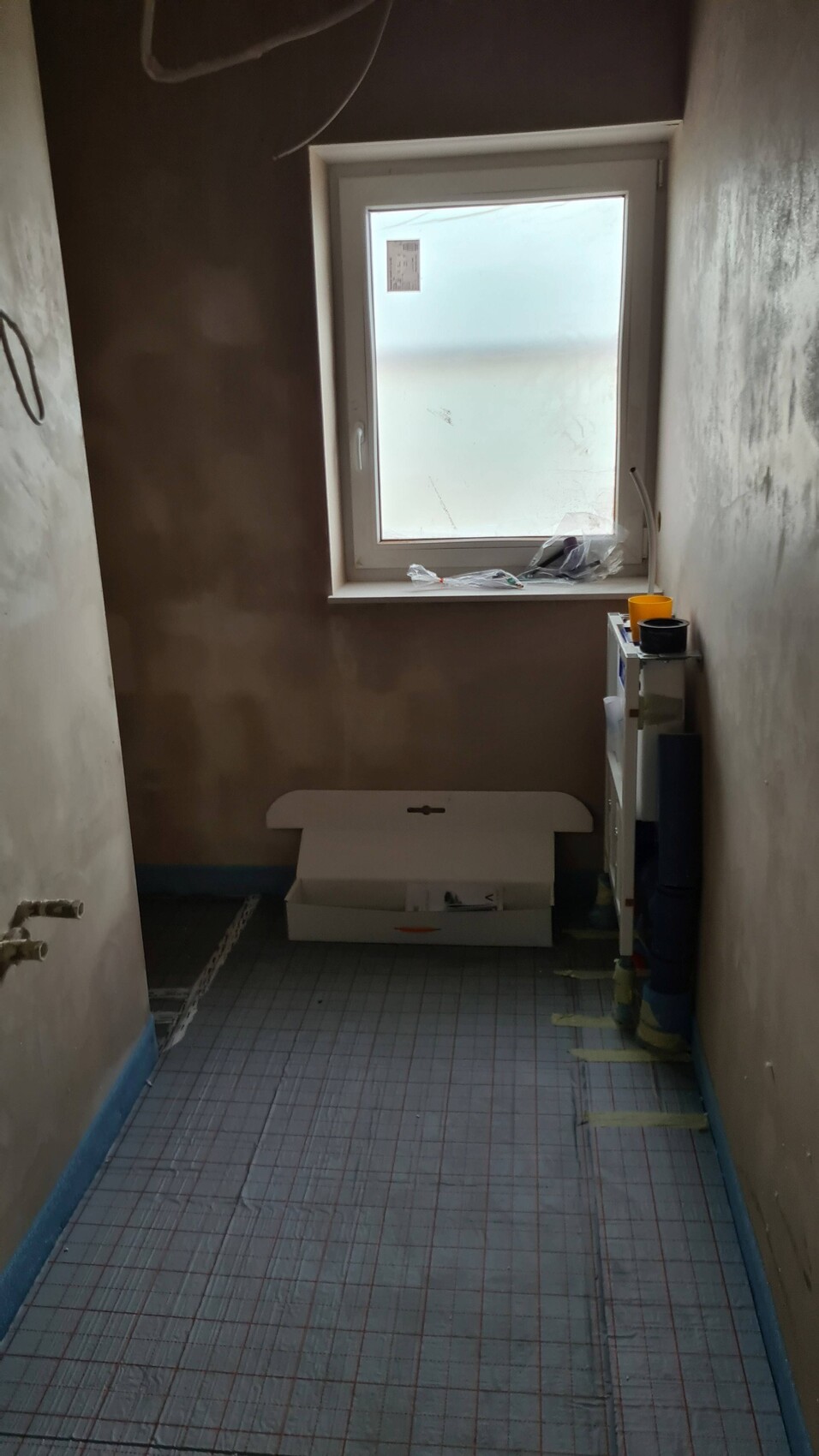

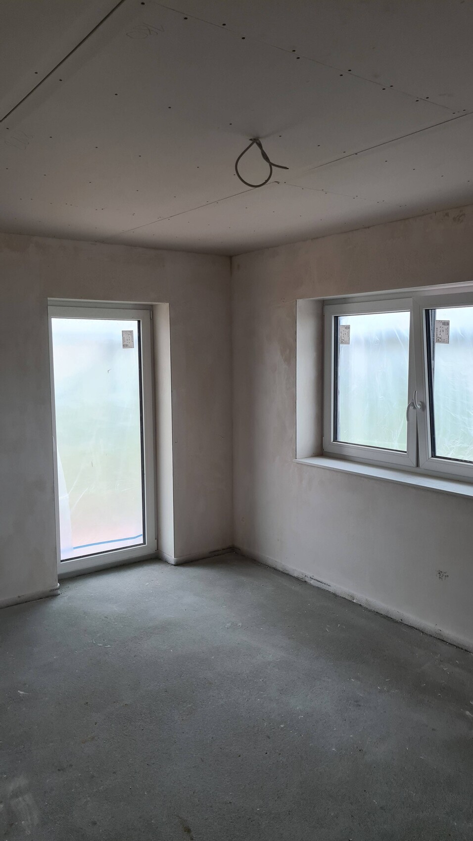

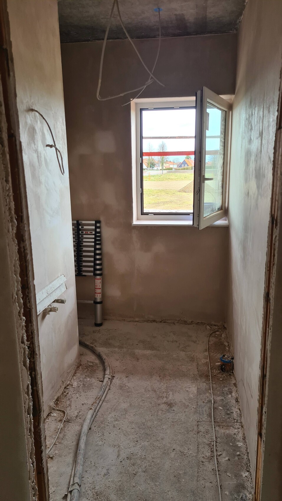

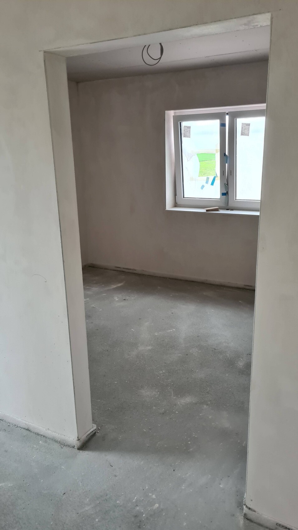

The windows have been delivered and installed. They look great until we noticed the position of the handles. They are not centered vertically but rather located in the lower third of the windows. Here are a few pictures:

I hoped so too, but somehow I keep noticing it again and again. Of course, you're currently very focused on it! You even started a separate thread in a building forum, so right now you’re probably noticing every handle in every house, which is completely normal. But you don’t even live there yet! Give the handles a few weeks to settle, and your hope will come true, I promise. 😉

But soon you won’t even notice it anymore.Hmm... When I read this thread this afternoon, I thought “that’s fine, nothing is standard,” ... and then I glanced at the window handles in my office, which are installed in a similar way. The room is very tall, and so are the windows, which works well in the office.
At home, I don’t have windows like that. Maybe we can compare with our bedroom window, although at the time we didn’t pay attention to the fact that the room height would only be 235 cm (92 inches). Thus, the window isn’t 126 cm (50 inches) tall but only 116 cm (46 inches). (By the way, we don’t even notice it anymore 😉 )
Anyway: A sill height of 100 cm (39 inches) seems quite high to me; our finished floor level is 85 cm (33 inches). So what do your 100 cm (39 inches) refer to exactly?
That would make a difference of 15 cm (6 inches) in height (our bedroom handles are at 115 cm (45 inches)).

Ceiling height is 2.58 m (8 ft 6 in) on the ground floor and 2.62 m (8 ft 7 in) on the upper floor.
The sill height is 1.00 m (39 inches) and the window height for the affected window is 1.26 m (50 inches).Is that the rough structural measurement? How tall exactly are those windows? It’s not a defect. Since your room dimensions are custom, there is no standard measurement related to the frame, only with respect to the general height.

To me, the handles look completely normal. On both our old and new windows, the handles are also not in the middle but positioned lower down. I think once your house interior is finished, you probably won’t even notice it anymore. Keep your chin up—there are definitely worse things on a construction site!
