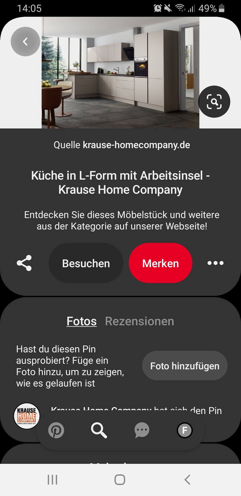

Well, I would probably not integrate the refrigerator, but place it on the left wall behind the sofa.
Then place the two tall cabinets side by side in the upper left corner, next to that the run with the sink, followed by a peninsula facing the dining area. So basically an L shape at the top.
That would open up the area behind the sofa—but of course, this is a matter of personal taste. I find that islands like these simply don’t look very good in small rooms.
The drawers should be enough for two people; in my opinion, the drawer for oil and such isn’t really “needed.” It’s nicer to have a decorative container on the island instead.
So, just mirrored:
