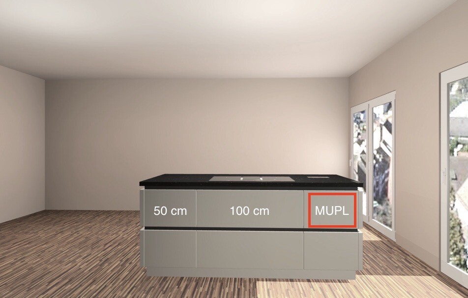

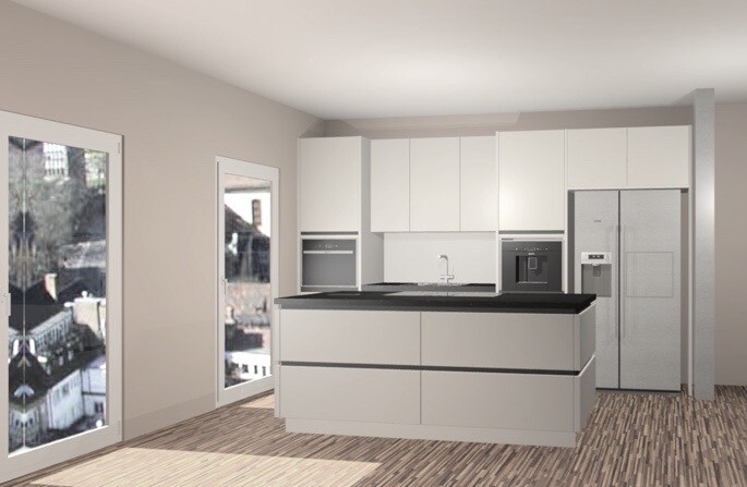

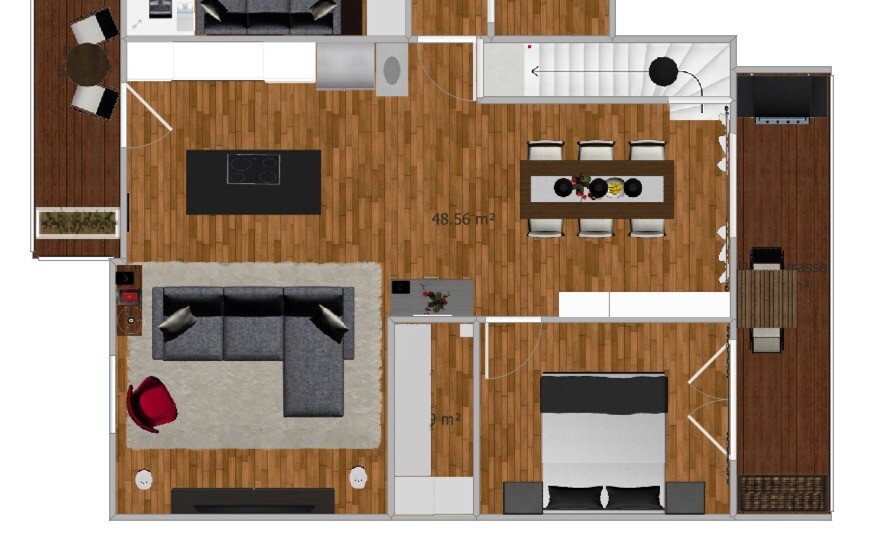

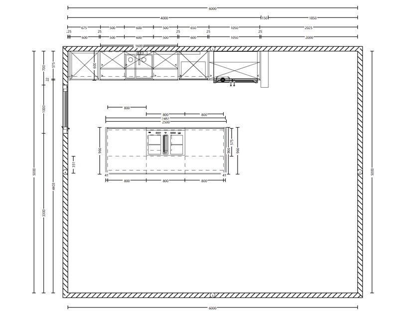

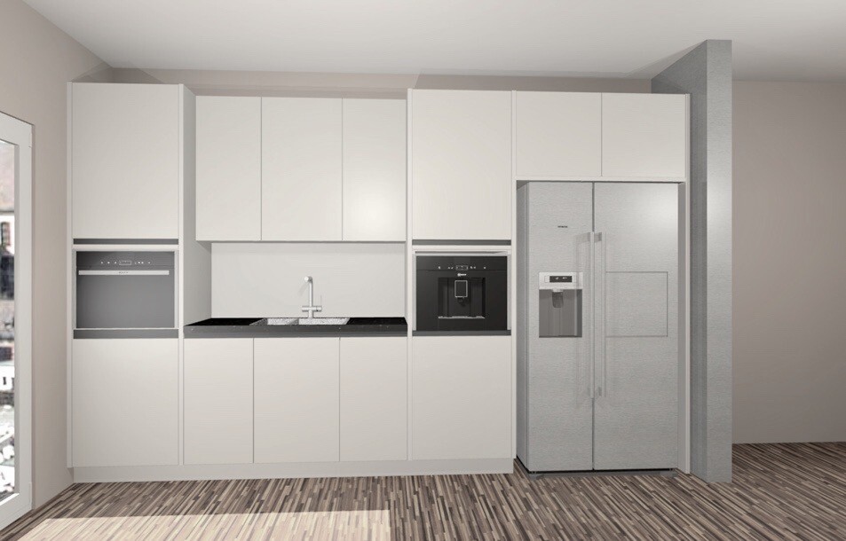

I would appreciate some critical feedback on my kitchen layout.
Attached are rendered images and the floor plan of the living and dining area.
The goal was a modern kitchen without a high-end focus for a two-person household.
The color is light gray and the countertop is matte granite in a cloudy anthracite tone.
I definitely want to keep my side-by-side refrigerator, even though the next one will probably be a French door model.
The dishwasher is located in the lower left under the oven (which includes a steam function).
The island measures 2.00 x 1.00 meters (6 ft 7 in x 3 ft 3 in). The distance between the kitchen row and the island is about 1 meter (3 ft 3 in).
The initial design sketch showed a wider island, but we adjusted it on site because it would have been too bulky.

Why place the base cabinet with the waste system near the cooktop? You usually need it, for example, when preparing vegetables at the sink or when disposing of scraps taken out of the sink.
Sabine
Tarnari18 May 2020 23:31
I find it interesting how different the behavior patterns are. We never cut food over the sink, always on the cooktop. We also never leave scraps in the sink, unless we specifically want to soak something there, which is very rare. Still, we keep the trash under the sink.

Honestly, I don’t see the need for us. I always chop on a board on the island. I put the scraps on a paper towel while I’m working. When I’m done, I fold the four corners together, turn around once, and toss it in the trash under the sink.
I find it more practical to have the trash there just for space reasons. Because of the siphon, you can’t really use the full base cabinet anyway.
