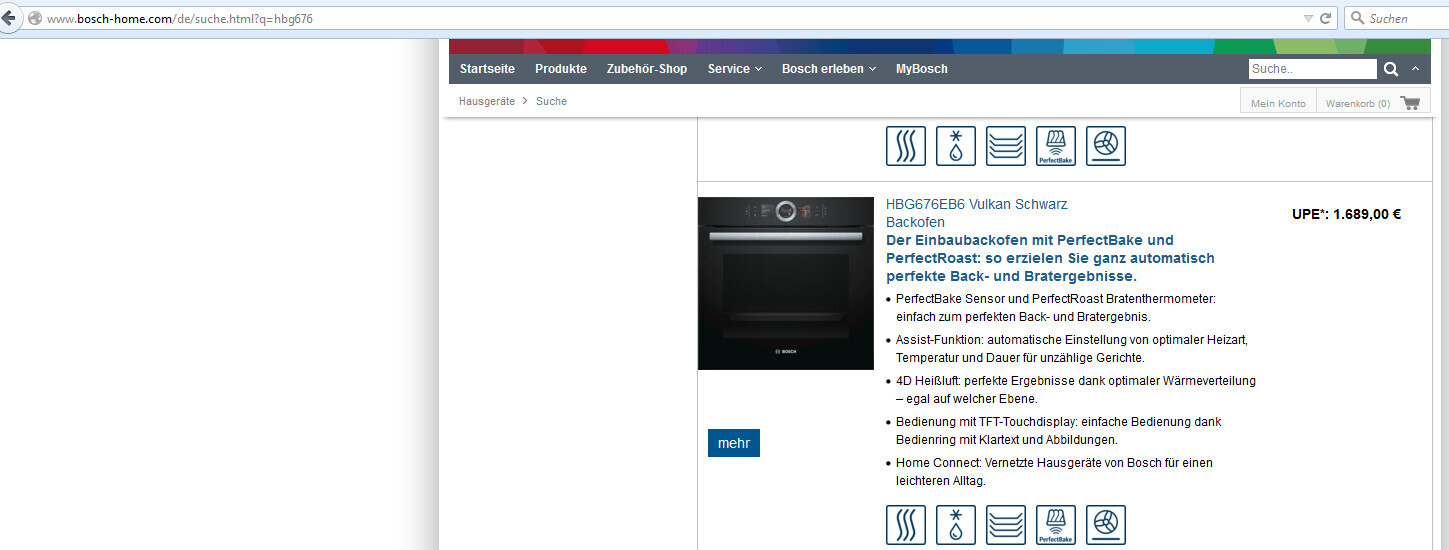

When choosing the oven, we are now sure it will be one of these three models, depending on the current price/performance ratio during the kitchen consultation...
Siemens iQ700 HB678GBS6
Bosch Series 8 HBG676EB6
Bosch Series 8 HBG675BB1 (slightly cheaper than the other Bosch, without touch controls & Wi-Fi)

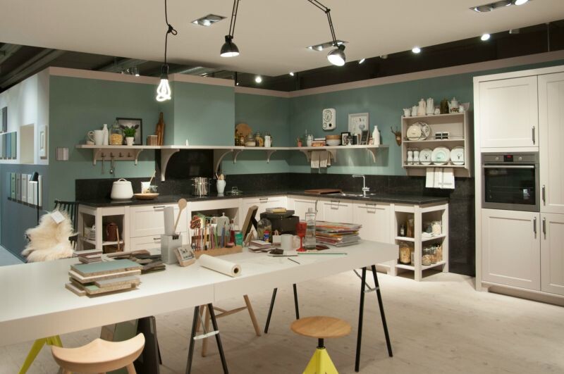

For the extractor hood, for aesthetic reasons, we would prefer a design like the one shown in the photo. These angled hoods that look like a TV don’t really suit our planned country-style kitchen. However, our question is what technology is typically used for this type of solution and whether these are good or rather inferior – or whether it might actually be better to choose one of those angled designs?
