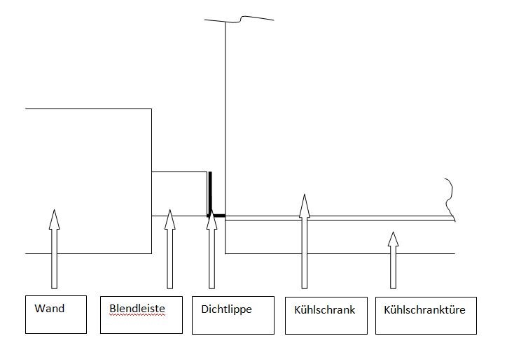

As @Bauexperte writes, it involves some effort, but it’s doable. I tried to illustrate how it might look.
Sketchy kitchen view with wall, cover panel, sealing lip, and fridge door
kbt09
2 Mar 2016 17:07
But then the trim strip would be set back from the wall – right, Sigi? That would also create a different effect than the frame of the utility room door.
Honestly, I think that's a bad idea, especially if it means installing a standard door at a lower height than usual.
And next time, the 202 cm (6 ft 7.5 in) tall freestanding unit won't fit in the niche.
