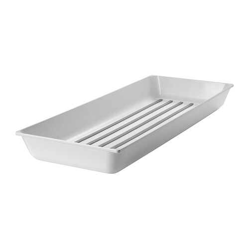

Now I no longer have the 20cm (8 inches) drawer cabinet to pull out where I can store the bottles (olive oil, acetone, etc.). I keep my oil and other bottles in one of the large drawers under/next to the stove in a tray like this:
VARIERA
Spice insert, glossy white
The tray is placed on an anti-slip liner for the entire drawer. The bottles stay very secure when the drawer is opened at a normal speed. So far, no one has managed to knock them over. Of course, using dividers as suggested above also works well, but I wanted to store the bottles lengthwise, not crosswise.
