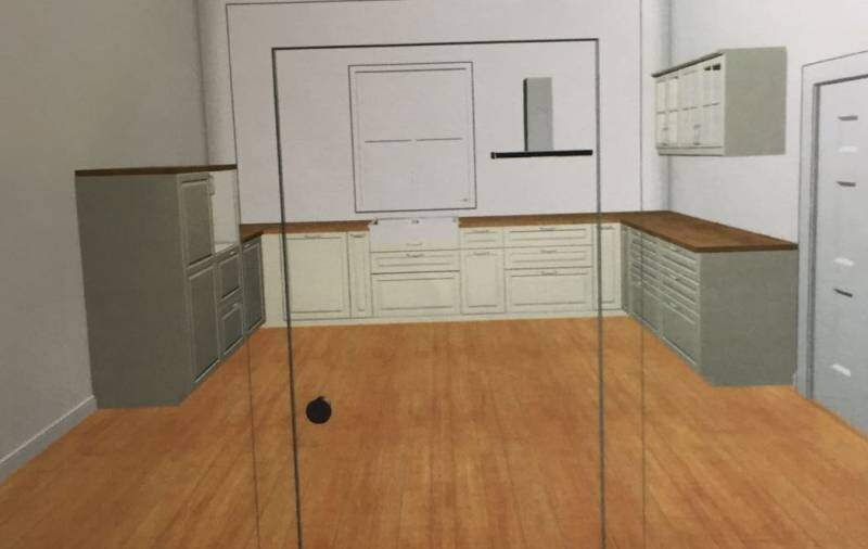

Edit: Here is the kitchen:
3D kitchen with wooden floor, light base cabinets, and glass front in the foreground
Currently, there is a 20cm (8 inches) cabinet between the sink and the dishwasher, but I’m more inclined to remove the 20cm and replace the 40cm (16 inches) cabinet to the right of the sink with a 60cm (24 inches) one. What do you think?

After planning, a cabinet is placed next to the sink, and the sink is centrally located under the window, which was mentioned as the most important point in the first post. The sink is no longer central if the 40cm (16 inches) cabinet is replaced with a 60cm (24 inches) one, which makes sense, though.
There is definitely still room for further optimization.
