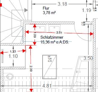

I am looking for some ideas for the bathroom.
Attached is a drawn floor plan. It is an existing building.
The wall to the children's room can still be moved. The room might currently be too large?
The wall next to the toilet is just an idea, as is the shower.
There is a sloping roof, and it is planned to have a double roof window.
So far, I am not really happy with my ideas. Maybe one of you has a great suggestion.
I would also like a large oval bathtub set in a built-up base directly below the windows.

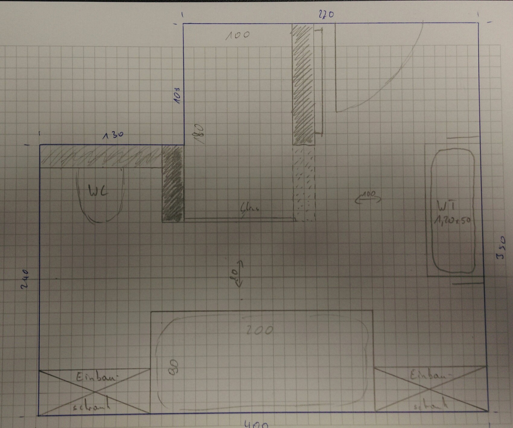

roadrun8715 Feb 2016 09:58Just an idea without considering the wastewater/water pipes yet (additional partition walls might be necessary – keep the slope in mind):
Instead of the glass panel at the end of the shower, you could also extend the shower wall (on the right side of the plan) further forward (dashed line).
In the plan, you now have a really large shower (100cm x 180cm (39 inches x 71 inches)) and a large bathtub (90cm x 200cm (35 inches x 79 inches)).
Next to the tub, for example, you could include built-in cabinets for towels and other items.
What do you think? I hope this helps you move forward.
R
roadrun8715 Feb 2016 13:27Wow, I really like this! Now I just have to hope that the connections and water supply can be arranged accordingly. The stairwell continues beneath the toilet area. But that's something for the plumbing specialists to sort out ;-)
