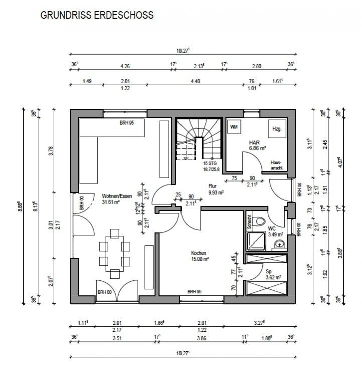

baumann201325 Oct 2013 17:06After careful consideration and several revisions, we have now had a floor plan created that suits our needs.
(Staircase faces north)

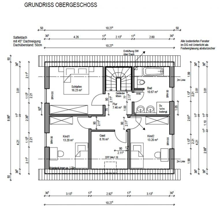

In the floor plans, the living area has now been reduced to 132 sqm (1,420 sq ft), which should also help lower the overall costs slightly. What do you think of the layouts? We are still not quite satisfied with the arrangement of the sanitary fixtures on the top floor. We want a walk-in shower with a built-up base, but as shown in the plans, it blocks a lot of natural light from the washbasins. Do you have any ideas for a different layout?
baumann201325 Oct 2013 19:19@Mycraft: We need the guest room for when we have visitors occasionally. We also want to use it to store the printer, folders, etc. Originally, we wanted an open-plan kitchen, which would have opened up the entire ground floor. However, we changed our minds because of cooking odors. Additionally, we need the extra wall for a large bookshelf.
nordanney25 Oct 2013 21:01ypg schrieb:
I would also swap the shower and washbasins as Mycraft suggests. Otherwise, the design seems functional and fine to me as a layperson. If you swap them, the shower’s side wall must not be built masonry either, because otherwise it would also lack natural light. Additionally, the door area could become very tight.
nordanney schrieb:
When swapping, the shower side wall must not be built as a masonry wall either, because then natural daylight is also missing. Additionally, the door could become very tight.Yes, the door is inconvenient, but so is the sink in that location. You could also have a shower with a spotlight above it...
Somehow, I find the three fixtures quite cramped along the wall.
Maybe you could move the bathtub to the exterior wall, shift the toilet to the 2-meter (6.5 feet) limit, and place the shower next to the toilet (relocating the door)?
