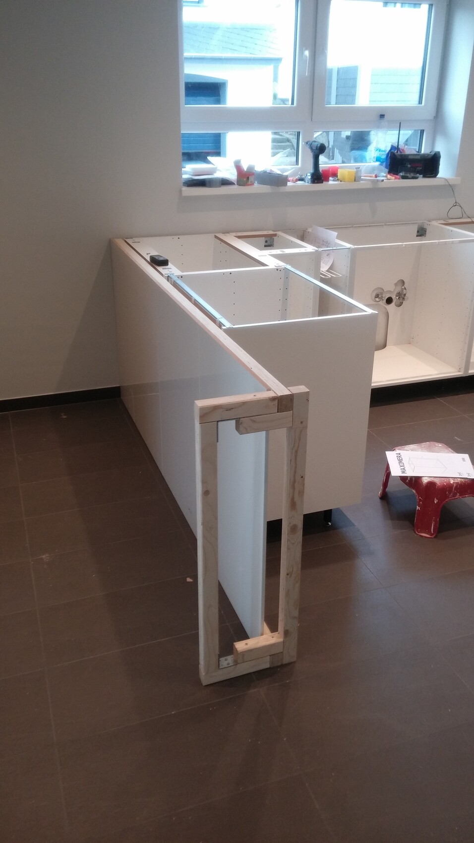

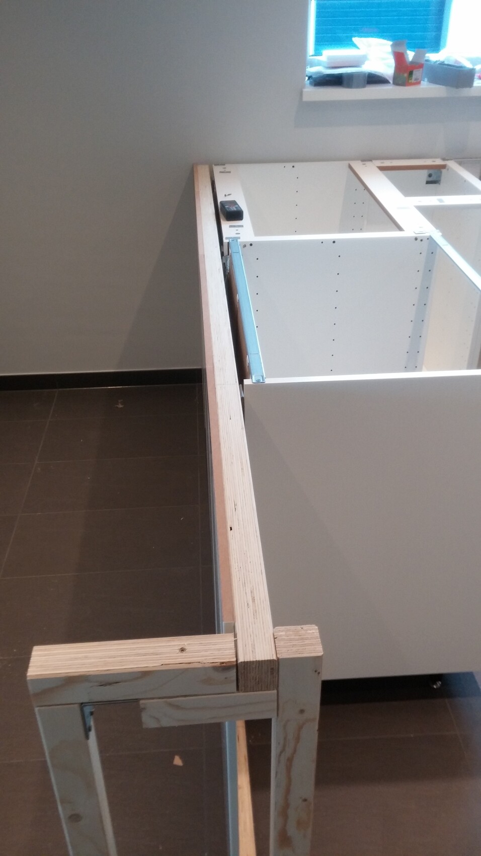

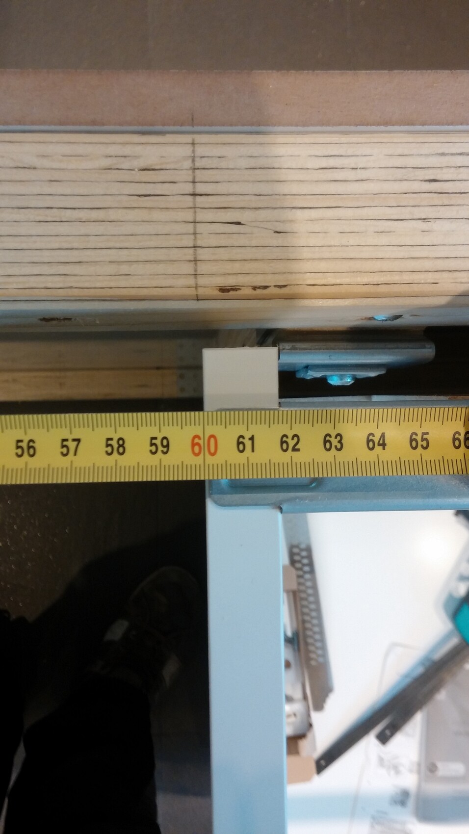

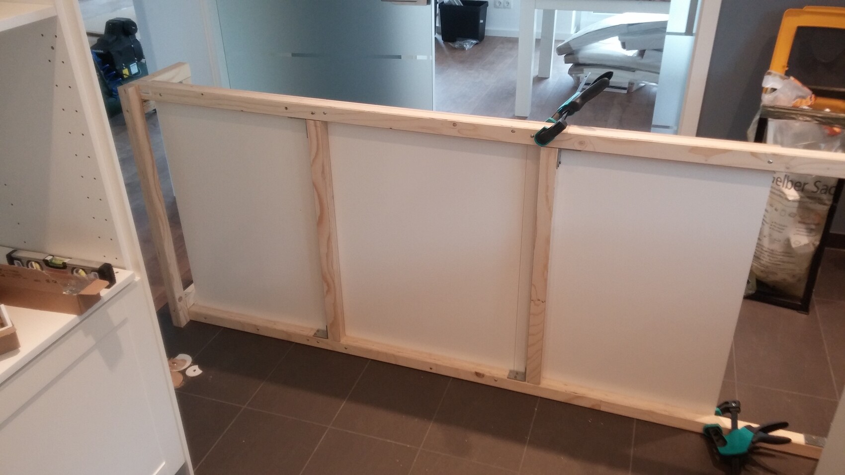

I built a subframe myself. The wood I used is from Hornbach, called WoodPro, and it is a laminated wood. Therefore, it is very dimensionally stable and straight.
In the end, the subframe looks a bit odd, but there is a reason for that. If I had placed the last vertical beam like the other two between the two long horizontal beams, I would have had to connect the front side panel to the frame exactly where my panel joint is.
Since the dishwasher is located in that area, I could reduce the full depth from 60cm (24 inches) to 55cm (22 inches) and was able to place the vertical support next to the frame instead... so except for the appearance, everyone benefits from this. Now it does not matter anyway – the dishwasher is installed, and you can’t see anything anymore.
The subframe is then screwed to the cabinet body at the original mounting points.

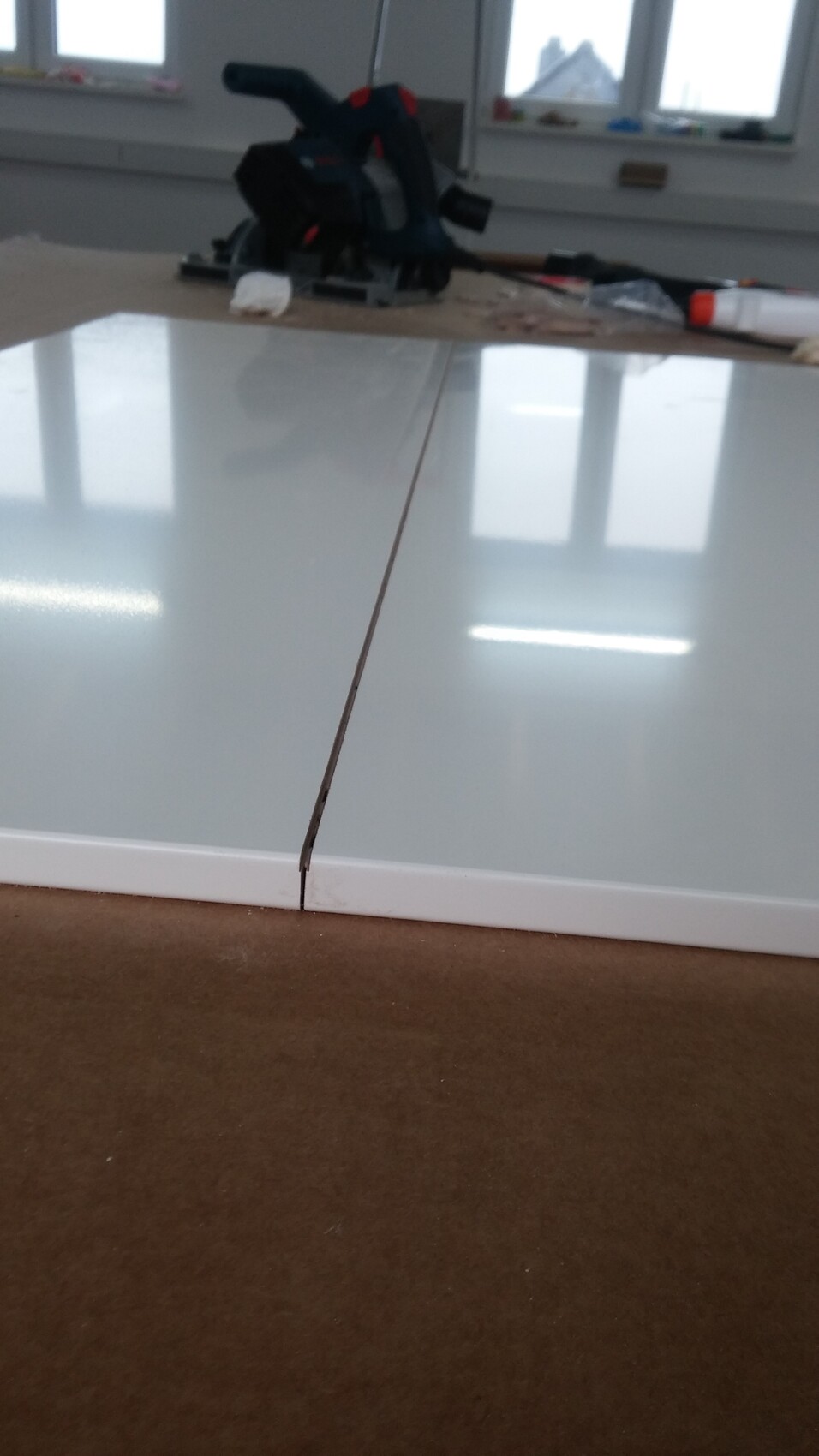

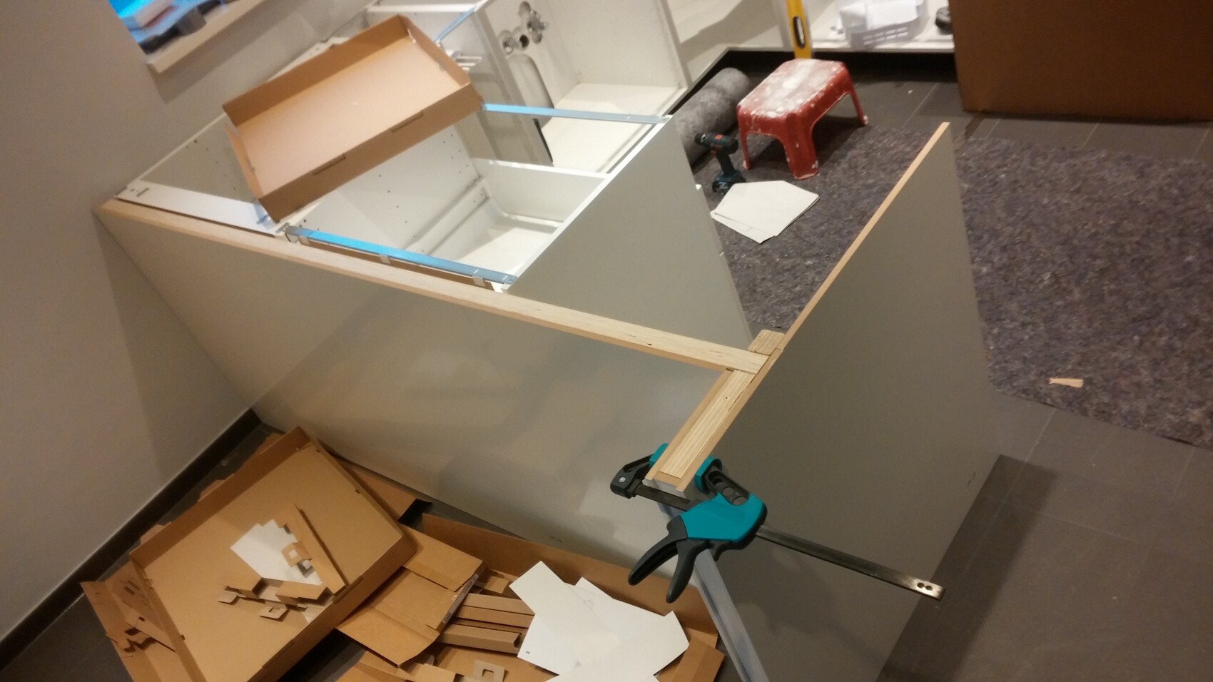

I made the cladding from side panels, which I cut to size using a plunge saw and guide rail.
The connection method for joining the parts, already mentioned by the IKEA expert, I only applied at the front side because I ended up with an overall dimension of about 86cm (34 inches), which I couldn’t achieve with side panels without having a saw cut edge. Since there needed to be original edges on both sides, the saw cut had to be in the middle of the material.
For the back wall cladding, the saw cut is facing the wall, so it doesn’t matter.
Here is the “trick” for joining side panels when you necessarily have to make a cut:
I filled the groove with white Clou wood filler.

So, I visited IKEA over the weekend and checked out how they handle the side panels in their displays—in this case, actual "sides." Of course, there is no open L-shape like I plan to have, but at least they have islands where, for example, four cabinets are placed back-to-back. In fact, the side panels used for covering the sides are butted together, which is hardly noticeable and mostly flush with the surface. I think I will try this method with kitchen island assembly supports, as described in my first post. Pictures will follow after completion (but it will take some time).
