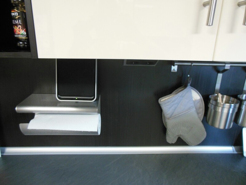

Here’s another idea you might consider... Instead of using any kind of panels, just take side panels that are normally attached to the carcass. These side panels are available, for example, in 220 x 60 cm (87 x 24 inches). If you mount them horizontally, you can cover a large wall area. Like I did here:
The side panels are only screwed to the wall at the top, and the wall cabinets slightly overlap them, covering the screw heads. It hardly gets cheaper, faster, or easier than that…
Best,
Micha
