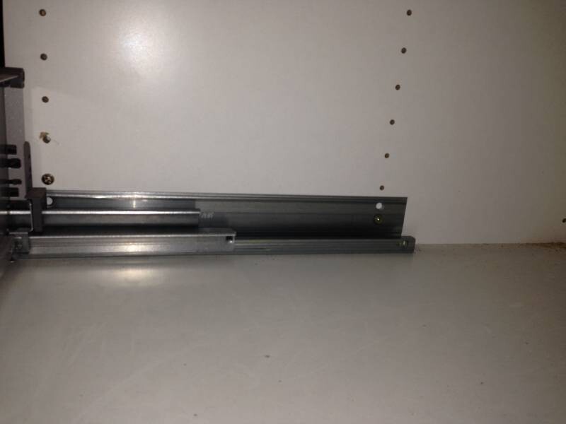

I want to retrofit soft-close dampers on the full-extension drawers of my Faktum Ikea kitchen.
For the sink cabinet, this worked without any issues. It came with those round dampers.
However, it’s different for the regular base cabinet with three drawers. Are there different systems for that?

IKEA-Experte9 Feb 2014 22:37You need to upload the image to your gallery. After that, a link will be displayed with the image, which you must copy and paste here.
I
IKEA-Experte9 Feb 2014 22:55You will need to replace the cabinet runners unless you enjoy creative metalwork involving sawing, filing, and drilling...
I
IKEA-Experte9 Feb 2014 23:35No, the rails were only extended starting in 2006 to allow mounting the dampers. You would basically have to make the extension yourself and screw it onto the cabinet in order to attach the dampers.
