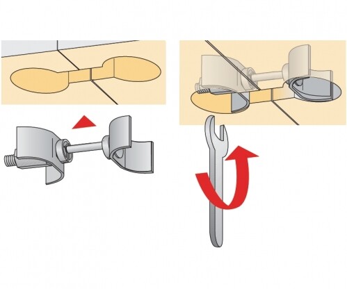

assamerer27 Oct 2013 10:17We also have an IKEA kitchen with a worktop joined together from DIY store panels.
For this, we used the following
and the panels are connected without glue or any other additives, keeping them water-tight.
Both panels require a large hole drilled from underneath as well as a supporting strip in both panels. With a drill and a bit of DIY skill, this should be doable on a Saturday.
