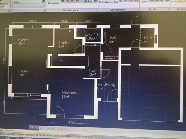

Here are a few initial observations I noticed at first glance:
- The ground floor feels quite compartmentalized to me.
- In my opinion, the utility room and technical room do not have enough usable space to be practical.
- I don’t really see room for a cloakroom that can accommodate a family of four.
- Whether you enter from the garage or the front door, you always have to carry your groceries quite a long way back to the pantry, which also offers little practical storage space.

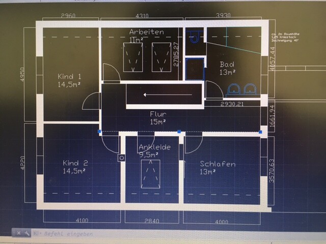

- Very long corridor on the upper floor.
- I would consider adding a door between the dressing room and bedroom, so if one person wants to sleep in longer, the other can get dressed without disturbing them.
- The toilet on the upper floor could become a very dark and uncomfortable corner being so separated.
These were just the things that stood out to me spontaneously.

Plot size: 548m² (5897 sq ft)
Slope: no
Floor area ratio (FAR)
Site coverage ratio
Edge development
Number of floors: 1.5
Roof type: gable roof
Architectural style: modern
Orientation: south-facing with a slight deviation to the east
Maximum heights / limits
Additional requirements
Owners’ requirements
Number of occupants: 2-4
Office: teacher with home office?
Guest bedrooms per year: rarely
Open or closed architecture: partly open, partly closed
Dining and cooking area, kitchen with counter and cupboard in the niche next to the pantry
Number of dining seats: 8-10
Fireplace: yes, masonry
Music/stereo wall: TV to be wall-mounted, with only a small sideboard underneath
Balcony, roof terrace: terrace partly covered by the upper floor
Garage: double garage
Utility garden, greenhouse: no large format specified
Additional wishes / special features / daily routine: bedroom not adjacent to children’s room, bathroom and toilet near the technical room
Designed by: architect and us
What is particularly liked: separable dining-living area
What is disliked: ???
So... I hope these are the most important details; the documents can be opened by clicking the image on my side

Well, the most important thing is actually the site plan and orientation, why the design is the way it is now, and whether the house is intended for a traditional family or possibly other household types.
Always remember: the more vague the information or question, the less meaningful the answer will be 😉
At first and second glance, I find it quite good, except for the trip hazard of the first stair step and the vestibule 🙂
Sorry, I missed this above... here is the site plan.
Why do you think the wardrobe is too small? There are intentionally two niches in the entrance area for two sliding door closets measuring 2 m (6.5 ft) each, so that should be enough?! I hope this information also clears up the cramped impression...
The very long corridor upstairs actually came about because we wanted direct natural light...
There will be a sliding door between the dressing room and the bedroom.
The toilet could really turn out too dark...
What do you mean by tripping hazard, and what don’t you like about the entrance area?
At first and second glance, I think it’s pretty good, except for the tripping hazard at the first stair step and the entrance area 🙂
