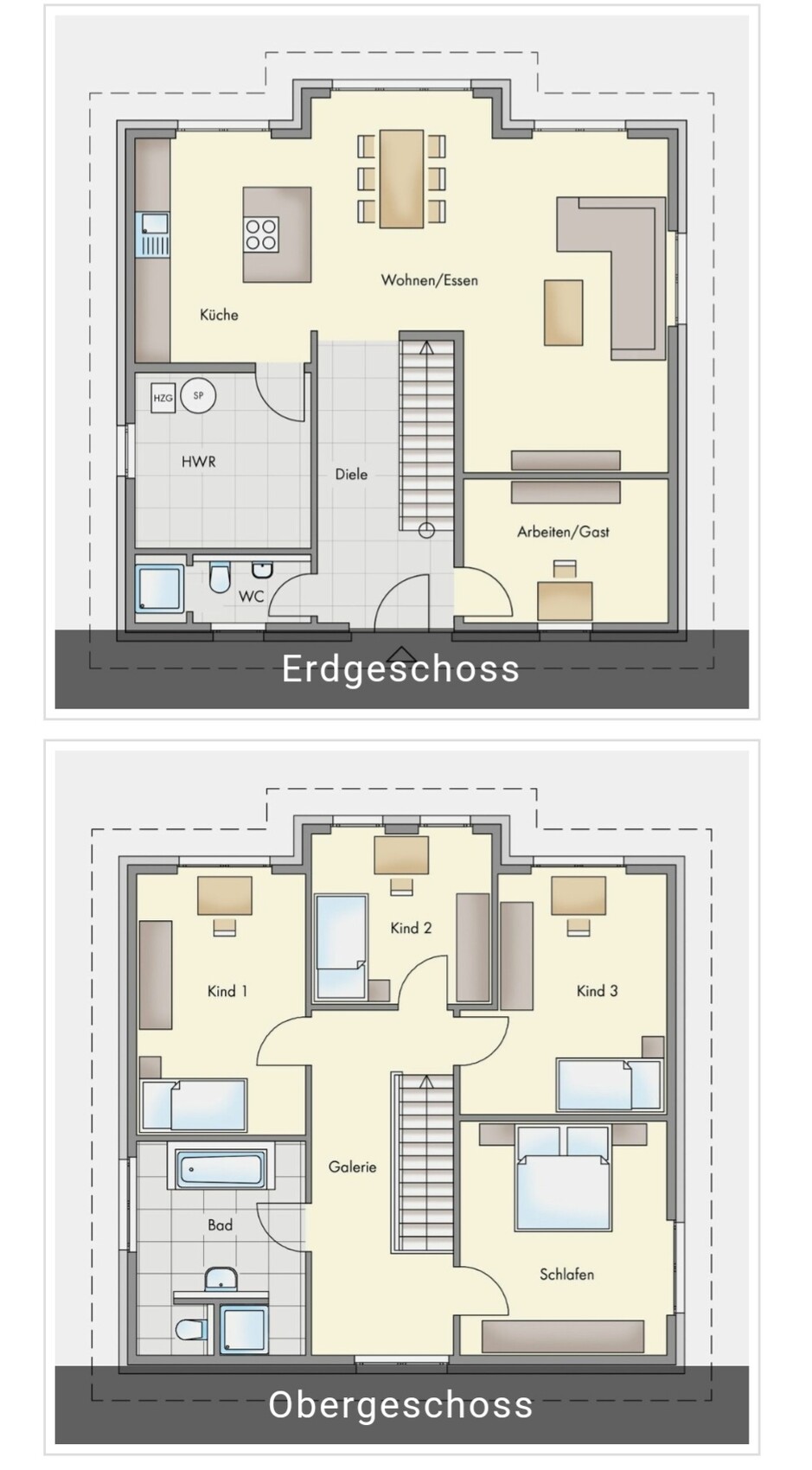

we are planning to build and before consulting an architect, we would like to get your objective opinions on the floor plans we have posted. We really like this layout for the ground floor and upper floor and would like the architect to design something similar.
Please excuse the very simplified sketches; I’m not comfortable using these floor plan software programs, but I hope it’s understandable enough.

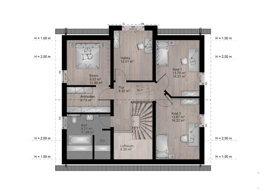

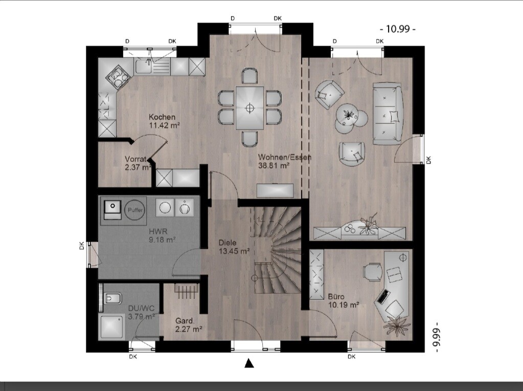

Notes on ground floor: Please disregard the pantry; the staircase should start straight and turn left at the top or simply be completely straight.
Notes on upper floor: We would like a walk-in closet attached to the bedroom with a connection to the bathroom. I have roughly marked this as we would like it, with the furniture in green. The T-shaped fixture in the bathroom should be rotated.
The main focus is on the room layout itself and whether there is enough storage space. Of course, the architect will need to adjust things, for example to align the stairs between ground and upper floor. The house should be about 170 square meters (1,830 square feet) and have a gable roof with a dormer. I have roughly indicated the approximate 2-meter (6.5 feet) height line in purple in a very basic way.

Floor plan of a house with three children’s rooms, bedroom, bathroom, gallery, and staircase.
Floor plan of a house with kitchen, living/dining, office, hallway, utility room, cloakroom, shower/toilet.

The staircase from the upper floor is also somewhat longer... Here are the complete floor plans for both levels:
Floor plan upper floor: master bedroom, two children's rooms, bathroom, dressing room, hallway, hobby room, staircase
Floor plan of a house: kitchen, living/dining, office, entrance area, utility room, cloakroom, shower/WC.
Two-story floor plan: ground floor with living/dining; upper floor with bathroom, bedrooms, children 1–3.
11ant3 Aug 2023 13:50
Herr_Nord-DE_ schrieb:
Please forgive me for the very simplified sketch, but I really can’t get along with these floor plan software programs, and I hope it’s at least somewhat understandable. [...] I roughly indicated the approximate 2m (6.5 feet) line in purple in a non-professional way.
From me, you’ll get not only an apology but also the warmest applause for sparing us the “architect apprentice sorcerer’s” treatises. Unfortunately, you only partially understood one essential point of “your” upper floor donor design yourself, shown in a rough purple mark, namely that you want to rebuild a substitution villa upper floor as a gable roof attic—so with a knee wall height of 140cm (55 inches) instead of 260cm (102 inches). The closet by the eaves side in the dressing room will then turn into a higher chest of drawers. Otherwise, I praise your composition and the adaptation ideas again—the basic approach has largely succeeded.
However, the fundamental procedure is not recommended. Having an architect “deburr” a layman’s self-performance design (even if, as you said, you cleverly assembled modules at least in principle) is generally not a good idea. The portion of the architect’s fee for drawing the floor plan is mostly symbolic, so self-performance (whether creatively or cleverly borrowed and varied) is almost economically pointless.
And you will need a real architect—meaning not just a plan submitter from a construction company. Unfortunately, you must not assume more freedom in your planning from “no development plan”—in some cases, even quite the opposite applies. Personally, I prefer the legal certainty of a difficult and hard-to-interpret development plan over the discretionary scope in the interpretation of a fitting-in requirement. Builders go to court over development plans when the “fault” lies with themselves (i.e., they want to ignore rules that apply to everyone and subjectively consider them excessive), and in §34 zoning areas more often when the building authority arbitrarily exceeds the interpretation of the fitting-in requirement. The frequency of legal clarification is roughly the same.
Oh, one compliment I almost forgot: for the abandoned chimney. It’s a relic from pre-energy-saving regulation houses.
Herr_Nord-DE_
3 Aug 2023 13:53
So, we want to build with an architect. And we would be fine with either staircase option, whether straight or spiral going up. That’s why I didn’t adjust the floor plan on the upper floor. We like the layouts I posted visually best as they are. I already mentioned that the staircases don’t fit exactly as shown. It’s then the architect’s job to integrate and adapt them accordingly.
Unfortunately, we don’t like the upper floor layout from Econ. And the other upper floor plan lacks the walk-in closet, which we would like to have in the indicated position. Please disregard the staircase situation for now; what do you think of the overall floor plans? Also, do you think 7 m² (75 sq ft) is enough for a utility room?
