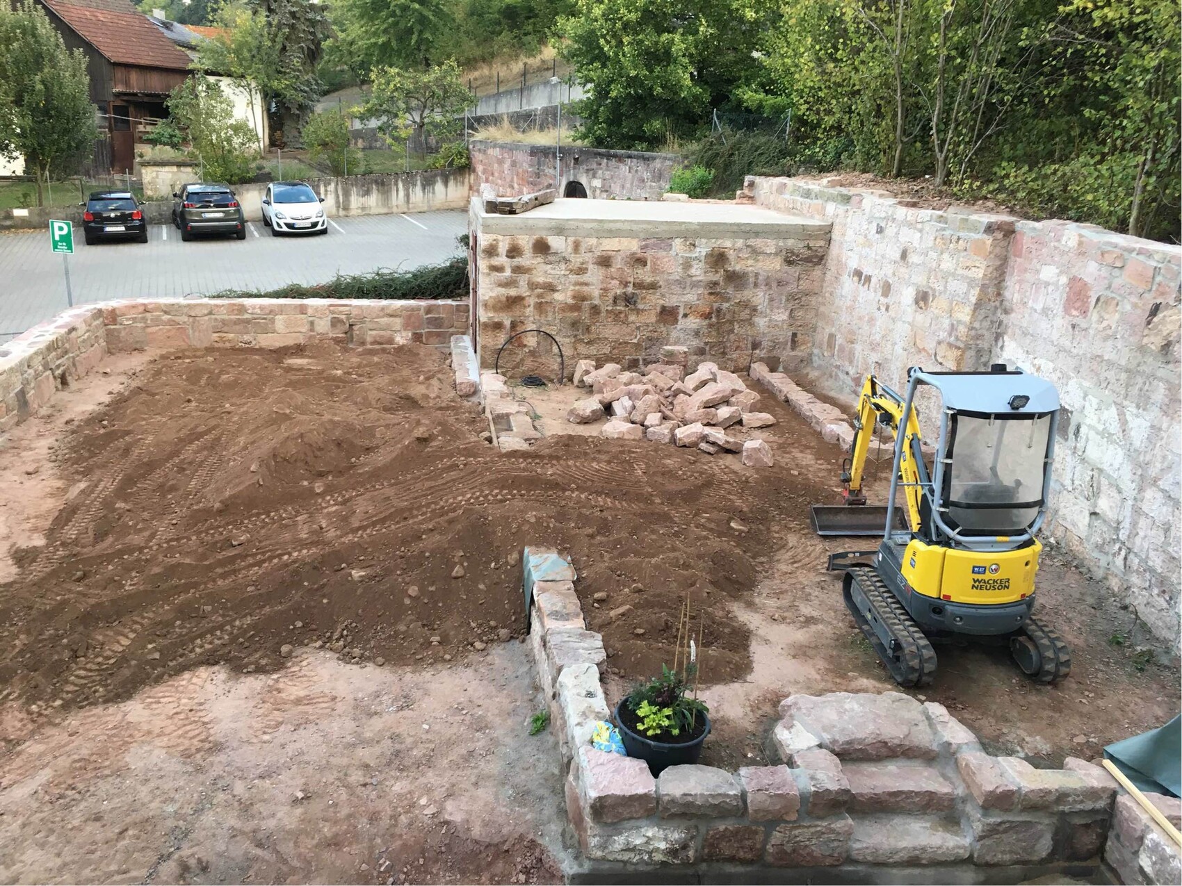

Greetings from Upper AustriaFor Haydee and others interested, I’m revisiting the garden wall solution using concrete railway sleepers.
In the next few days, I will post a picture showing how it looks after one year of planting, now in autumn.
Curious to see how it will look once it’s fully grown in.
We kept the old walls in place.
Part 1 is visible in the photo (it's the flatter one).
Part 2 is supported by the house.
Part 3 reinforces the old wall with a new retaining wall at the lower section. Altogether, it’s only a 5-meter (16-foot) high retaining wall for a 13-meter (43-foot) height difference.
Part 3 is too steep, so over the next few years, we’ll plant ground cover there and leave it at that.
For part 2, we want to make it look nicer with a staircase, a small terrace, and plants. I plan to plant the vegetation in terraced beds.

Otus11 schrieb:
Embedding H-beams in concrete and installing precast concrete elements might be a solution.
I believe that's also how the railway does it.Not if you have to carry that stuff by hand up a staircase.
The flower beds don’t have to start on the slope. The rock is stable.
