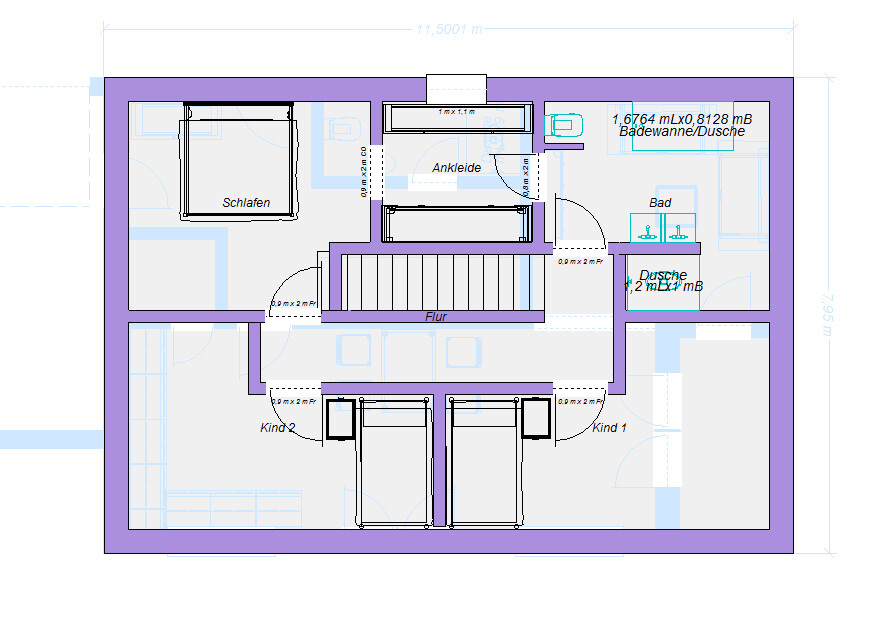

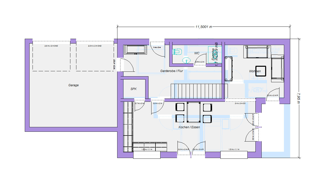

Hi everyone,
we have a floor plan of our house here. We are facing some issues with the bathroom on the upper floor: we want to incorporate the popular T-shaped bathroom layout, but because of the L-shaped room design, it seems difficult to impossible to include it.
Also, the garage is planned to be built attached to the house wall on the ground floor, but this would mainly cover the window of the small bathroom (the window covered in the living room area wouldn’t be a problem; we would simply do without it).
Do you have any ideas on how to improve the layout? We understand that a straight staircase takes up a lot of space, but having a straight staircase is a requirement we really want to keep.

The bathroom issue could be solved quite easily, right? Move the entrance down to where the bathroom currently is, and place the toilet upstairs where the entrance/wardrobe is now—done?
Or simply move the garage 2 meters (6.5 feet) forward to keep the window?

Straight staircase and basement – that’s your main issue. I’m not sure how adventurous you are. But try searching for images of SH 127 S + 50 from Scanhaus Marlow Marlow. The floor plans are now only available on Google. Would something like that be possible? Then you could consider this direction. The utility room would need to be a bit larger and serve as an office.
