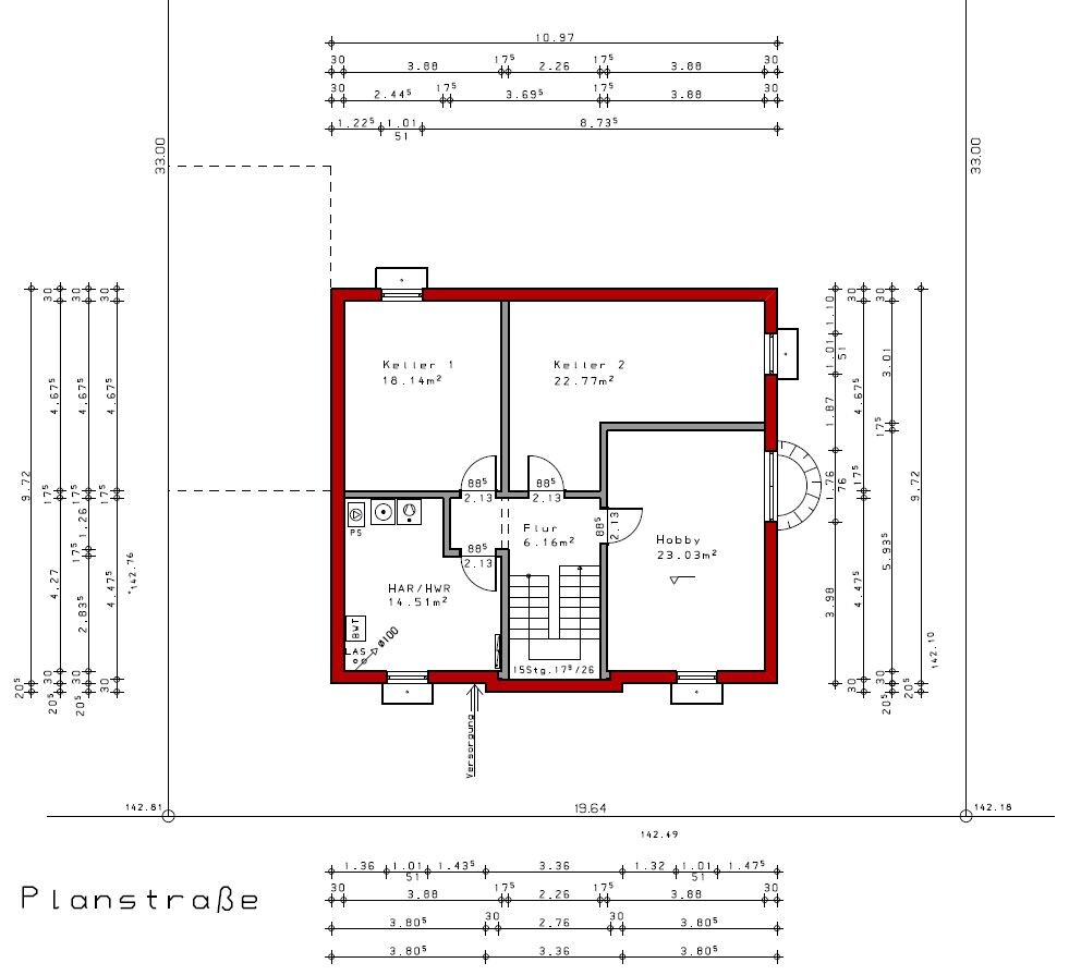

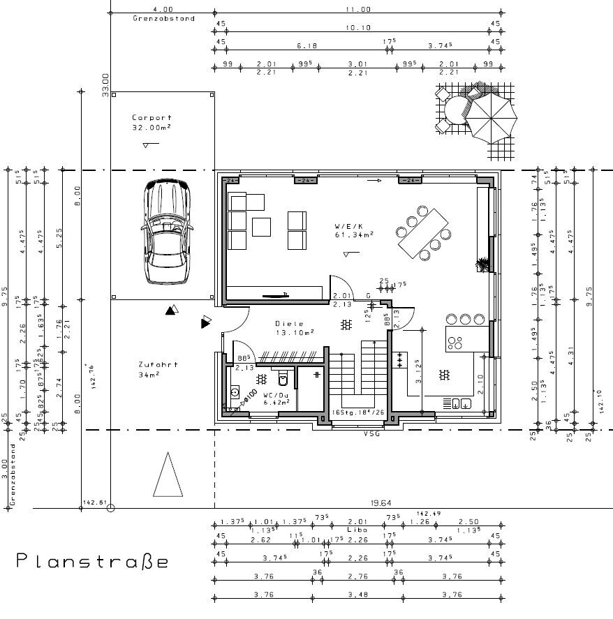

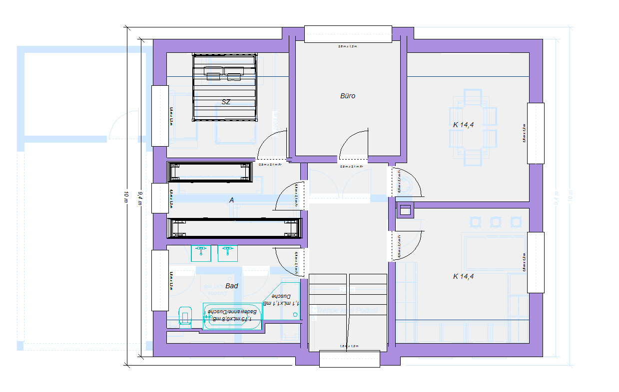

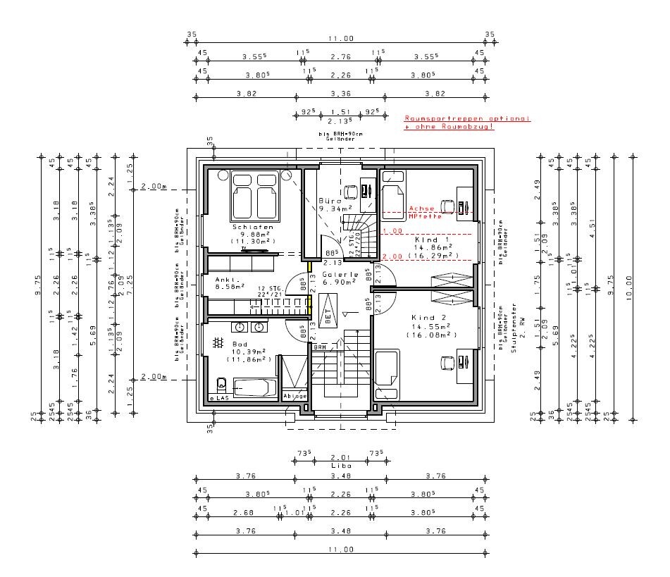

We really like the upper floor. Room sizes fit well. We can’t really assess the master bedroom on the south side yet. The kids’ rooms seem the right size and have a good layout in my opinion.
A guest room was not a requirement – apparently there was space on the upper floor. We are not unhappy about that.
The living-dining area really appeals to me. Kitchen opening to the terrace. My wife likes the pantry options with access to the garden, basement, and carport.
What don’t you like? Why?
What we don’t like is the narrow corridors. I imagine 1.2m (4 feet) and 1m (3 feet) very cramped. Between the carport and along the stairs, this wouldn’t bother me so much, but the entrance definitely should be wider.
The master bedroom on the south side does not convince me much.

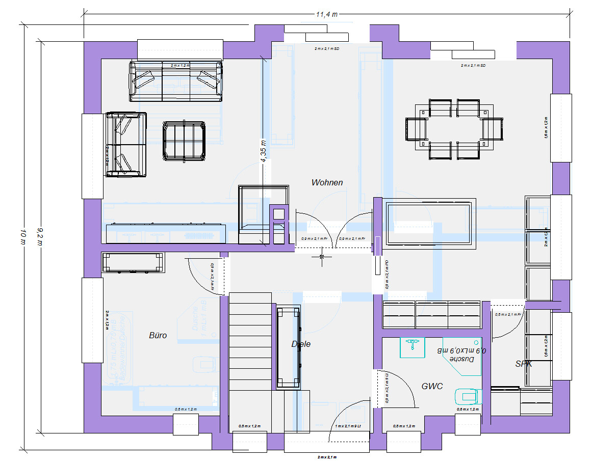

kaho674 schrieb:
A standard version with, in my opinion, optimal space utilization, ...I also like it very much. I would probably try to add a bit more depth to the living room at the expense of the now very large office.
ltenzer schrieb:
I really like it too. I would probably try to give the living room a bit more depth at the expense of the currently very large office.That was exactly my thought as well, and of course, I have already prepared something:Two more views:
I was quite proud that I managed to position the chimney perfectly over the hallway—both on the ground floor and the upper floor. But then it went right through the ridge. What a bummer! Of course, we can't just cut it. So it has to stay as it is, or we'll have to do without it entirely and buy an aquarium, piano, or minibar instead.
kaho674 schrieb:
Liquor bar.Always important! Also as an alternative currency in case of an apocalypse!
kaho674 schrieb:
[ATTACH alt="WZ-Tiefe 435.jpg"]41799[/ATTACH]Really cool! Thanks!!!! We discussed all the floor plans again over the weekend with the family. We now agree that the original design from the general contractor has significant flaws.
However, with your design, we still have the issue that one of the best corners in terms of natural light is occupied by the pantry and WC. That is the southwest corner of the house.
kaho674 schrieb:

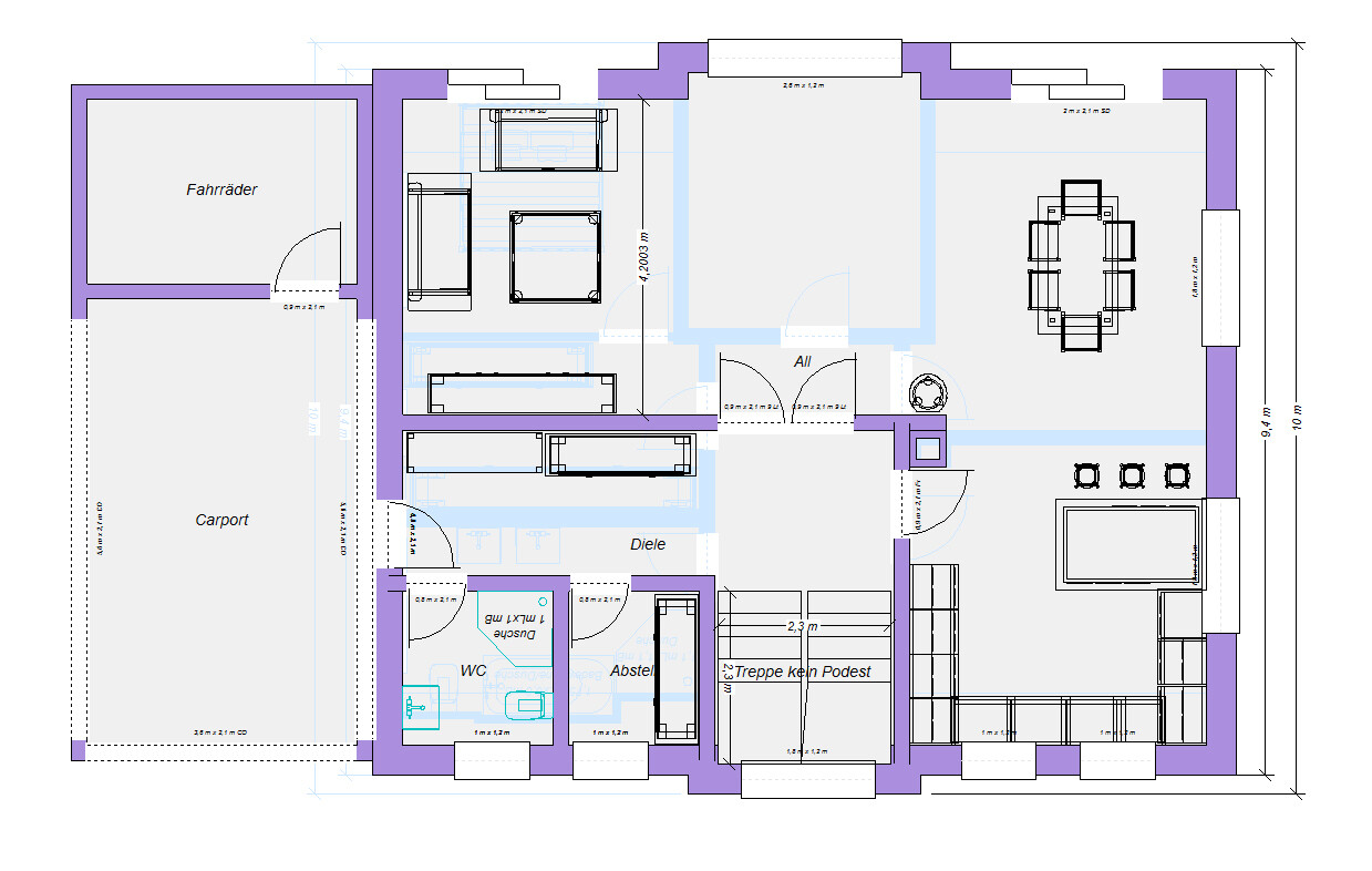

[ATTACH alt="Ostgarten-EG.jpg"]41789[/ATTACH]I find this solution much better. However, my wife is against placing the office facing the garden. The argument is again the "show side of the house." Although with this design, I would even consider widening the WC and moving the main entrance entirely to the north side.
At the moment, we are seriously considering moving the office to the upper floor. The general contractor’s design managed that well, and it would of course open up entirely different possibilities on the ground floor and greatly ease the "unfavorable" location of the plot and the building envelope.
I’ve been thinking for a long time about what task I should give the general contractor for the next meeting.
What’s clear:
Ground floor must be redone.
An entrance, preferably from the north side.
Kitchen at least 3.5m (11.5 feet) wide.
Living-dining area along the entire east side.
Uncertain:
Kitchen on the southwest side
Office on the upper floor
How large should an office be at minimum for it to work including large shelving units? Another topic is the possibility of retrofitting stairs for an attic conversion. The general contractor said that for the straight staircase, you could simply add a third steel staircase for attic access. For that to work, the stairs must be built fairly central near the ridge, right? Like in the design above by @kaho674, that wouldn’t work in the bay window, would it?
This whole planning process is really exhausting! I naïvely thought that only the actual construction with constant on-site supervision would be stressful. But the fear of making mistakes is also no joke....
Fortunately, it’s great to have so much help here!
These are decisions that no one can make for you.
What is more important? Afternoon sun in the living room or a wide opening of the house towards the garden. For me, it would clearly be the latter, as long as there is enough daylight in the rooms during the day. In summer, life happens about 90% on the terrace or in the garden. It’s a completely different experience when all the main rooms open out there.
Expanding the attic peak, I think, is nonsense. Who actually installs a staircase afterwards just to gain how many square meters? 10? What knee wall height are you planning now?
I don’t understand why the pantry would have more right than the office to be located next to the garden. I would strongly advise against using the valuable rooms in the house as storage for garden tools or similar. For that, you have cheap wooden sheds. Or is there another reason?
Office size – if it’s well planned, about 8 to 9m² (85 to 97 sq ft) is enough. Include realistic furniture in the plans and then you’ll know.
The knee wall is 1.25m (4 feet) high. This means there is plenty of space in the attic. Although it doesn’t meet the DIN standard, it should be sufficient for teenagers. At my parents' house, we finished the space later on, and despite the 2m (6.5 feet) height with a width of only 1.5m (5 feet), I often used the room.
The pantry facing the garden has already been ruled out in my planning.
