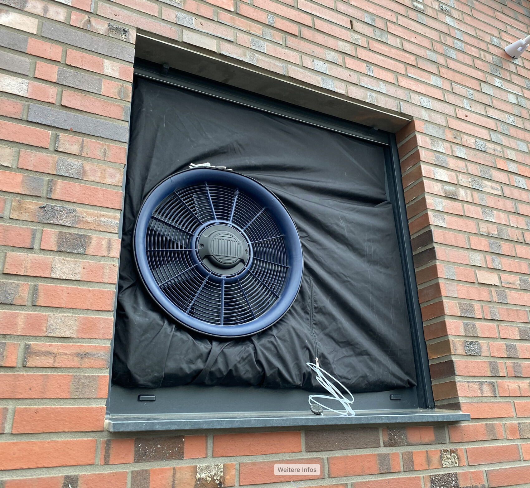

The blower door test was just done. Or rather, in our case, a blower window test. 😉
The result is 0.61. The energy consultant was satisfied. There were still some leaks in a few spots, which will be fixed now. But the general contractor did a great job.
